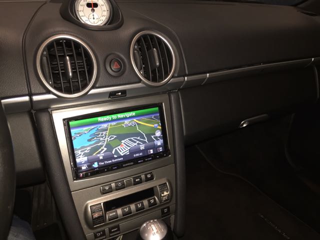

I have a kenwood in my Cayman. I just grounded the wire that was supposed to go to the parking brake.
Best thing i did was replace the radios in both my Cayenne and Cayman.
