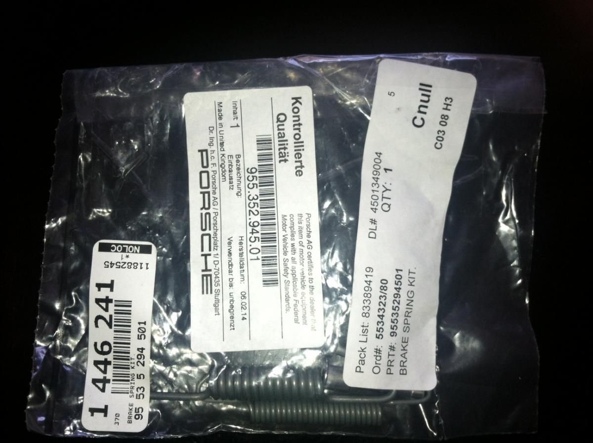

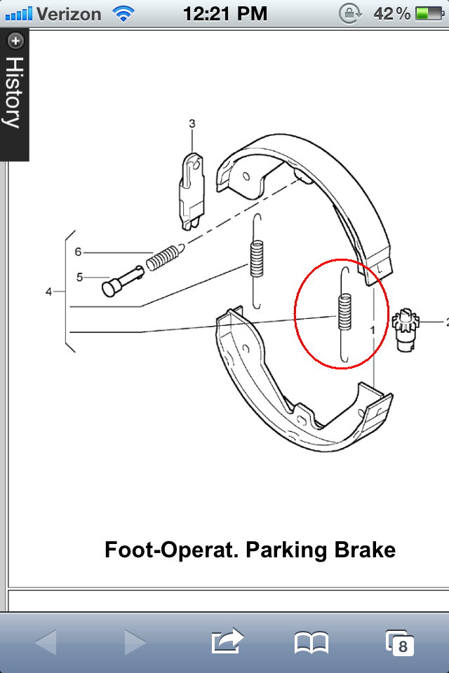

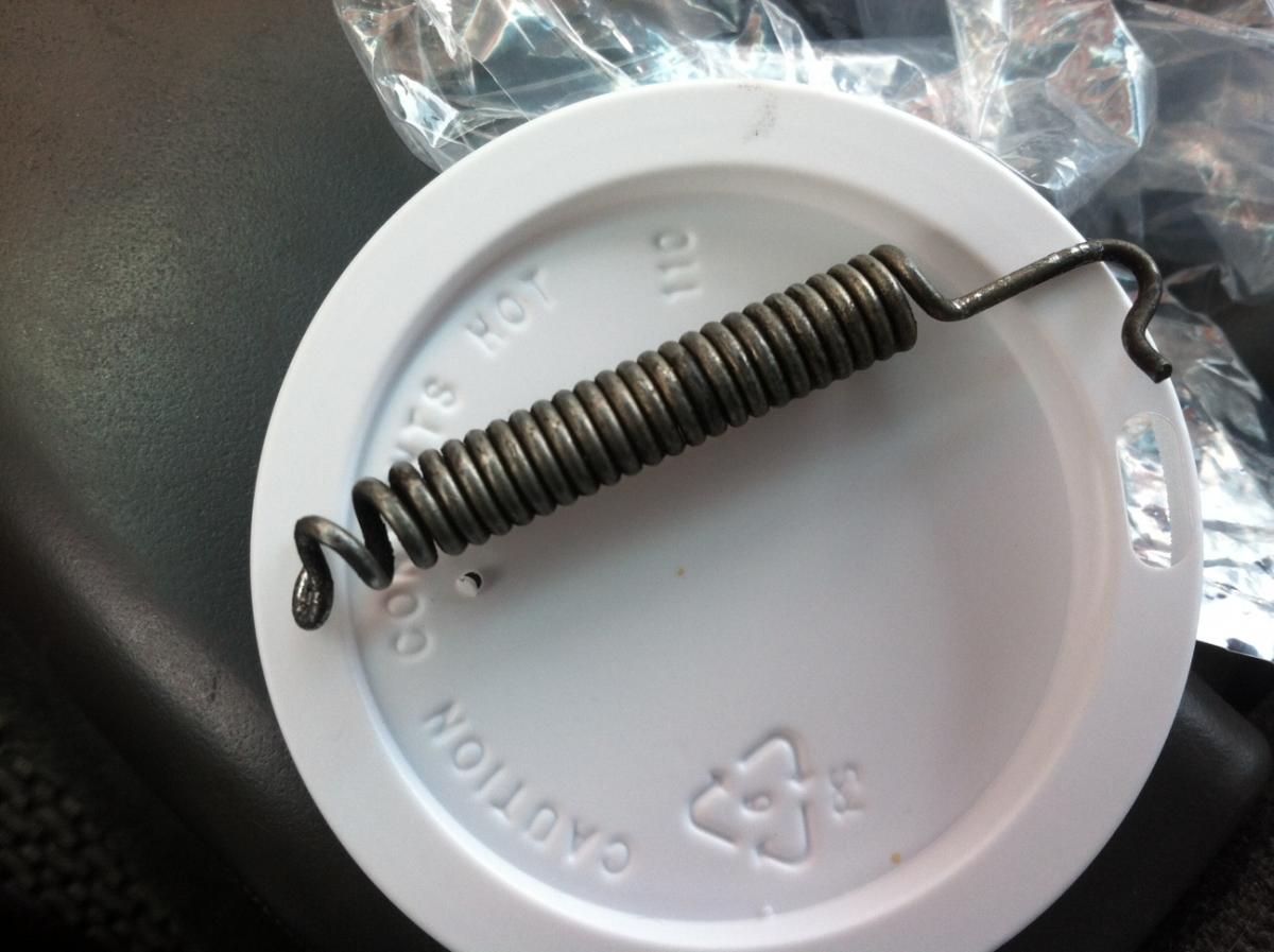

You might have a broken spring. I found mine hanging loose from the top hook, behind the rotor, with the bottom part shattered. They come in a kit, and I believe they're the same that vw, audi and even bmw sells. Takes a bit of effort to get it stretched so that it hooks properly at both ends, but it's doable with a pair of fine nosed pliers. Wear safety goggles, lots of tension on that little spring.

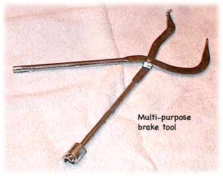

What you need is a cheap brake tool that makes removing or reinstalling drum brake springs a snap:
Multi-Purpose.jpg  Less than $10 on Amazon : http://www.amazon.com/OTC-4590-Brake-Spring-Plier/dp/B00063V40G/ref=sr_1_1?ie=UTF8&qid=1424553458&sr=8-1&keywords=drum+brake+tool
Right on, JFP, really useful little tool. I actually bought one, well afterwards :), and tried it on a spring, makes the job way easier
And what is really neat about this cheap tool is that it will work on any drum brake system, regardless of manufacture.
