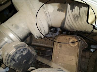

Hey everyone. I am not looking for an over the computer total solution, but I was wondering if some of these pictures I post may stick out to explain some oil leaking issues I am experiencing.
I have a 2001 Boxster.  After squeezing under the car it looks like the area where the oil drain plug is located, as well as the entire drivers side (the side that has the filter housing) is dry. I gained access to the engine compartment and took these pictures where I could see oil leaking down. Please look at each and tell me what you think. I have read about a couple of these parts cracking etc..
Any insight you can give before I take it to the repair shop would be helpful. Thanks.

1) Number "1" is a thick hose that  connects to the intake? It has oil leaking from underneath it quite a bit

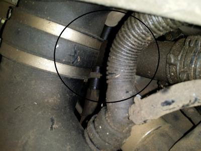

2) "2" is very hard to show. It is underneath the arrow. It is a hard line, feels like metal, and it looks like a lot of oil is coming from it. It is mounted directing on top of the engine below the intake connector.

To also go along with the number "2", if you look at the back of this picture where the hydraulic reservoir cap is.  Just down and to the right of that cap there is oil leaking. From that area and the area I described in # 2, there is quite a bit of oil sitting on the top of the engine.

It seems that the engine is "sweating" this is not uncommon, it occurs after many years of use. I would suggest to clean the engine properly in first place, this not only makes it easier to detect the leak it is much cleaner to work on it also. Two advantages in one move.

Adam,
As RFM suggested a good cleaning will aid on many fronts. You or your mechanic, or anyone else for that matter, will have a hard time identifying the several leaks as the air turbulence will deposit a mist throughout the engine bay, making it difficult to trace its origin. Gravity also plays a role in spreading any escaping oil. A good engine degreaser applied from the top to a warm engine and a hose down should clean things up quite a bit. An air gun / compressed air is needed to get moisture (including dissolved oil) out of the crevices on top of the block. A second cleaning / drying may be needed after the first round to get is squeaky clean so you can start you quest for elusive oil leaks. A short, hard run should get the oil weeping and allow you to identify the leaks. Good luck.
