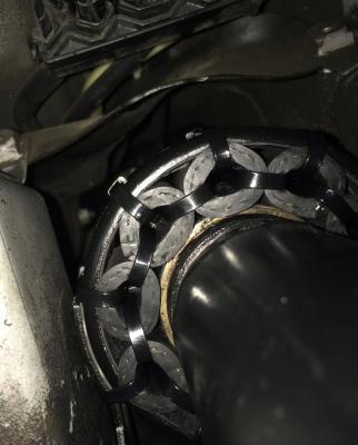

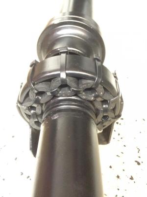

I just got a new shaft, installed it today, same thing as you, now it slightly hums/whirring noise from 30 mph on up… So, I put the old shaft back in with my "Temp Fix" and hum is gone.
Trying to work out if its the New Shaft is bad or if its the center bearing not centered true...
The New Shaft runs smooth and there is no vibration, just the humming/whirring sound… Annoying..
Unfortunately, this tool is both pricey and very specific.  Usually, you would only find one in a shop.  If you cannot find one selling used, check with shops in your area that work on these vehicles; they can probably do a quick shaft alignment for you at a reasonable price.
