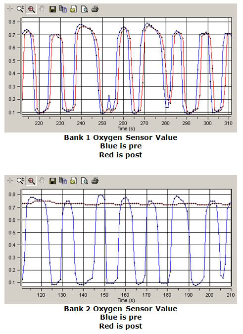

You need to go back to your Durametric system and pull up the graphical display of the before and after cat voltages to see if they are following each other; if they are, you need new cats.

Positive, it should be in the actual values under the engine sections.  These curves were generated off a 996 with a bad cat on one side using the Durametric software:
