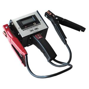

You need a system load tester to do this:
Can I just take the alternator to a auto zone? Same thing?
No. a load test for the alternator is a dynamic process; with the car running, the system ramps up an electrical load on the system as shows how it responds.  AutoZone testing is more for "it works or it doesn't work", like a light bulb.
