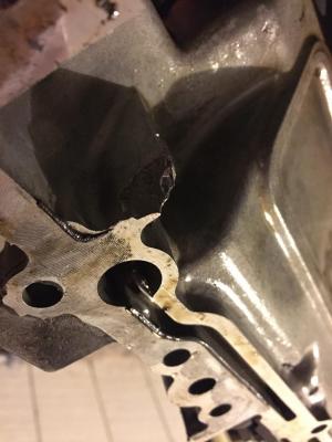

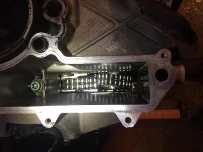

Hey all,
Separated the engine halves tonight after many hours of tediously removing auxilary components and labeling. I hope I've been organized enough to get it back together correctly! Damage so far is 8 bent valves on cyl 1-3, broken timing chain, and gouged chain rail. Cylinders look good, thank goodness.
The timing chain for cylinders 1-3 was broken and wedged tightly between the IMS sprocket and the case. Only after the engine was separated was I able to knock it loose. I noticed that as I turned the crankshaft, the sprockets connected to the cam chains did not turn. I assume this means my IMS has been destroyed because the sprockets are freewheeling? Or is there some attachment point for the large sprocket?
Questions:
  • Is my intermediate shaft destroyed? Or is there normally a shear pin or something else holding the sprocket from turning on the shaft?
  • If my shaft is bad, does anyone know the correct p/n for a 3.6L engine? eBay has some intermediate shafts available for ~$400 but they're from 2.5L engines. Pelican sells new shafts (p/n 996-105-901-06) for $1400, ouch.
  • Can I use a regular ring compressor to get the pistons back into the cylinders? Can anyone shed light on the procedure? Seems tough since there's not much access...
  • I bought the $800 LN Engineering IMS bearing kit. Do I still need the LN Engineering tool kit ($350) since I'm splitting the case and already have lots of access?
  • Is there a tensioner for the crank-to-IMS chain? I couldn't find one.
I assume the next steps will be to loosen the tensioner for the cylinder 4-6 cam chain and remove the IMS. Engine is currently at TDC so I shouldn't have any issues with valves moving around.
IMS to crank chain tensioner is quite obvious, see the links in this msg. But you already split your cases so you are probably talking of something else?

Hey Domiac, you're absolutely right. It was easy to spot. Guess I was working too late into the night!

The IMS shaft chain sprocket is pressed on, and have actually been known to slip on the shaft.  I would have someone with experience check your shaft and sprocket to see if they can still be used, and if they can, I would highly recommend having the sprocket pinned to the shaft to prevent it from ever moving unintentionally.
A replacement shaft is going to be an issue.  You will need to find a serviceable used one and get it pinned as discussed above.  Replacement shafts from Porsche are all going to be the non serviceable over sized third design IMS bearing, and would include the bearing, which is why they are so expensive.

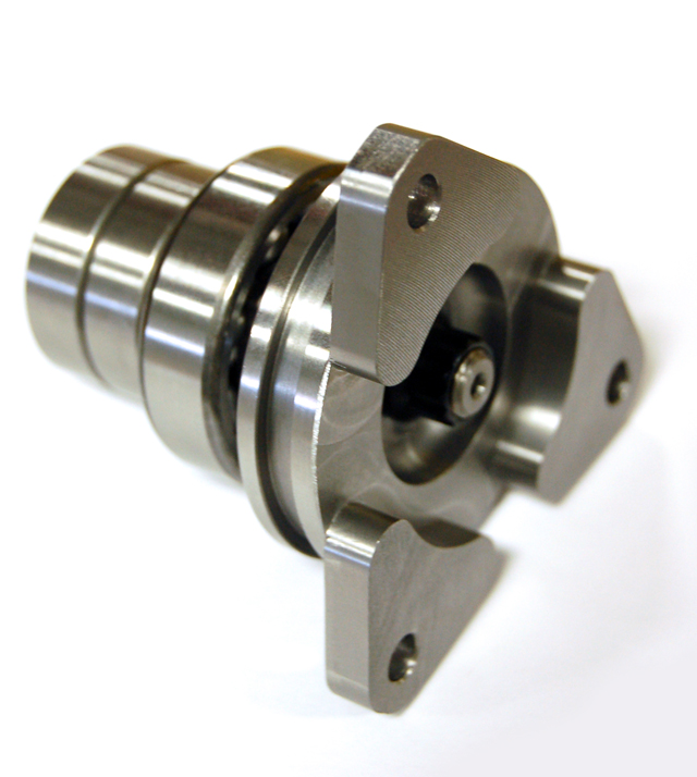

I spoke with LN Engineering this morning and they took care of me. Unfortunately because my sprocket has already spun my IMS cannot be repaired. However, LN has reconditioned IMS's in stock and it will arrive already pinned and with the upgraded bearing installed for $1600.
As I was already planning on spending $1150 ($800+$350) for the bearing upgrade, this isn't terrible.
Let me guess, this is one of their "triple" row IMS units, which are truly a beautiful thing.
Indeed, this will be the "latest and greatest" new IMS bearing from LN!

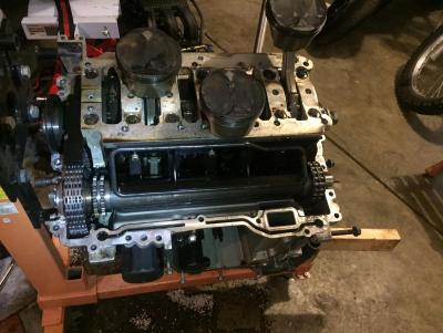

Guys, looking at the engine this morning I'm not sure I'll be able to remove the IMS without also removing the 2nd cylinder head. Does anyone know whether it's possible to loosen the crank-to-IMS chain and far-side timing chain enough to remove the IMS? I've attached a photo of the engine up to now.
With the crank at TDC, if you remove the  four chain tensioners, the chain on the IMS should easily go slack enough to be removed.
John, when you said triple row, are you referring to the gear/sprocket on the flywheel side of the IMS? Or are you referring to some new design of the LN bearing?
It is the IMS bearing.  While not new, LN developed a super strong triple row version of their ceramic hybrid, which requires a special replacement shaft with pinned sprockets.  This is used only on disassembled engines as it is an entire shaft assembly with the bearing already installed, and requires splitting the cases to install.  Very few people have even seen this unit, but it is a work of art.  From their website:
"LN Engineering also offers an IMS Upgrade service where you send in your intermediate shaft and it is upgraded to a triple row bearing (with exception of MY06-08). Additionally, the main drive sprocket is pinned to prevent slippage of the drive gear, which is a known problem area."
