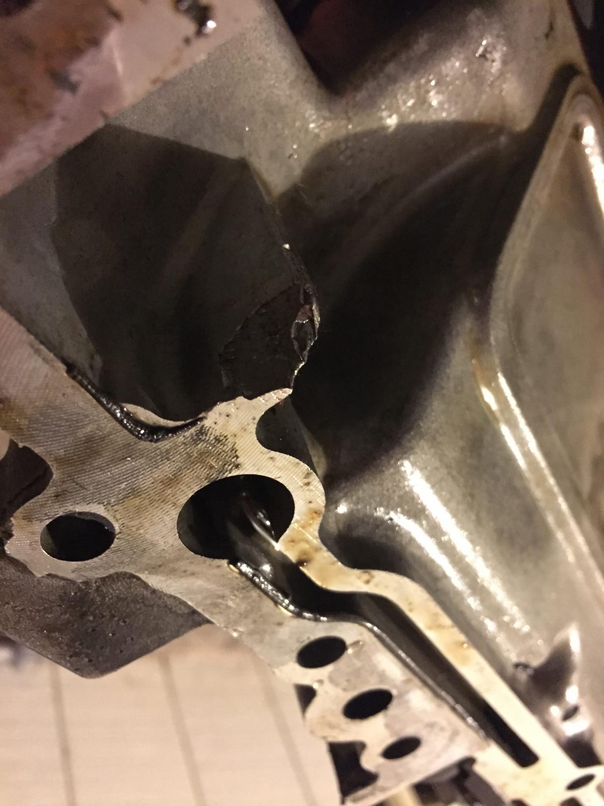

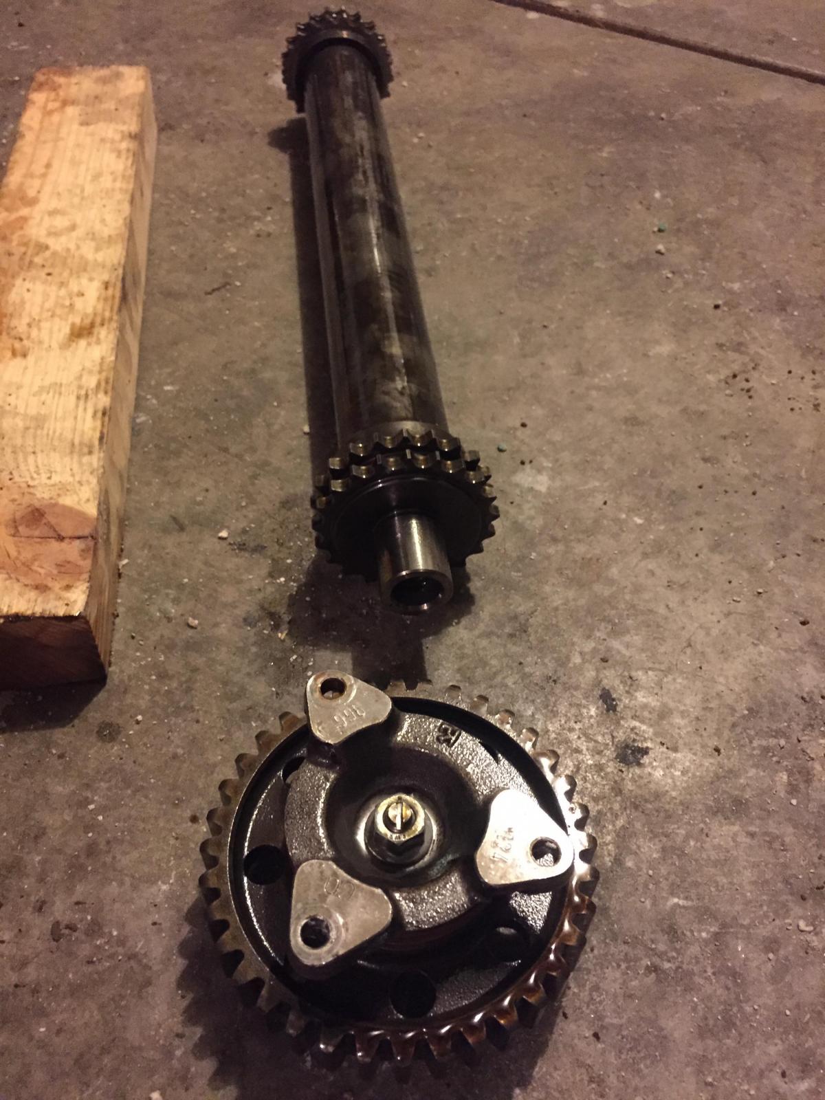

At this point the engine is fully disassembled. The IMS shaft completely separated on mine -- the interference fit between shaft and crank sprocket became so loose, they don't hold together whatsoever. This weekend I'll get to cleaning: cylinder head and pistons, primarily. Also need to replace the bent valves with fresh ones.
Currently the repair bill is around $3200. Honestly I'm shocked it's possible to spend this much in parts. The majority of that cost was to LN Engineering for a new shaft with bearing. The photos show the failed IMS, a chunk of aluminum missing from the case (no biggie  :eek: ) and the crankshaft bearing block.
