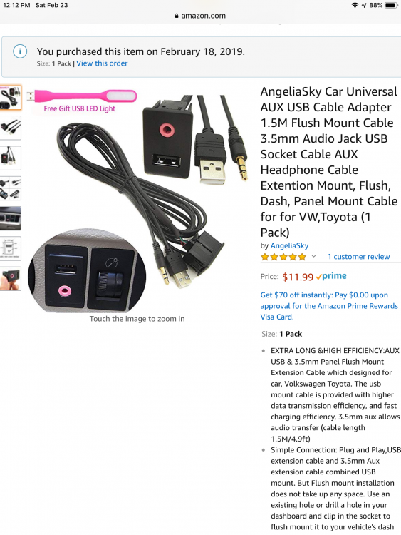

The USB AUX adapter from Amazon fits perfectly in an unused dash hole.
