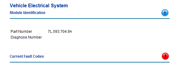

When I run a Durametric scan I get the red exclamation symbol under Vehicle Electrical System (part no. 7L.593.704.9A) , but no fault codes are present.
I'm going to give it another week and see if that clears by itself also.
Apart from that one strange event a week ago, the car has been operating flawlessly. A mystery indeed...

Loren - a 1 month update:
Car has been running perfectly.
I checked with Durametric again yesterday and there are no fault codes active.
the only thing that remains is what I said in post 12:
"red exclamation symbol under Vehicle Electrical System (part no. 7L.593.704.9A) , but no fault codes are present."
I'll run another scan in a couple of weeks and update the thread again.
The entire time I've had my Cayenne I get a phantom fault in the electrical system using my Durametric.  PIWIS does not show any faults.  I informed Durametric of this but they have yet to fix it.  I realize that you had a problem and so this fault could be legitimate, but just wanted you to know that this is an issue, at least with my 957S.
