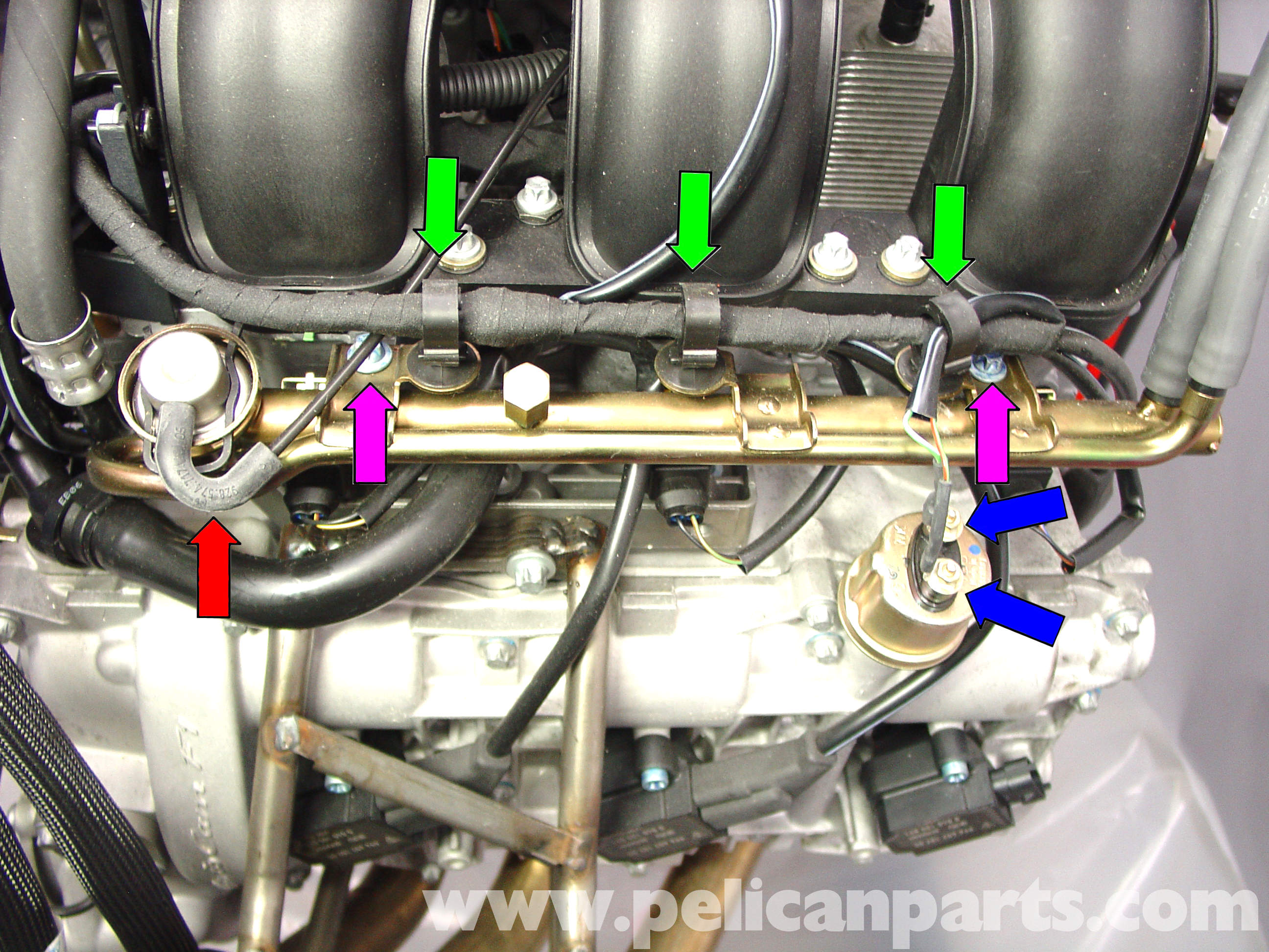

Some of the early cars had a fuel pressure regulator (red arrow on the left) on the fuel rail, which can be the source of the problem, or you could have one injector that is leaking down.
Luckily my car is a 996 not a 993. But I will keep that in mind. I noticed when you turn the key, the fuel pump does pulse momentarily. So this morning I turned the key on then off a couple times before starting. The car started normally. So my guess is that the fuel pressure is bleeding off. Now to check to see if it is the fuel pump or the regulator.
