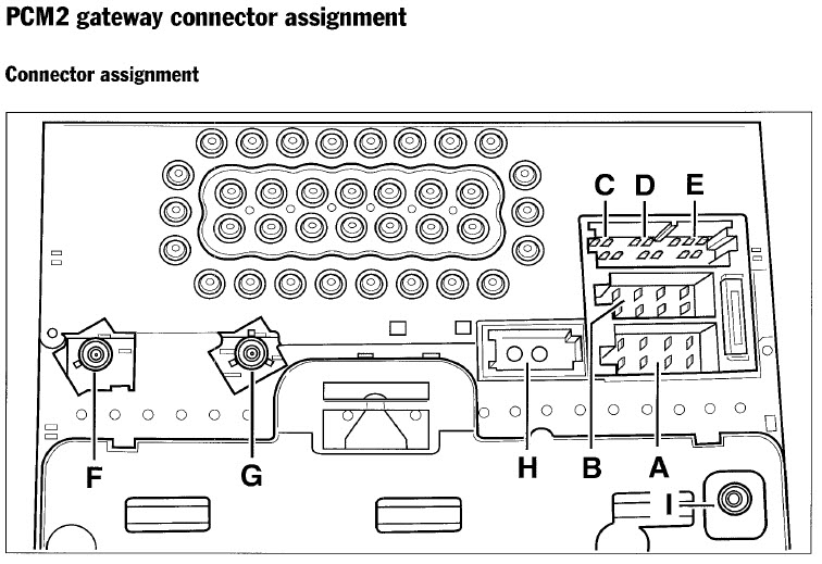

I have a broken PCM 2.1 in my turbo (2005)which i need to give to repair.
In the meantime i install the old PCM 2 from my cayenne s into the turbo.
The connections seam almost the same. Except this unit has a additional blue fakra GPS / SAT plug.
Radio working.
CD working
Navi is starting but it cant find my current location. No GPS Signal!?
I bought a GPS Antenna from ebay. Connect it with the blue connection at the backside if the unit but still no signal. Can somebody help please. Thank you
