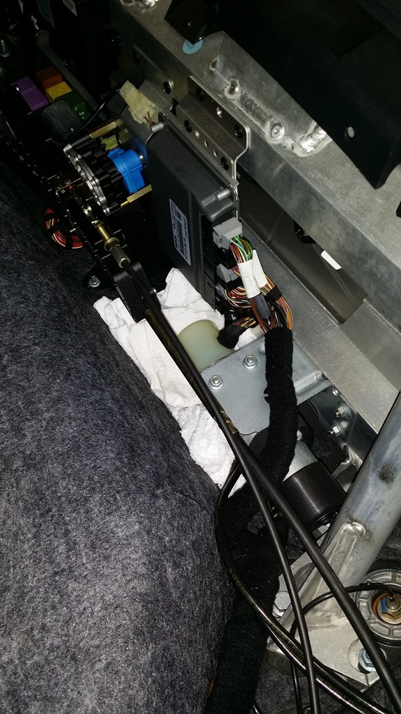

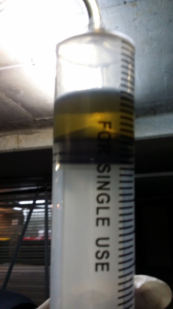

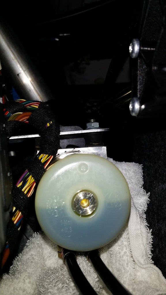

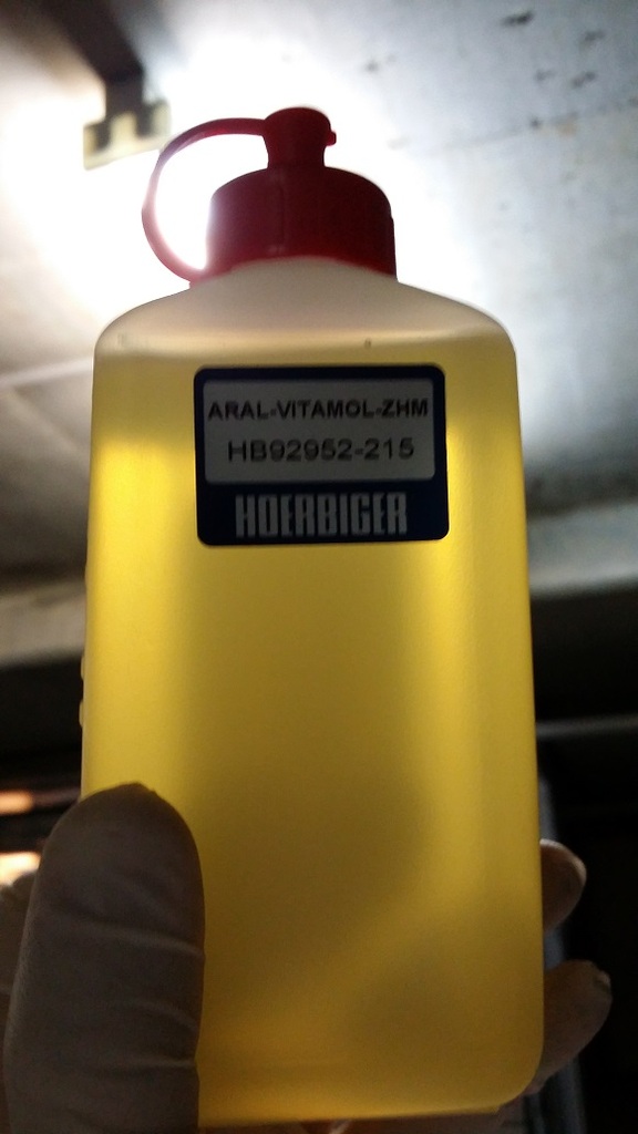

And re the cabriolet fluid, it's slightly different than the 996, for anyone that's interested here is a pic of the reservoir. I siphoned out 90% of the fluid from the reservoir, then filled with new fluid, then put the top up and down a few times, then repeated again. Pics below showing old fluid colour and new fluid in bottle.

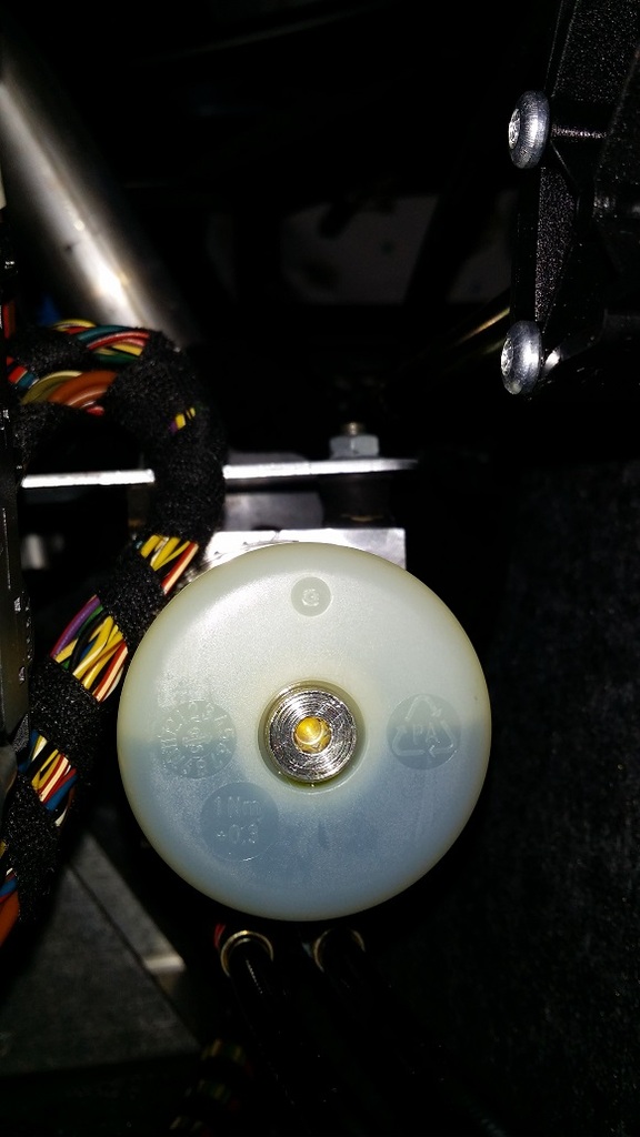

I noted the level of the fluid inside the reservoir before I started and couldn't quite get it back to the same level as the fluid sits level with the screw and spills out at a certain level, so I jacked up one side of the car a bit to tilt the fluid down, added the required amount put the screw back in and lowered the car, the level was back to where it was at the start.
Location
Original level
Old fluid
New fluid
Finished level
