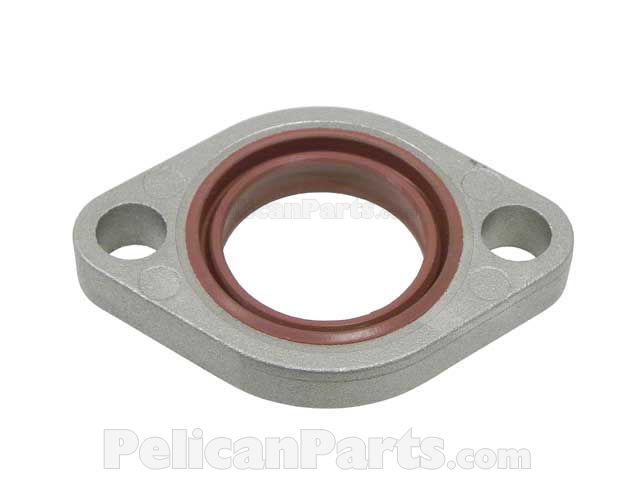

If you are referring to this:
It should pop right in with gentle persuasion.
OK.  We use a seal installation tool, but a properly sized socket will do it.
Thanks, this is great! So you're suggesting that the valve cover should indeed go back on before installing this seal, correct?
Also, do you recall if the installation tool applies pressure to the harder plastic ring on the outer edge of the seal, or is it snugged to the white cam adjuster, and applies pressure to the "inner ring" of the seal? That'll help guide what size socket I need to locate.
The seal tool we use matches the outer diameter of the seal.
