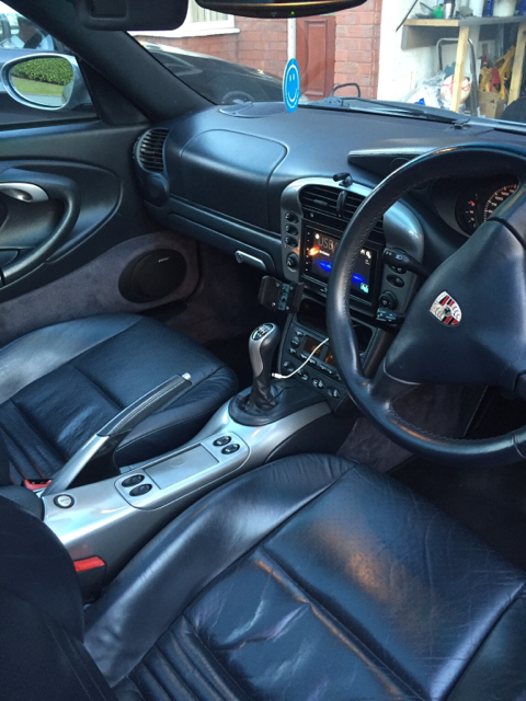

Hi I completely stripped mine & painted with a rattle can... Even though it cost me less than £50, looks so much better than the tatty interior I had previously....1b86e25e011be311059bcb98b965c44e.jpg
This was only a first attempt, I did the seat backs as well, will need doing again, but, I now have a base to build from

Hi, if it's the rubber feel paint - you may struggle to find a match, also prepping just a small area to make the paint "stick" maybe a challenge,
If it is "normal" gloss type paint, it's a doddle, I bought a colour match rattle can from eBay - bit pricey at £25 - but a great match (seal grey) painting plastics is not difficult, as I said, mine was done using cattle cans only, use a plastic primer & then filler primer, then top coat, then lacquer - allow it to cure fully before fully polishing - hope this answers your question...
