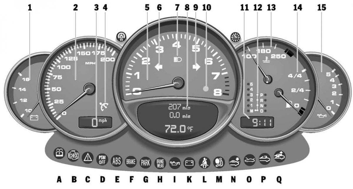

Are you saying they are not in this image on page 68 of this file: http://maben.homeip.net/static/auto/porsche/Porsche%20911%20996%20Owners%20Manual%20200205.pdf
Yes JFP, there are 2 unlabeled red round lights, one just below the voltmeter, the other just below the oil pressure guage. When starting the engine, both lights come on. The one on the left side immediately switches off, but the one on the right blinks about 3 times before extinguishing. I don't know if these lights are related to the gauges above them or have some other purpose. I have also noticed a low volume chime unrelated to the blinking light. I recently had the ignition switch replaced and wonder if this could be a factor, At any rate, thank you for your time and interest. I am baffled and open to any information you can provide.

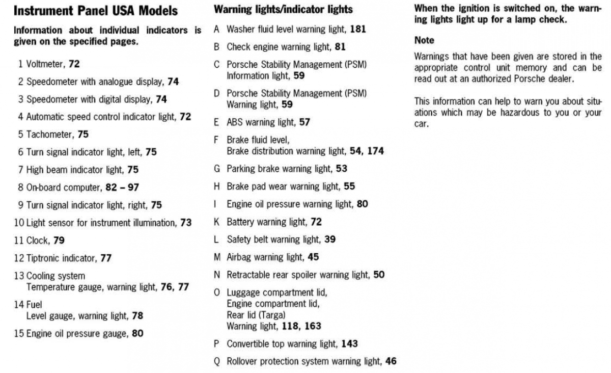

All of this is explained in your Owners Manual (if you have one).
Loren, I didn't see anything in that owners' manual pic that would explain the 2 red lights he asked about. They seem to be well to the outside of the idiot lights display.
I was referring to all the "other" red lights.

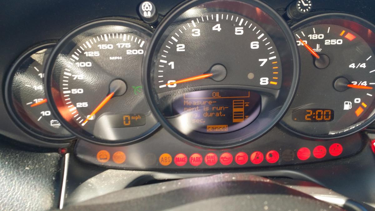

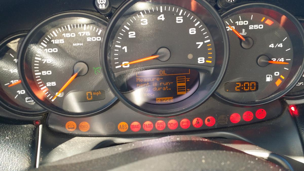

These are aftermarket lights for sure.  Likely power-on indicators for an aftermarket amplifier, or perhaps an older remote installed non-Valentine1 radar detector, or added driving/fog lights or running lights?

Just thought of the likely correct answer.... after getting home from a quick sprit during a lull in the rainstorms.
I had the rpm's up pretty high..  and it occurred to me that....
one of the lights shown above is likely an aftermarket over rev indicator.
I believe there are such indicators available.  Does anyone have one installed?
That would be complicated as it would require getting a signal from the DME when the limits have been exceeded, or the use of an external monitor system coded to do the same.  I also think that if you were using this as a "shift light", you would want it to be more prominent so you could see it.
Most likely it's an aftermarket radar and/or laser detector. The left light indicating a signal is detected ahead and the right light indicating it's to the rear.
