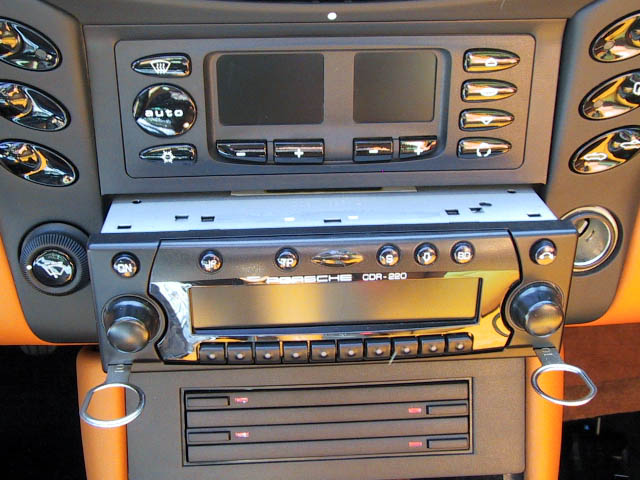

Can Someone please tell me how I can remove the cubbies, radio, AC controls and batwing from the Center stack, I would greatly apprecite it.

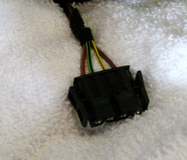

By the way if its possible I want to hardwire my Magellan Roadmate 500 for power and audio. What materials do I need for power and where do I get it from. ( I already hardwired my V1)

0. Pry out button panels(left & right) from bottom to top

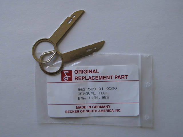

1. Radio - pull out using the radio removal tools as Loren said.
2. AC - pry out the AC surrounding bezel , remove 2 screws on the top(left and right).
3. Batwing - prying out the leather paddings, in turn, the batwing from the side.
I head Magellan sells the wires, but never seen one.
