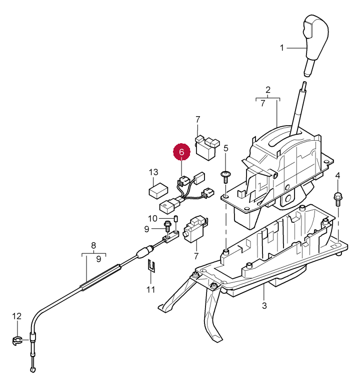

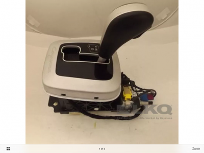

Do a search here and on Rennlist as I remember hearing something about the Shifter module in the center console going bad. Very well could be the culprit.
To unlock the shifter: http://www.pelicanparts.com/techarticles/Porsche-Cayenne/94-TRANS-Gearshift_Lock_Override/94-TRANS-Gearshift_Lock_Override.htm
Edited by hahnmgh63
Thank you so so much I've just purchased one from eBay complete unit

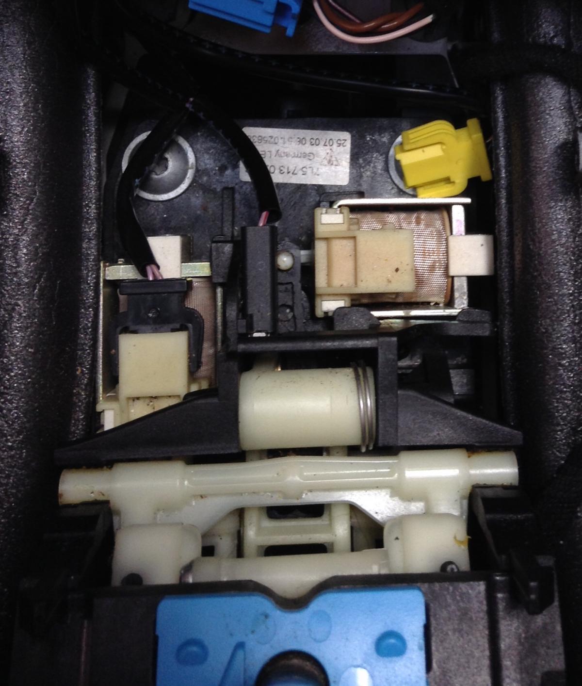

Going crazy currently I've been testing also the solenoid which actuates when you put the car in park as attached and only releases the key 50% of the time ...when watching the solenoid it doesn't fully close all the time as pictures

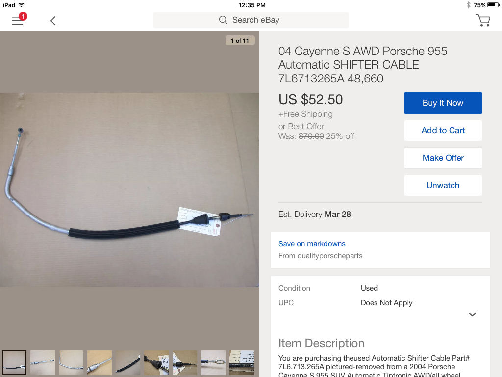

I'm not sure how to unclip the gear change cable, if you have any advise appreciated .
