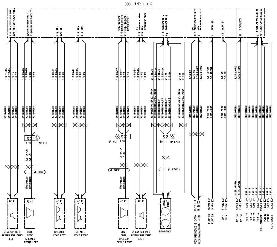

I've installed an aftermarket amp and HU in my 2003 MOST Bose Cab.  All went perfect from pinouts provided here for the HU.  After getting everything in, I discovered that I neglected to run a switched source into the trunk to trigger the new amp!
There must have been a switched source in the original harness to trigger the factory amp?  Can anyone identify the wire colour or which plug it is on?
That's a big help knowing the TERM terminology Loren!  In this case it didn't solve my issue, but is great info for future application.  Thanks!   In this case I ended up running a lead through the firewall into the cabin and tapped into the switched feed to HU.
