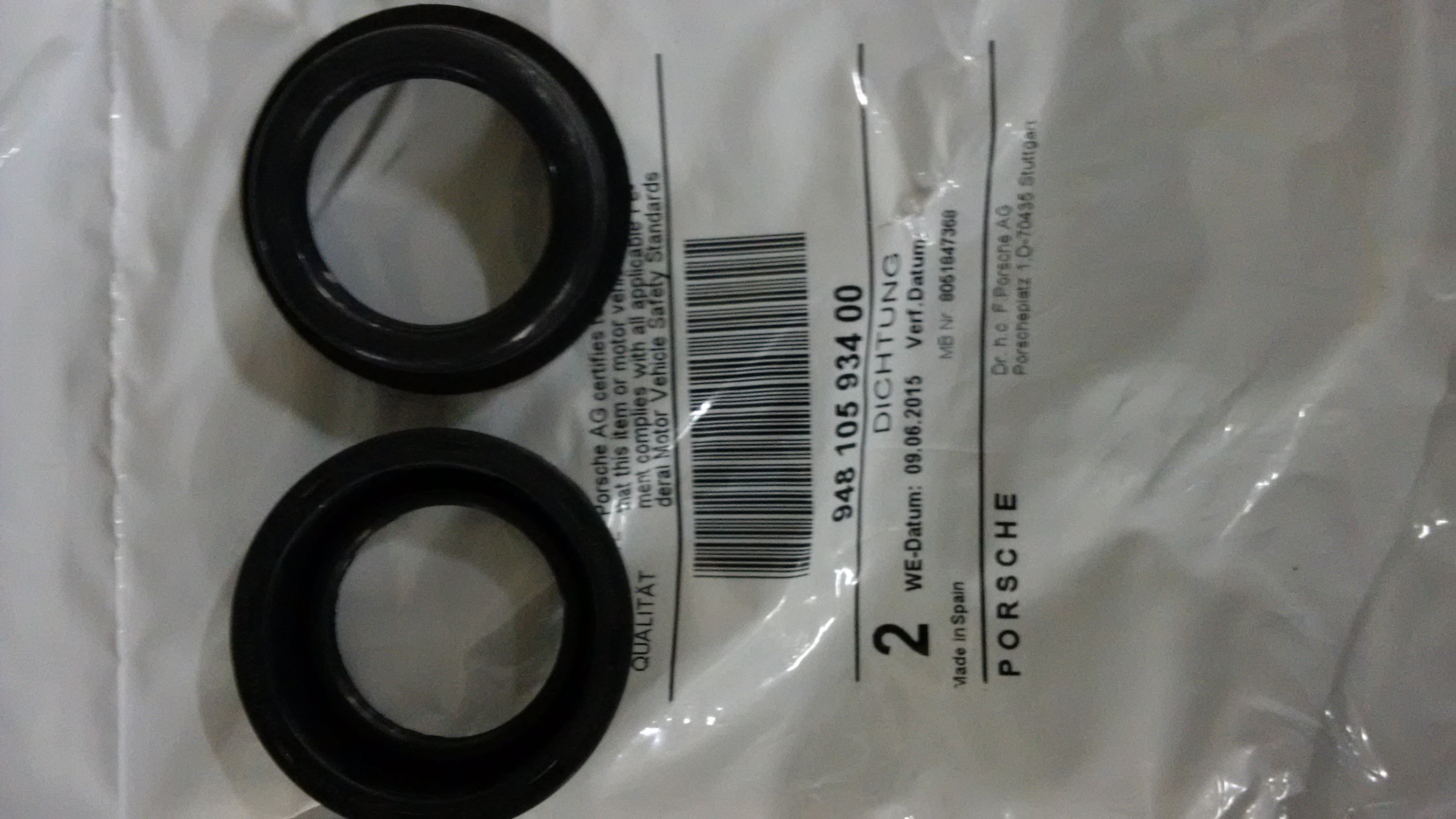

I did the actuator solenoid Seals today went really well and about 15mins work. I ended buying from local Porsche centre as I couldn't find anything generic in the market. $50 for the pair.

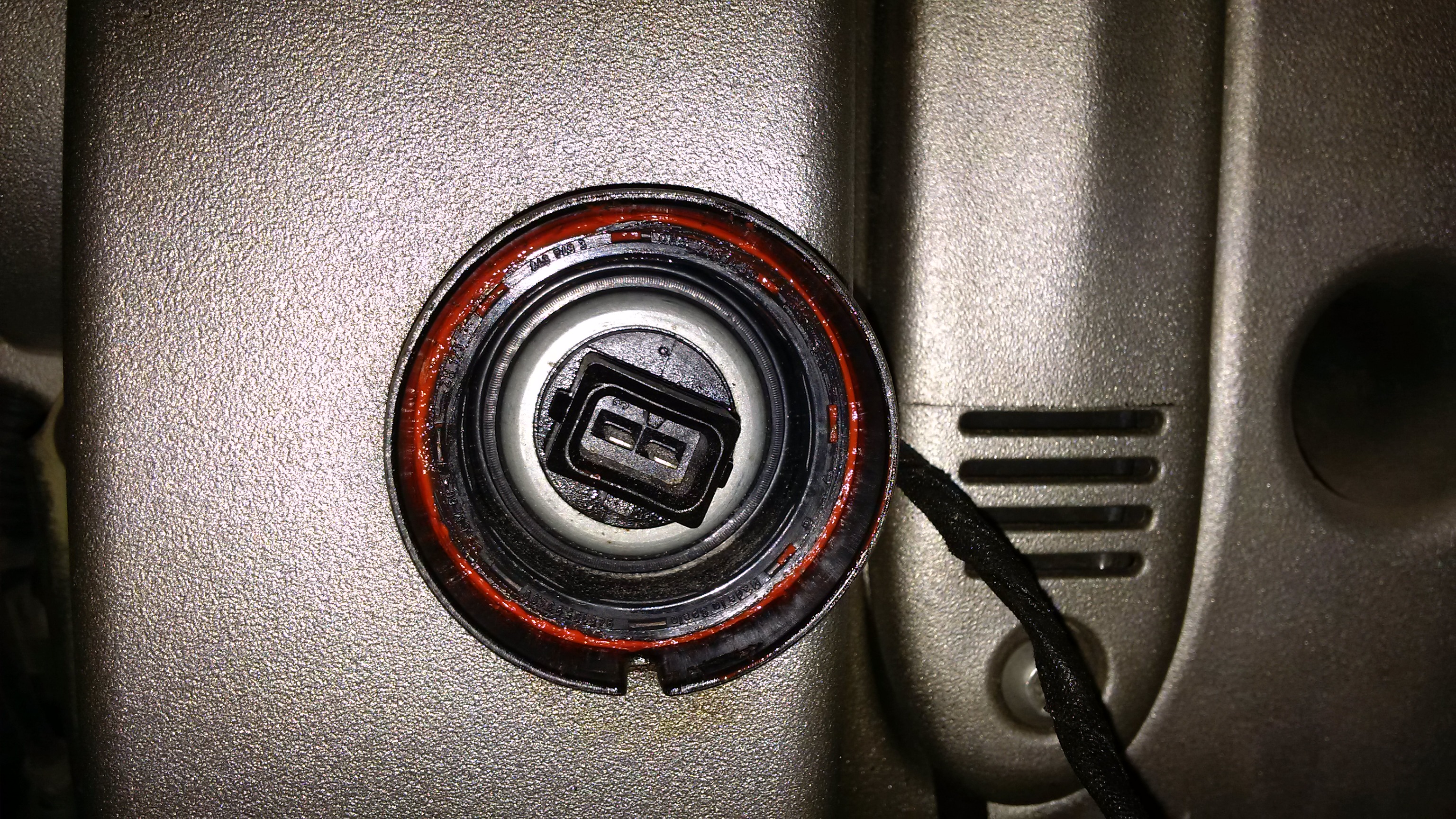

See pictures I put rtv gasket seal maker around the lip and used a 32mm socket to gently tap it into place, it actually goes in real easy. Quick wipe around and all done.
