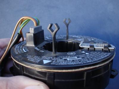

Remove the cluster and check bulb and replace if needed. You'll need to replace your clockspring which can be very spendy new. You may want to find a used one that is guaranteed to be in good working order. Used $50-$75, New $244-$310 depending on where it is purchased.  Part number 996.652.211.01

Make sure the little tabs or forks are there if you purchase a used one.

thanks kbrandsma. I ordered a used one. Let's see if that solves the problem. Going to work today with my speedometer too to see why the bulb isn't working.
Problem solved. After I replaced the clock spring ($39 from UK from a boxster) I got the Durametric Error 01 for the bulb. I changed the bulb and everything is fine now.
