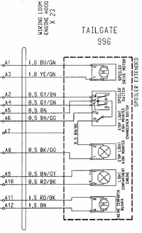

Loren- I am installing a GT3 MKII wing on my '02 C2 Coupe, do I need the -51 harness or can I just jump pin 2 to pin 5 in the exisiting harness and be done with it? Are the pins marked or if now which is the count direction?

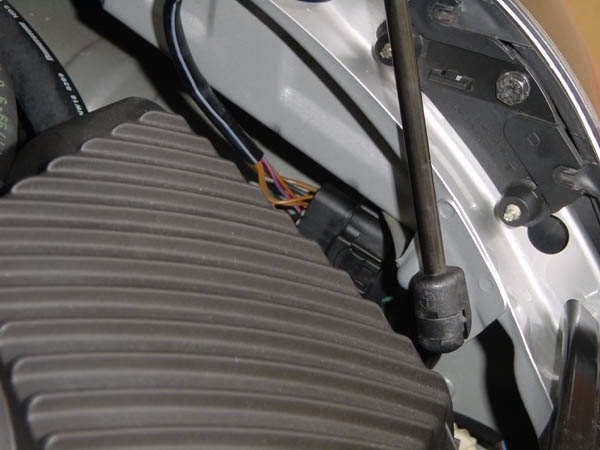

When a fixed factory (Porsche) spoiler is added there is a change to the wiring harness to disable that warning. You need to purchase and install (5 min max) the following new harness: 996 612 070 51 Wiring Harness.
Technical Details:
Check whether there is a jumper connecting pin 2 (which is already jumped from pin 1) to pin 5 on plug X23 of the new wiring harness (connection to the vehicle). If this is the case, the spoiler extended signal will be constantly present at the control module and the warning light of the retractable rear spoiler will not light. (at speeds above 74mph).

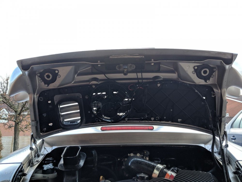

Connect the plug connection of the new wiring harness to the vehicle. Route the wiring harness along the hood shock to the fan housing and attach it on the rear lid with two (2) fastening clips. Connect the fan and interior lamp plugs. Done.

Use the wire colors from the MY02 diagram below
