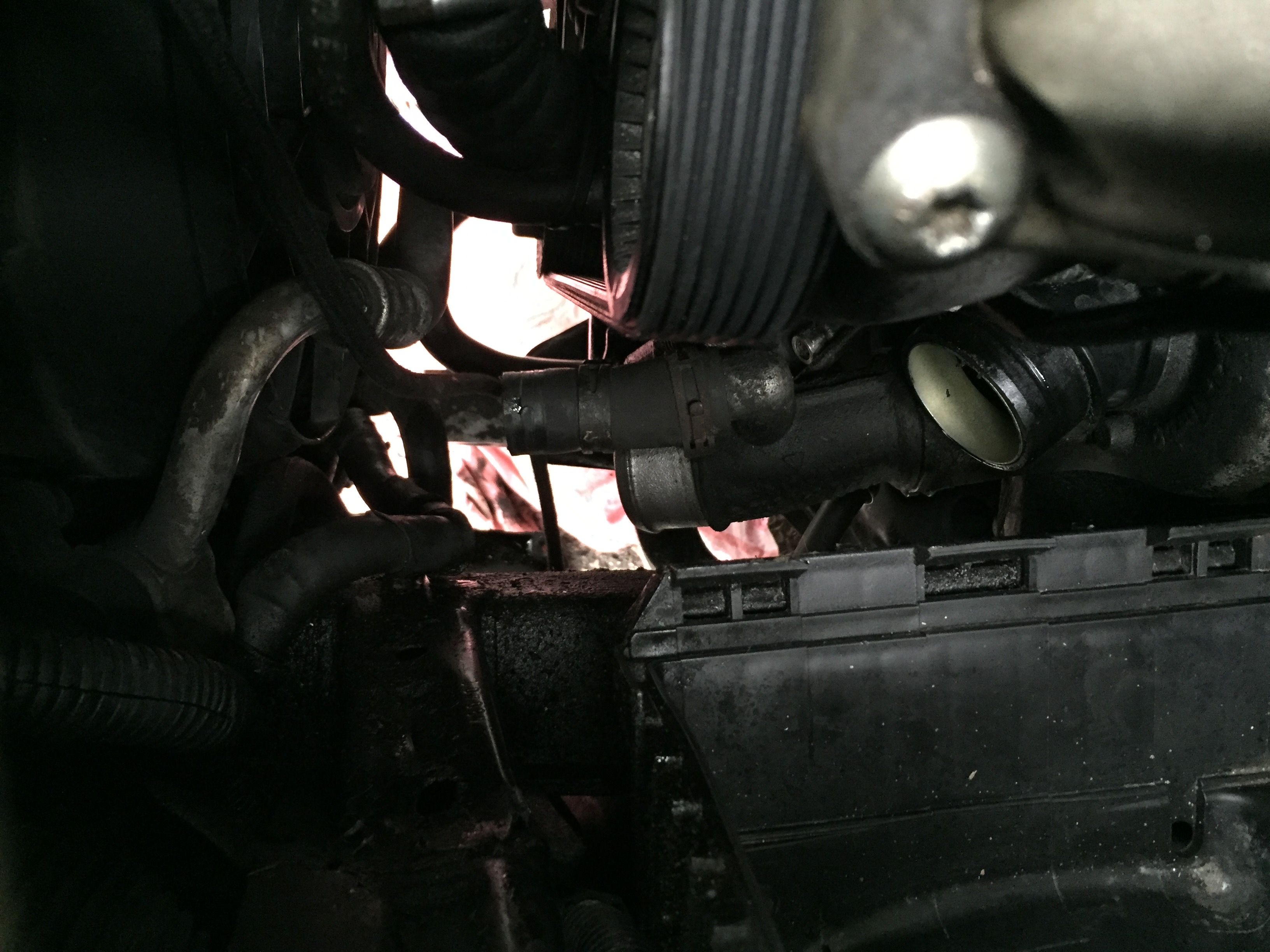

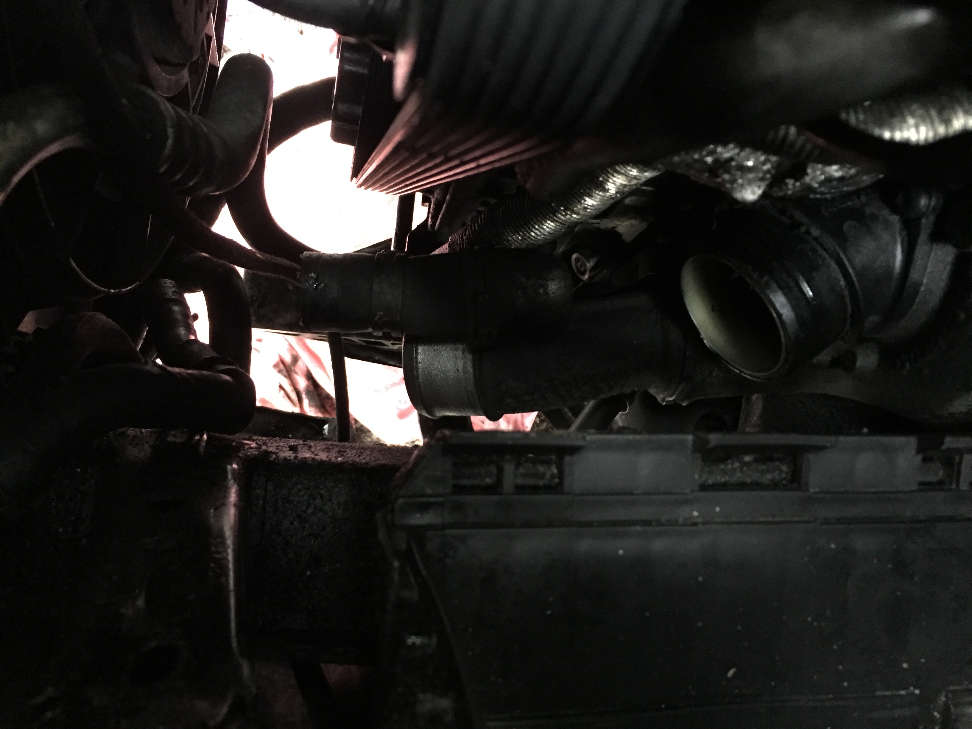

a little bit of a pain because not much space but i made it. DV is changed according what Lewis postet. Step by step and finito. If my oil problem and power loss is coming from, we will see.

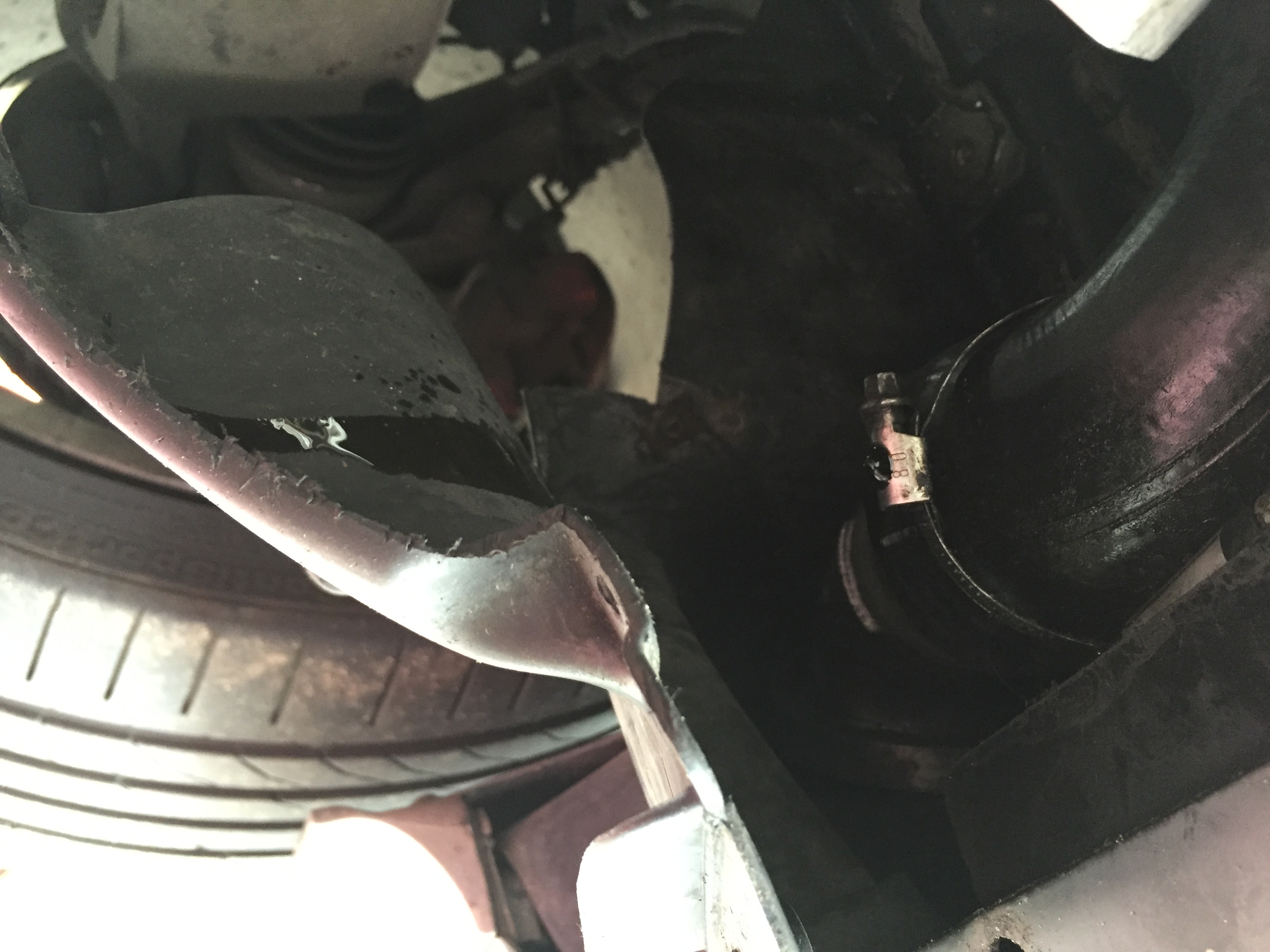

of course i got a good portion of oil coming out from the hose which fits to the intercooler.
My guess the problem with the oil can come from a some other part. Its the breather hose which is going from somewhere close to the turbo charger up to the breather valve which is sitting on the valve cover. Looks a little bit friggle. It was covered with oil. I clean everything and next km will show whats going on

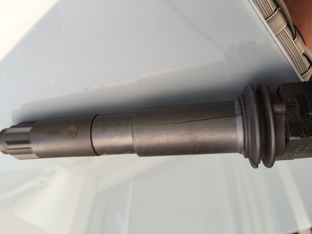

Could not stop thinking about if i did something wrong during my weekend repair.  i thought ok lets check the coils again. Car in front of our holiday destination in Cannes. Open hood. French people which passed the way: "porsche which has problems" somebody asked . For shure they are thinking what is this german doing here with his car.
First coil bank one, voila
How old are they and what revision number is the part? Maybe the over heating is increasing due to this misfire or maybe the overheating lead to the Coils cracking? Or maybe two separate issues to give you a double headache and a wallet bashing all the same.
At least this is a simple fix if not a cheap ones.

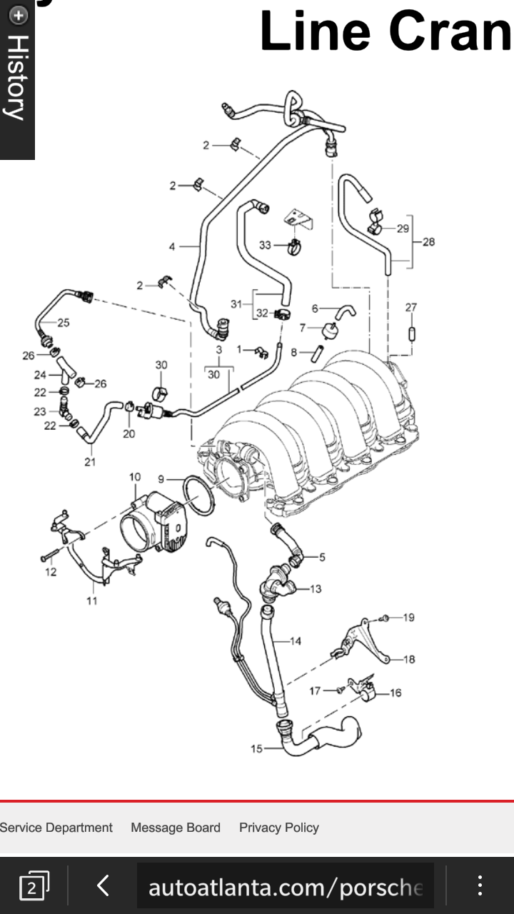

FYI I found some interesting things today which I think explain all my running issues !!!!
Hint leaking check valve 13 and leaking check valve on pipe 25!!!. Ordered both already........

I carry 2 coils with me. Thanks god.
I changed them and the car is running fine. Just drove to the beach and back. But now which surprise. Check engine light is on. Grrrrrrrrr. Code 2187 and 2189 which means to lean at idle. Get crazy.
I hope you have found the source of your problem. Part 13 i just changed last week because the membrane inside was not ok

This is revision 08, latest revision which I have fitted is 21. Says a lot about Beru quality...........
Your lean codes might be as a result of driving with cracked coil and the dme tried to adapt to that, now the misfire is gone with replacement coils it is now lean. Reset the fault codes (fuel trims will also be reset) and drive a bit more then check again.
