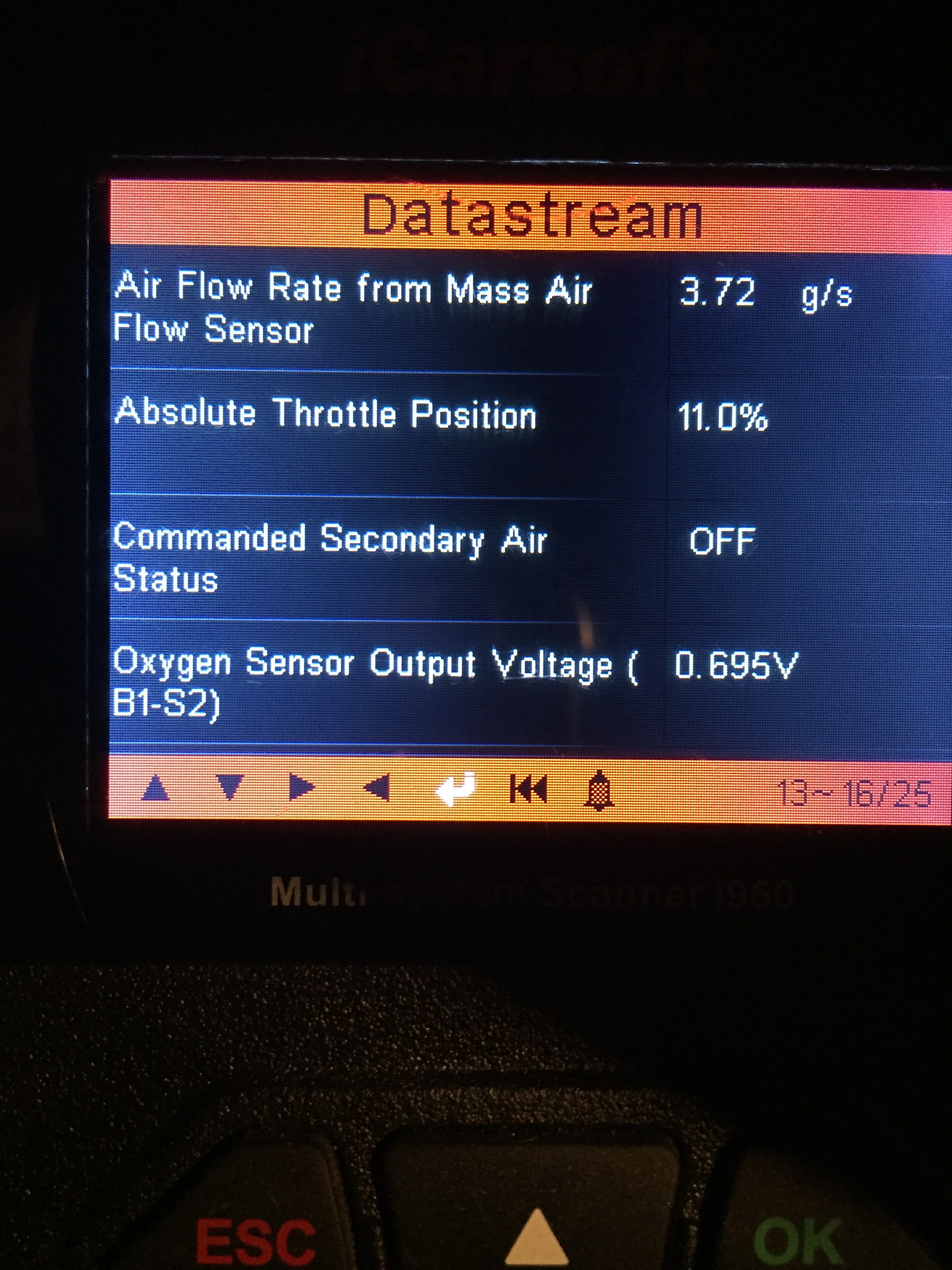

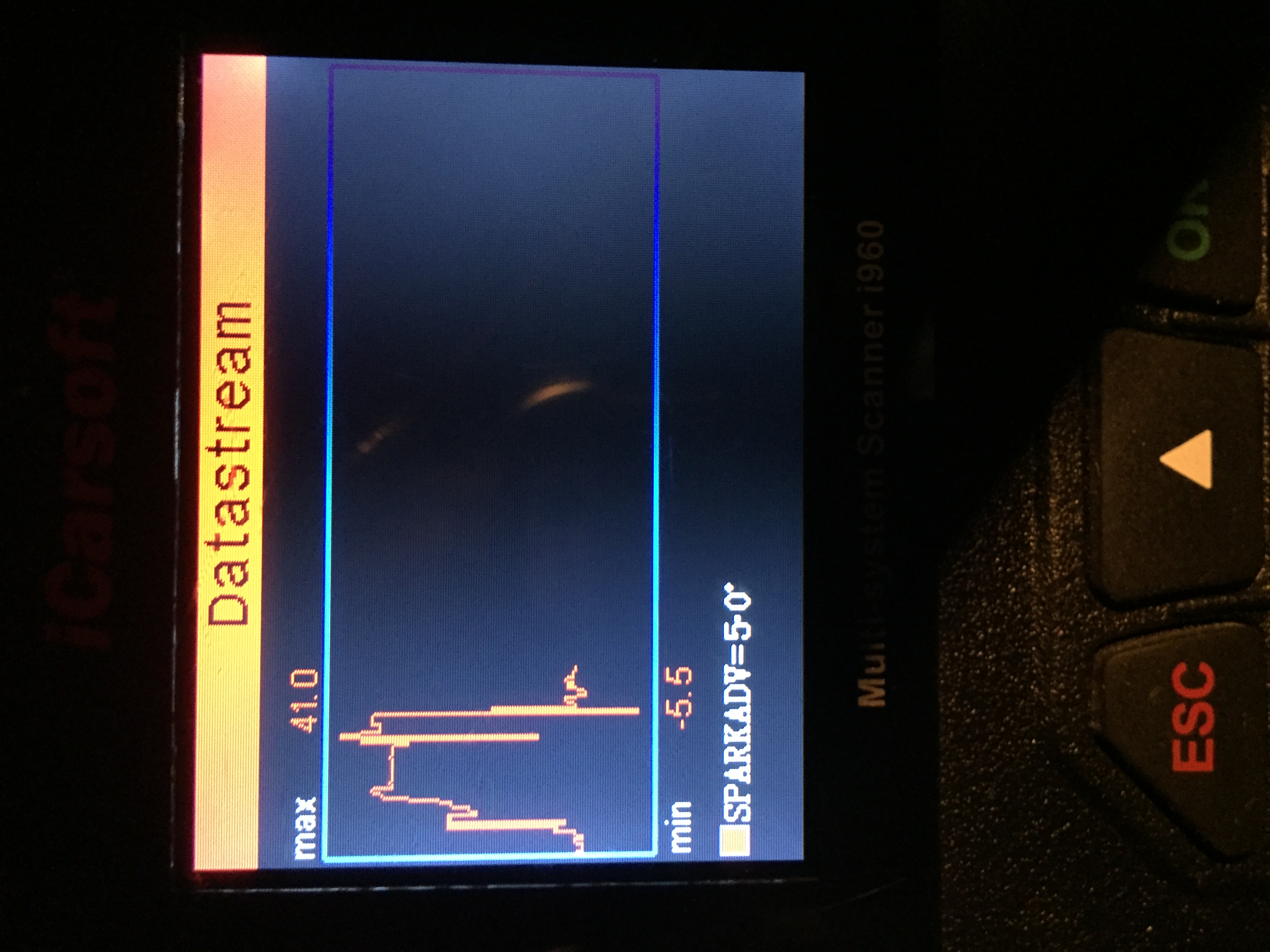

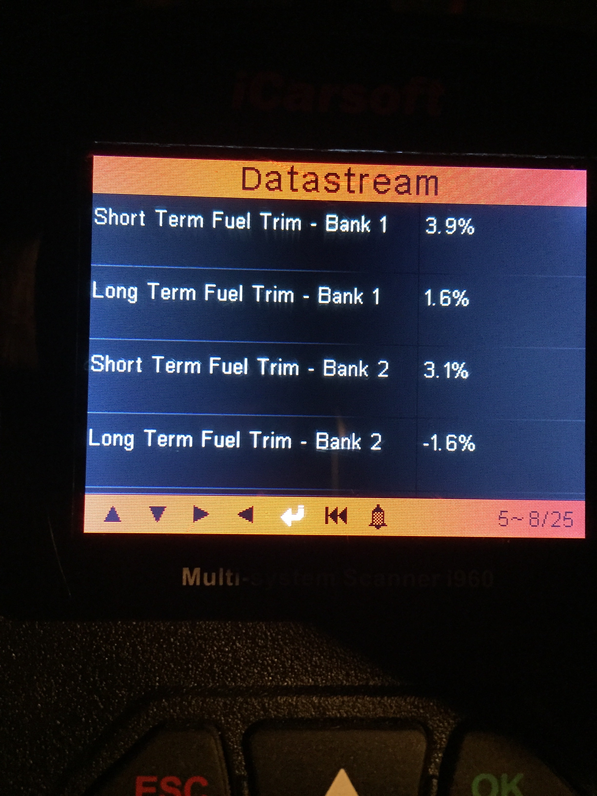

Check with my OBD scanning device. Please find the readings.
Maybe the pros here have a idea whats going on.

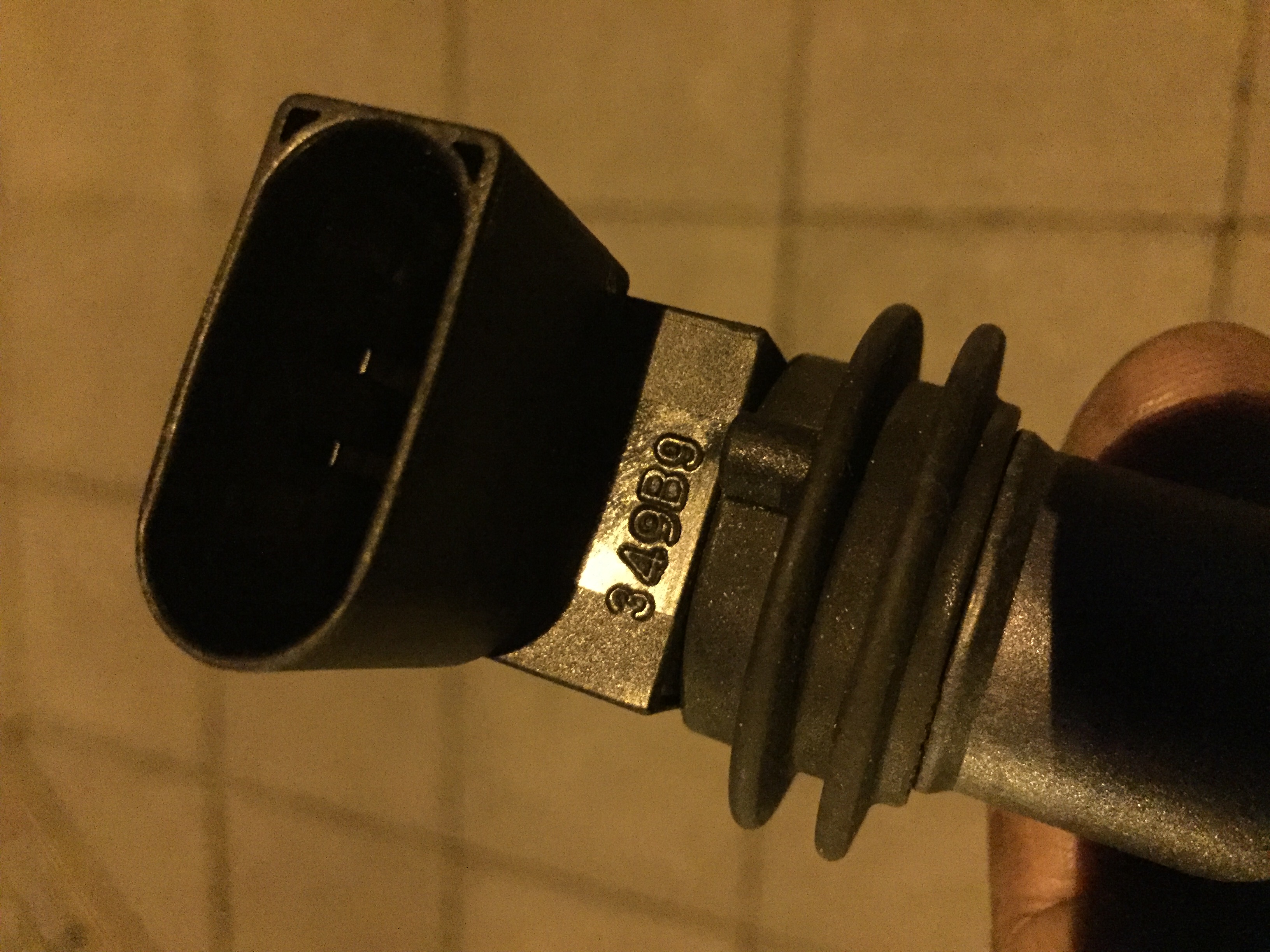

Onother question regarding coils.
i have about 24 pieces at home. Some are used some are "new", lets say not used.
what i a wondering , is a coil only faulty if its cracked or can be there other problems which are not visibel?
some have a green label with the part number. Some have the part number engraved into the plastic  and some dont have anything. Just some kind of code in front. See pics. How to know which version is this?!

Thomas looking at you 5degrees timing at idle and 27degrees at 1100 rpm it is correct, also full trims looks OK within +-6%. Trigger wheel I don't think is the problem!
The Maf flow is LOW 3 g/s, it should be 6g/s at idle. Rev and hold the engine to 3000rpm it should say around 25-27 g/s. If not then something is wrong! Damaged maf sensor, dirty, covered in oil etc?. Also another test is to measure the maf voltage with engine off ignition on, it should be 1.100volts or it is defective.
Also you must be sure no coils are failing. If your codes don't relate to individual misfires on cylinders then maybe coils fitted at the moment are ok.
What does the idle feel like? Smooth or rough? Stable of fluctuates?

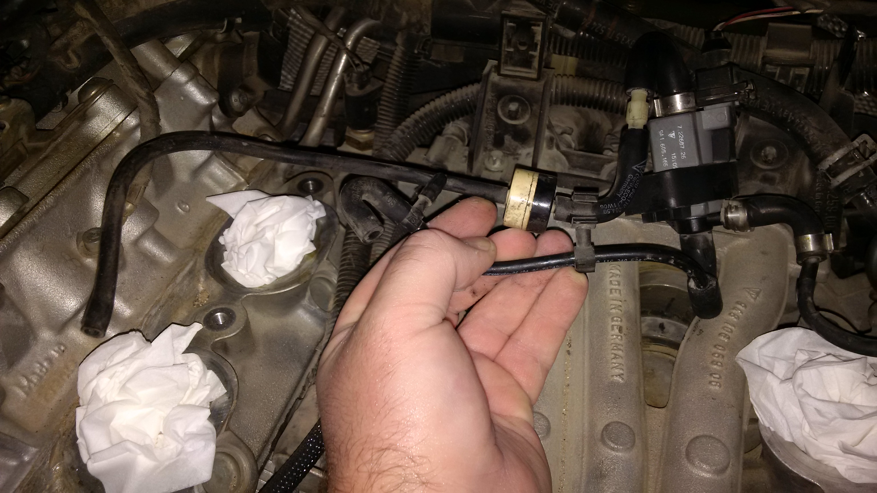

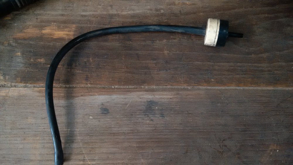

looking arround all the small tubes and hoses i found suddenly a small hose which hang arround. Close to the intake manifold close to the firewall. Its wasnt connected. Slipped from a valve because i was split in the end. Connected and. Wow. The Turbo is back.
From the very beginning a smoother idle and a almost flueless accelaration.
Testdrive. Changed again for the new MAF. Testdrive. German Autobahn without speed limit. Wow. Looks like i found the 200 missing horsepower. The car runs very good. Fingers crossed!!!
thanks to lewis which constantly pointed me to a vacuum leak.  For me a new lesson.  what difference a single small tube can make which is not connected.

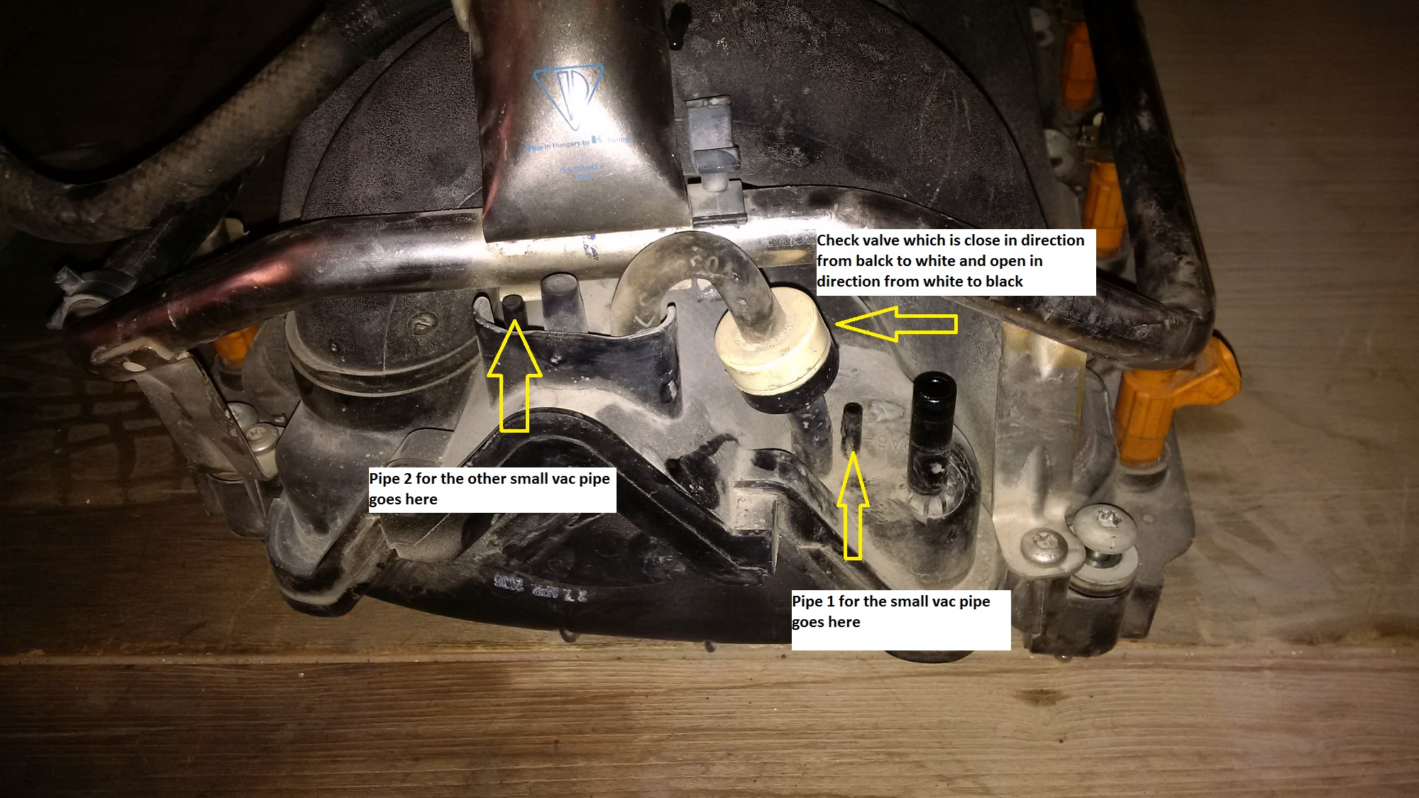

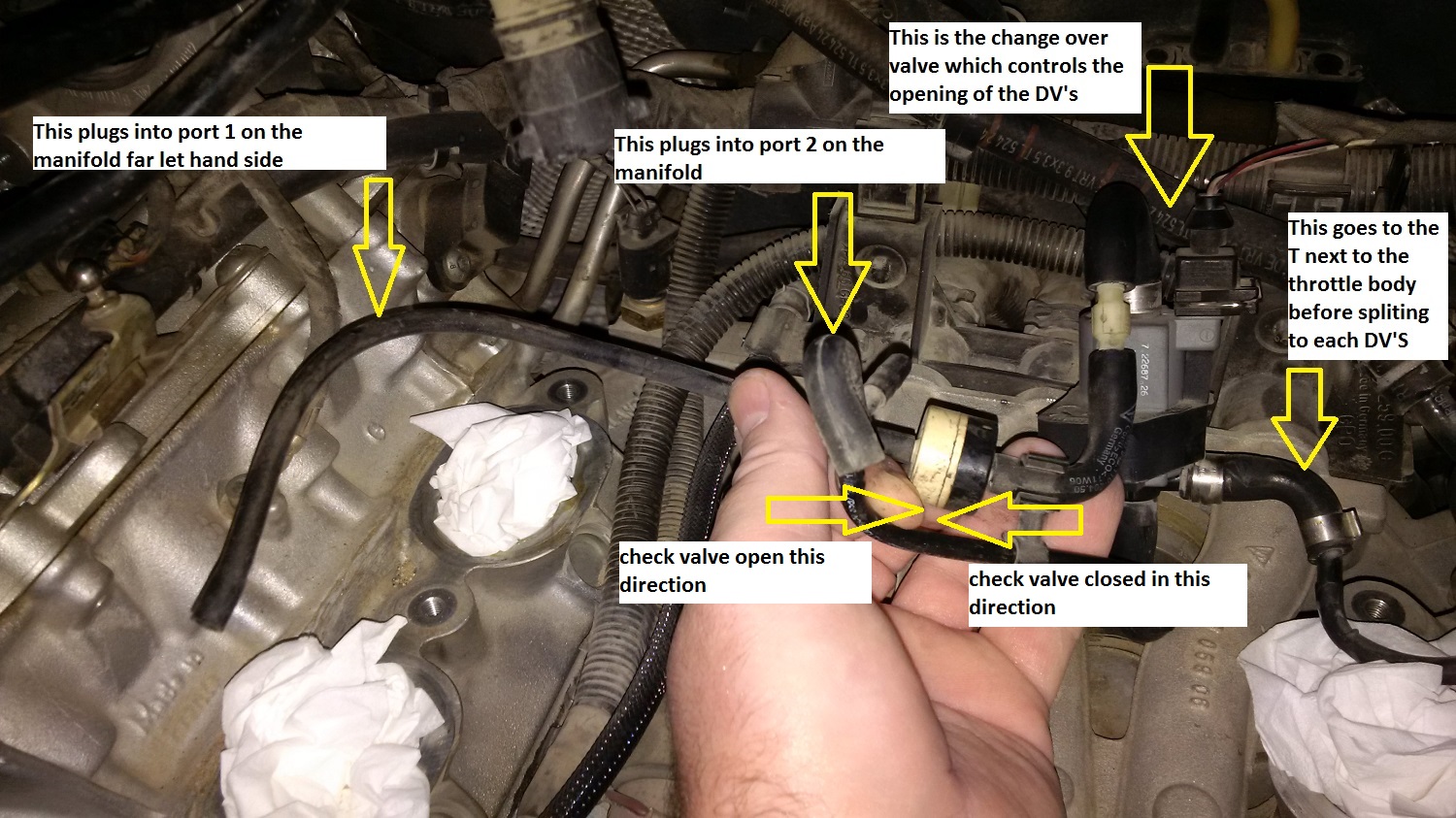

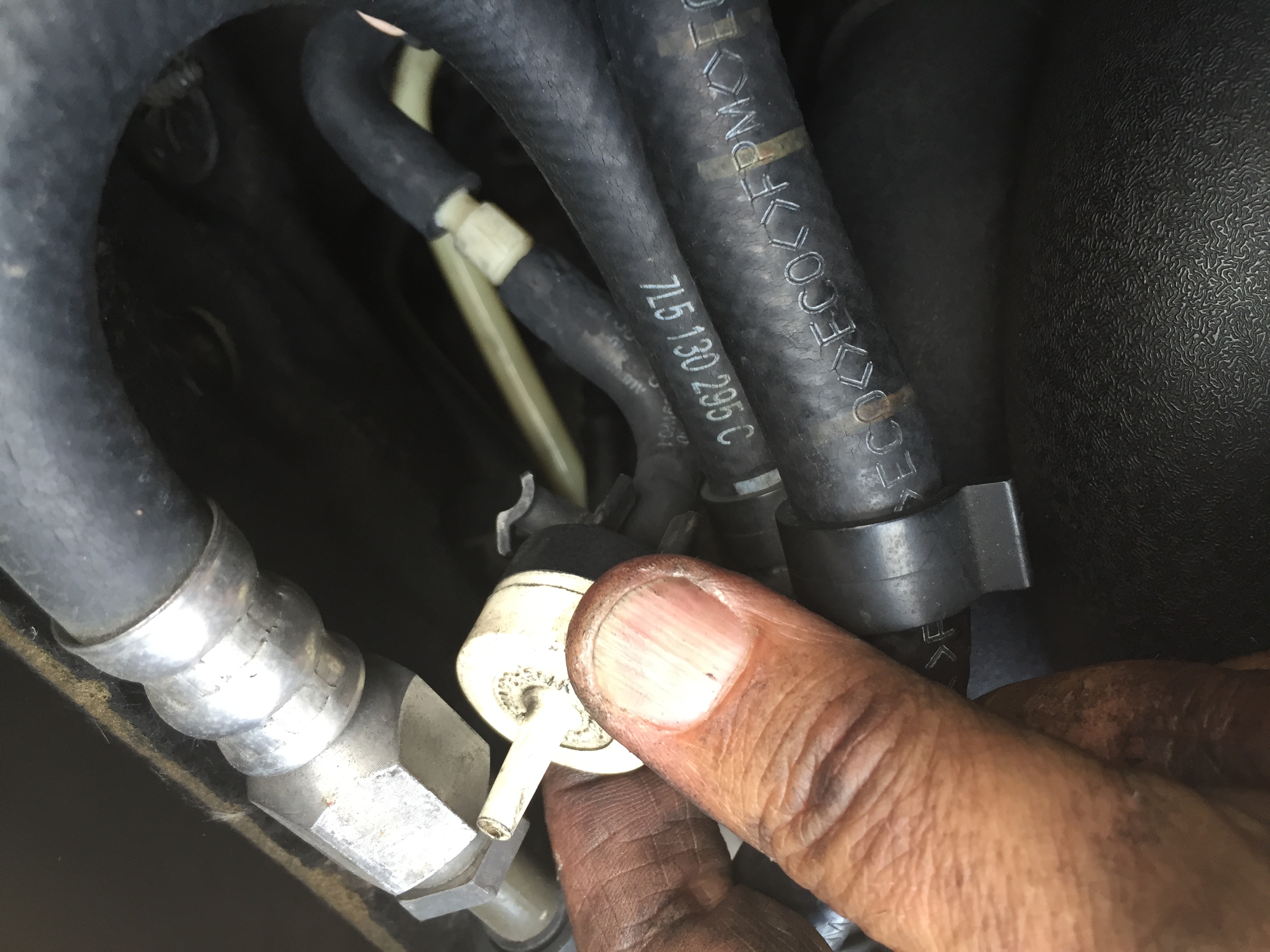

Thomas here is the info you need for this little vac pipes.
YIMG_20160918_171857.jpgIMG_20160918_162754.jpgou can reach and change the vac pipe no'1 by removing the passenger side Secondary air Pump then you can see the pipe to remove and replace. note the check valve should be tested also.
12 minutes ago, ekstroemtj said:
Sorry i should have checked more careful. One pic is from backside rest from front. Was confused about the white part seen on opossite direction.
Except the hoses 6mm/ 4 mm which sizes of tubes i should buy for other culprit areas?
Hard to say as they are little pieces of different shape and size rubber flexible tube pipes, they are mostly thicker tube pipes and none of mine had any damage so I'm sure yours are ok too except the vac pipe which is coming off the little valve which your need to secure with clip or change to new pipe which will make it a tight fit again as Porsche is not using any clips here as you can see.

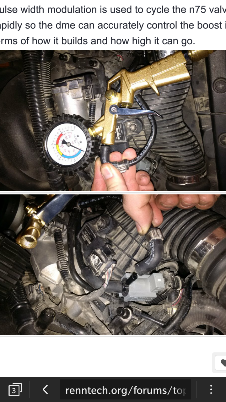

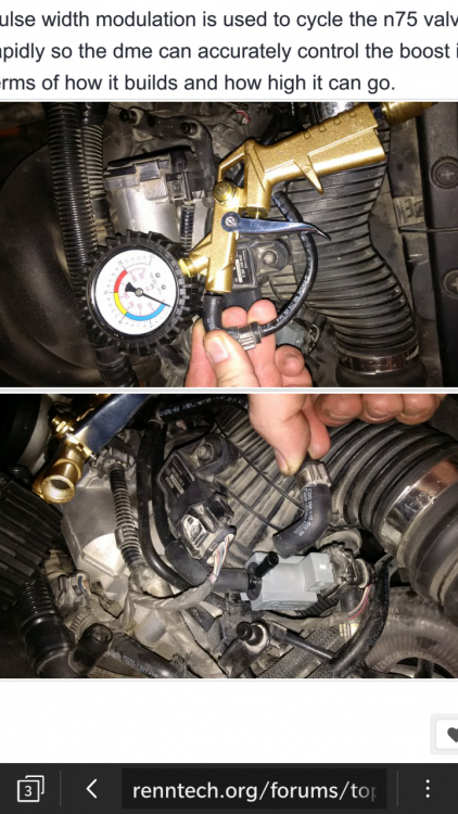

Thomas you must swap the purge valve from the S and clear that code for now. This may be the hesitation at 2500-3500rpm. For the overboost code firstly test your wastegate is opening on both turbos.
See attached pictures, simple pull this pipe of f the n75 valve and pressurise to 10psi with air gun. You should not hear any air leaking and you should hear he wastegates opening and when you release the air pressure they will be heard shutting. They should work at the same time.
If the either wastegate is stuck or any air leaking in the pipes you get p0234 overboost code. Do this before wasting money at Porsche.

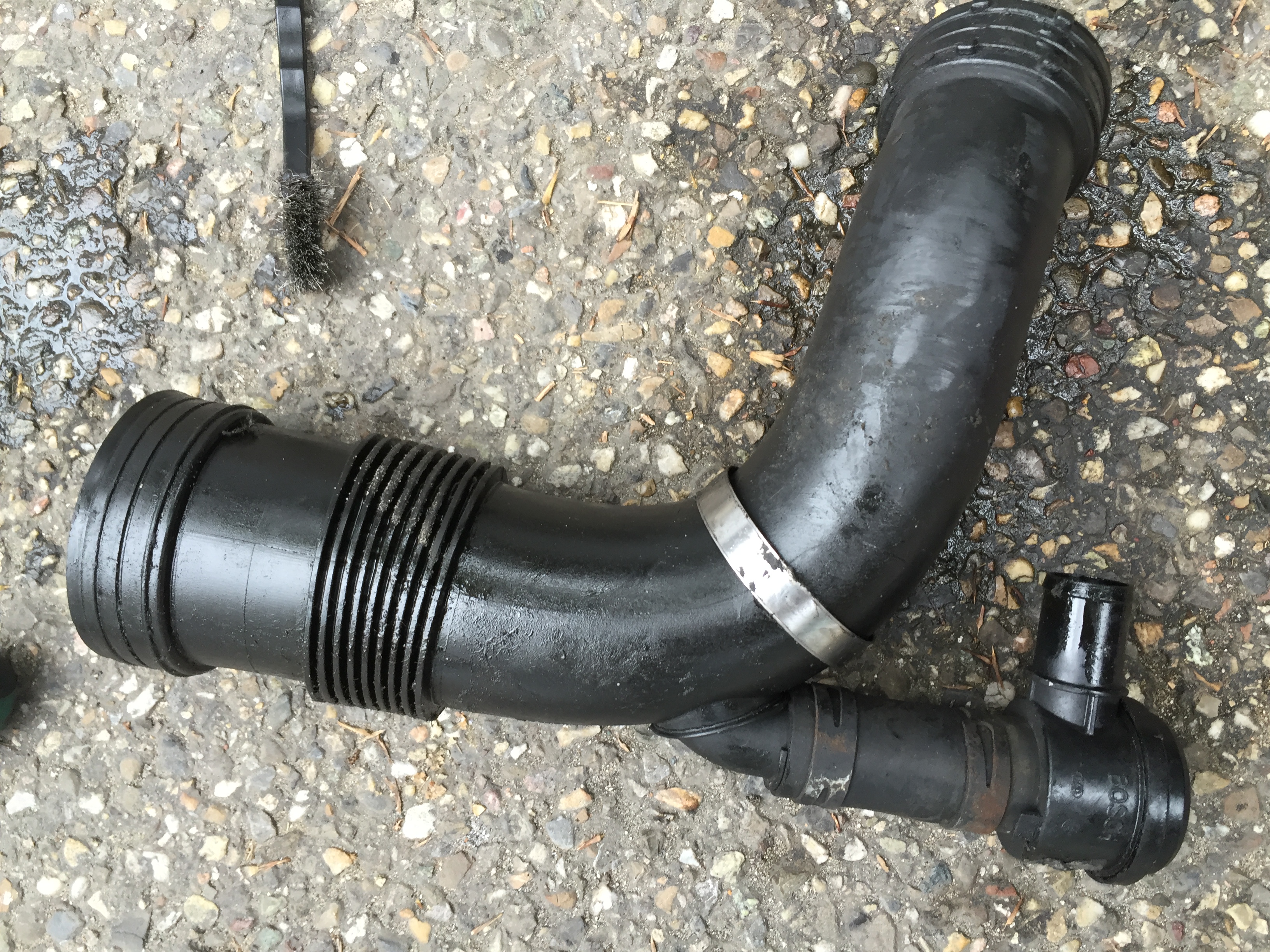

So today at least i was able to change the air hose which is going from the turbo to the part where the MAF is located. Little bit teight everything down there but in the end could do it.  Which surprise, the car runs better now. Couldnt feel the hesitation right now while driving.  I will report how it will be next days.
