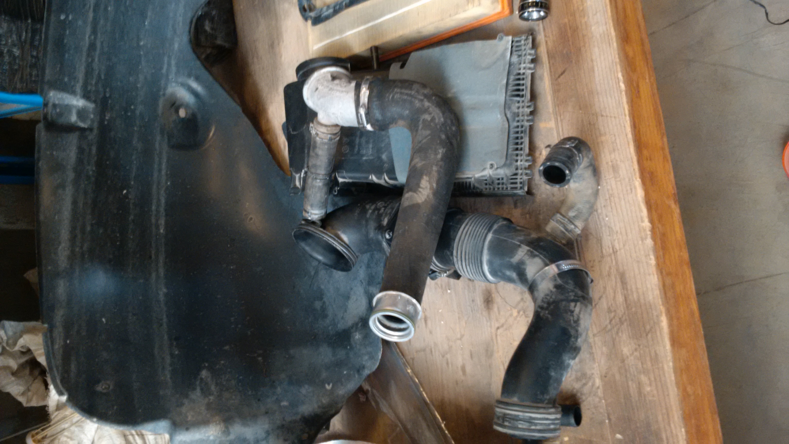

I continue to work on finding the cause of my hesitation. Started to replace a lot of turbo related pressure pipes.
On the firewall everything arround the change over valve. Everything arround the N75 valve arround the intake y pipe. Pipe which is going down to the wastegate. Just the passenger side. Driver side looks difficult. Car is running with every step a little bit better but its not perfect.

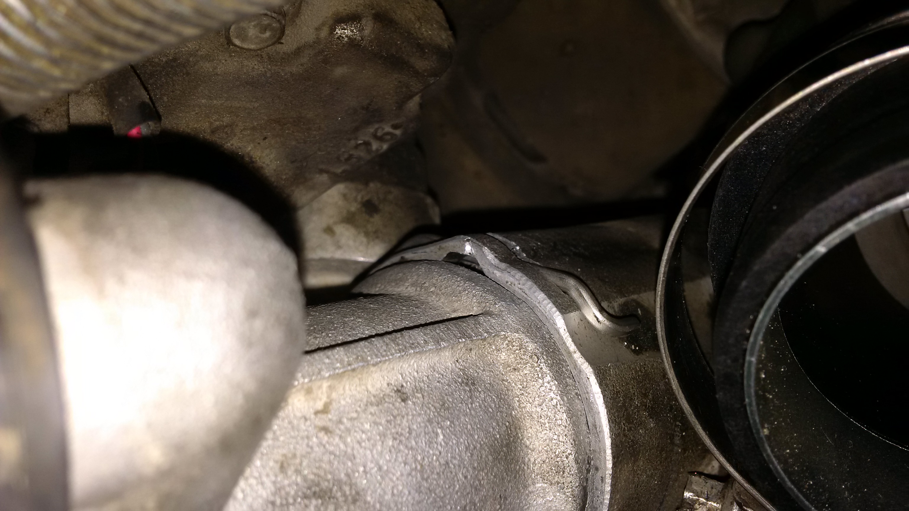

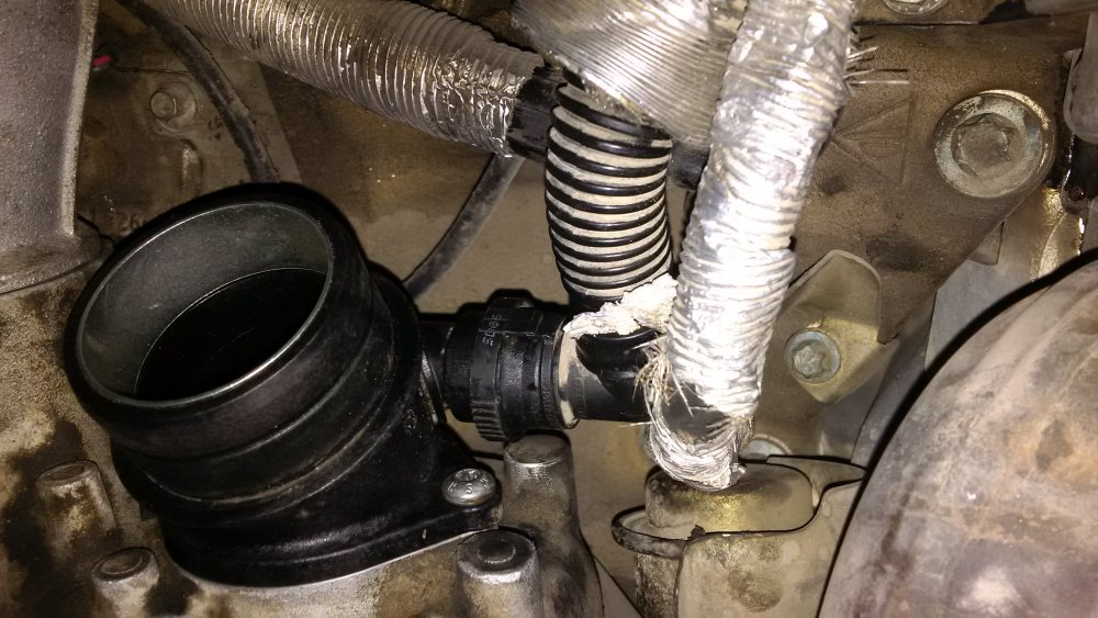

i remember when all this trouble started and i had to take out the air hose on the driver side, the pressure hose which is going out of the turbo direction intercooler was not very much fixed. that time i was thinking maybe it should be like this. now i know it isnt. when i crowl under the car this weekend i inspect this metal hose which is connected with the turbo charger. the gap between the 2 pipes is to big i believe. have a new seal. wanted to change but isnt easy to get access without removing lots of parts arround.
the 2 pipes are connected with a clip. the clip is open on one side. does anybody know in which way it has to be installed?
4 hours ago, ekstroemtj said:
Can this gap / old seal at the pressure hose cause a bad running or i am mistake with my theory?
Fitted the pipe should be inside and almost flush against the turbo outlet opening, the clip just sits in a groove either side which stops the pipe from coming out, the oring inside around the pipe really does the job I'm of keeping the pipe snug and leak tight. Are you sure the oring is in there?  Sorry I can't find a picture of this installed.

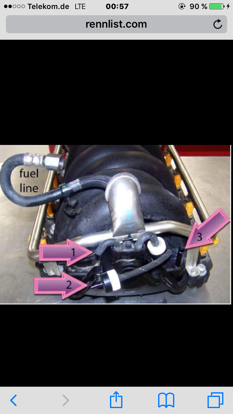

I believe there is a o ring. Otherwise there would be metal to metal and this would feel different. I will find out. Here is a pic from a DIY which was made by a member here.

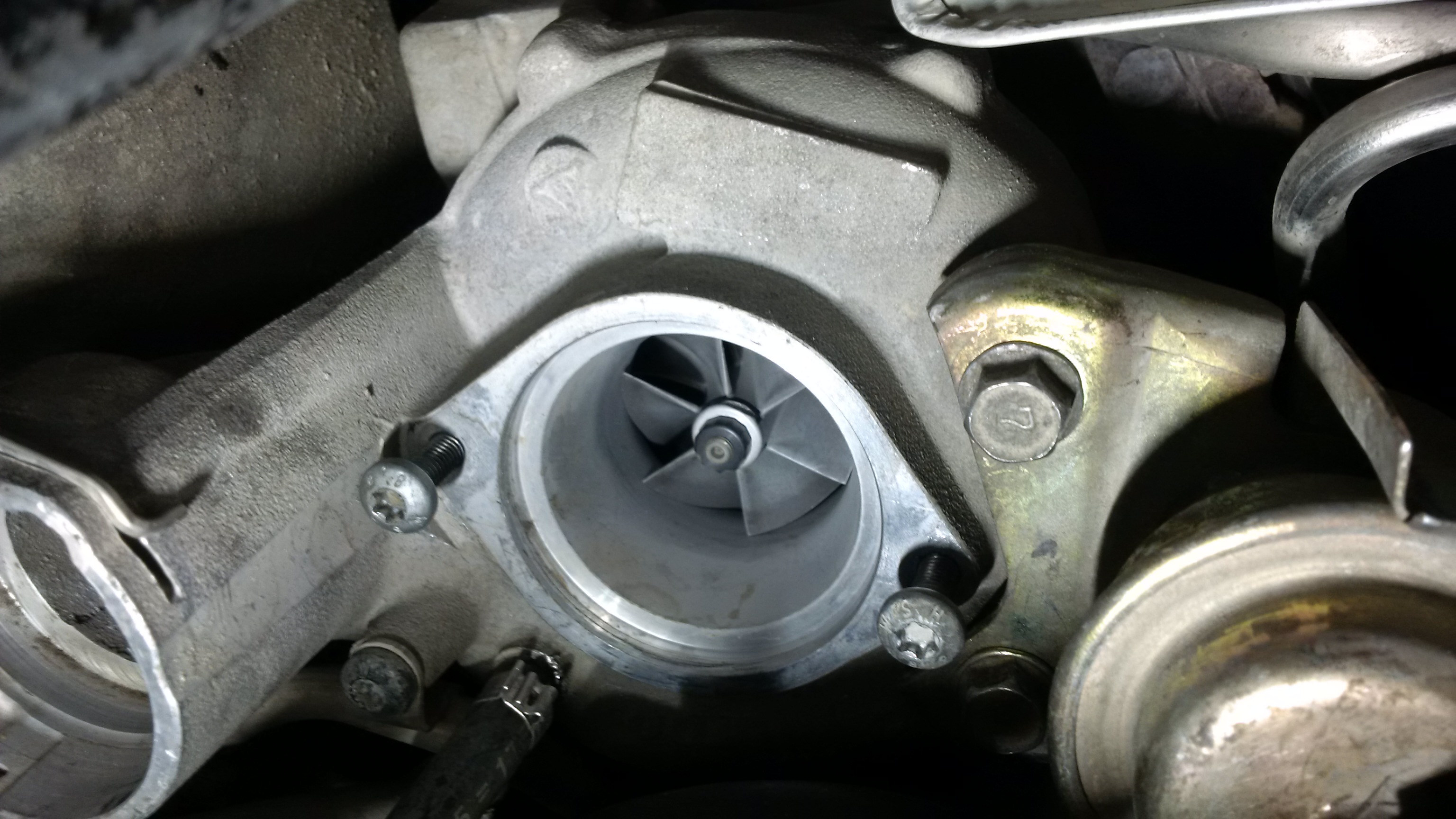

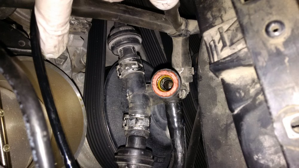

Hi Thomas, today I removed all the pipes on the drivers side, cleaned and inspected everything, I found the black pipe connector which screws to the turbo inlet was not tighten on the bottom screw, I can't say if it was leaking air in but I had hoped I may have found something. For the turbo outlet pipe I replaced the o-ring you pictured above, the pipe doesn't fit tight now ahhhhhhh and wobbles around :censored::censored:, why why why?
I checked it 5 times to make sure all was in correctly clip is secure etc but it still wobbles around which doesn't seem right.
Any body experience this? Normal? Corrective action required? Will it leak?
See pictures clip is on correctly, last picture I even installed it upside down to see if would stop wobbling around and be tight but no chance.
I checked the turbo also no shaft play radial or axial and no visible damage to impellor.

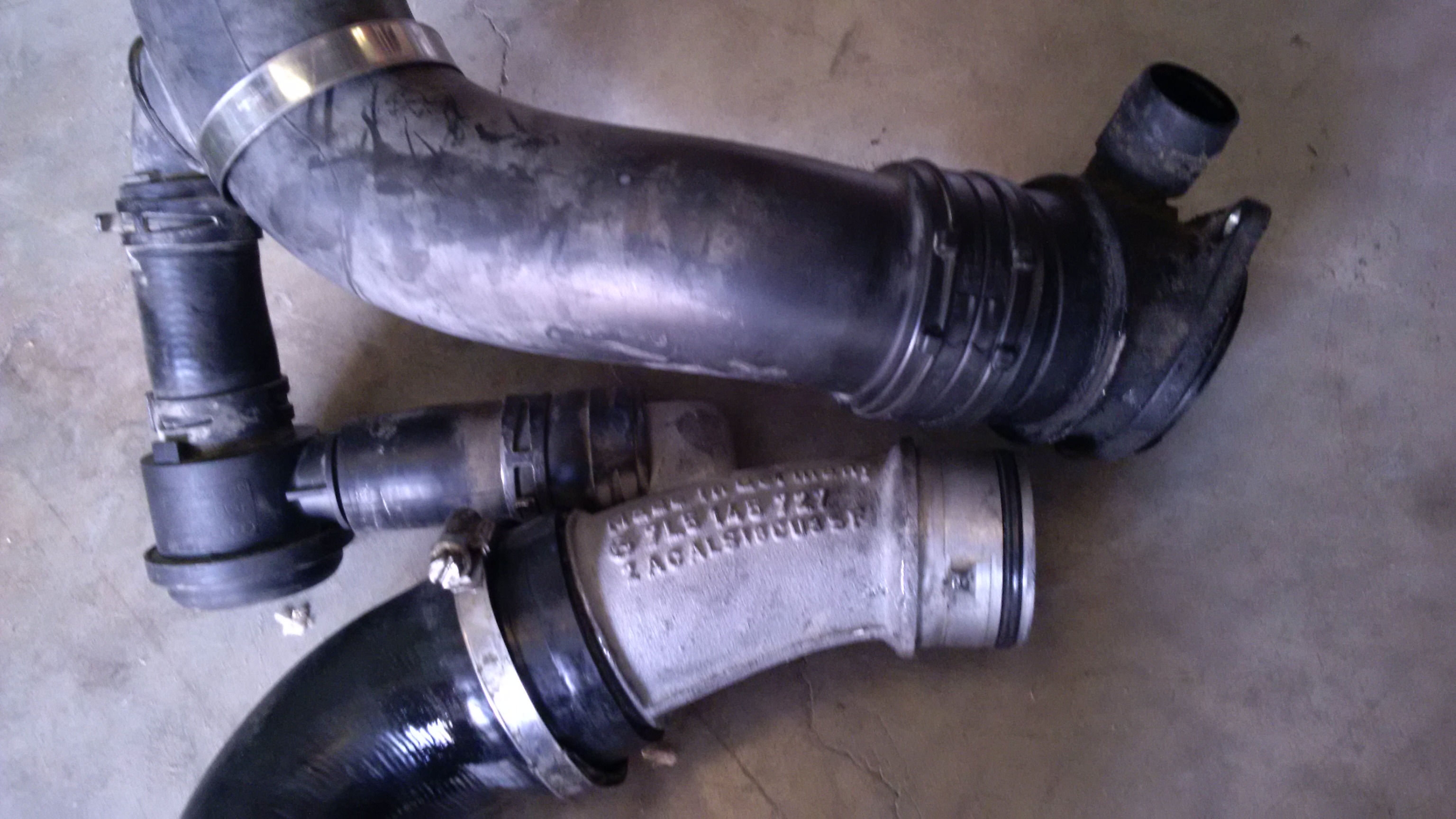

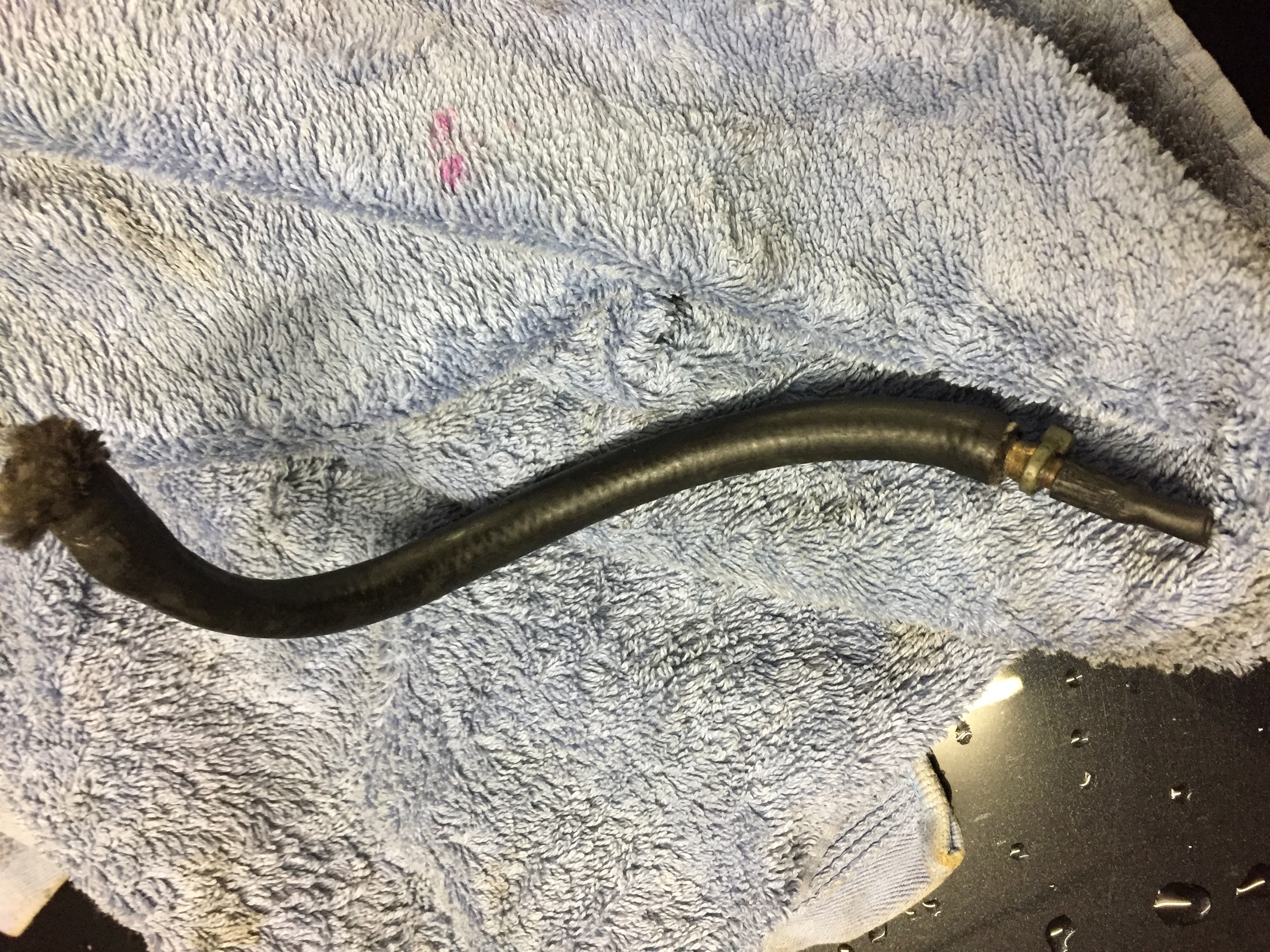

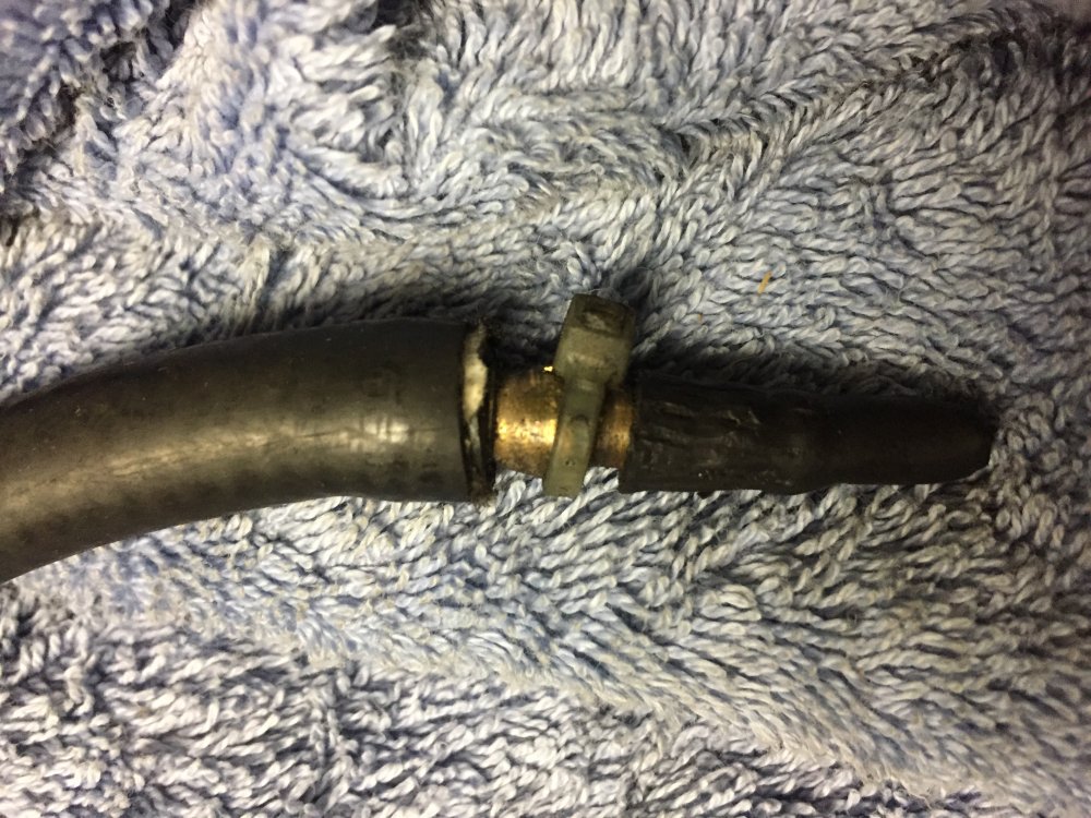

I went to my clients house to collect some cash and found the pipe number 5 on the diagram is split in half, I used half roll of black pvc tape to fix and will buy a new one tomorrow. The noise is gone!! Result.

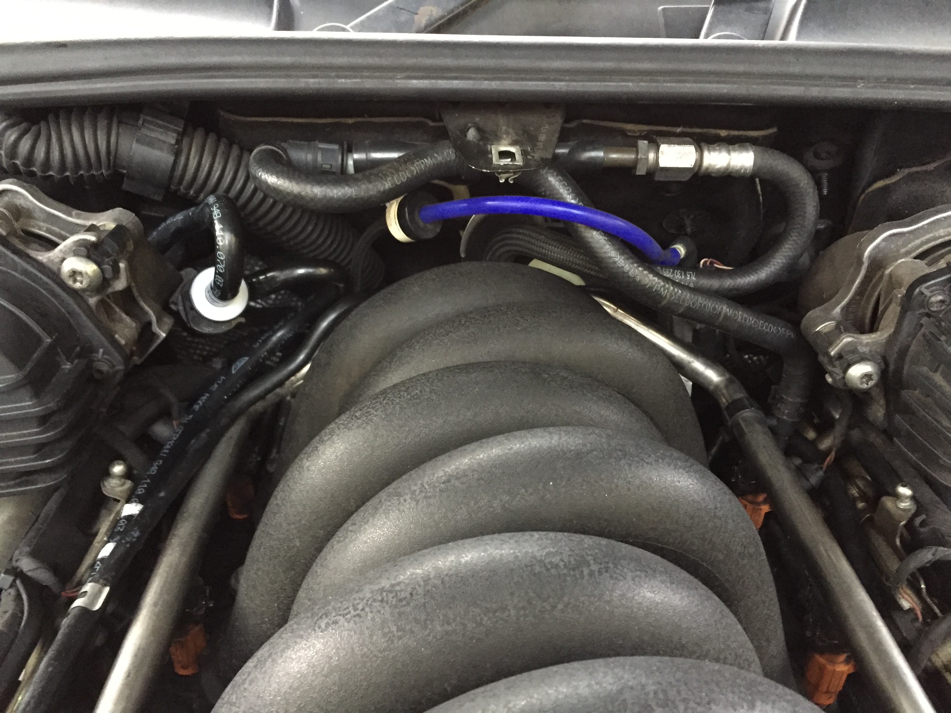

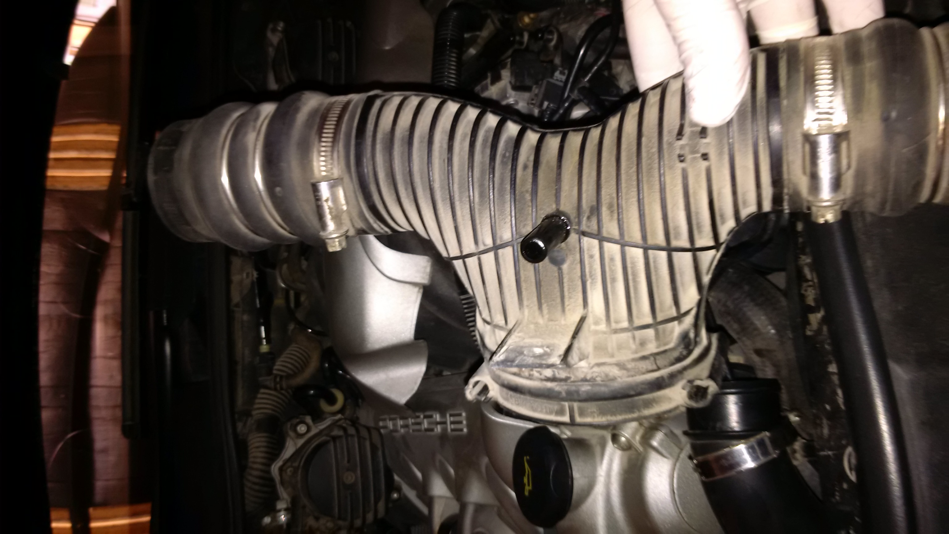

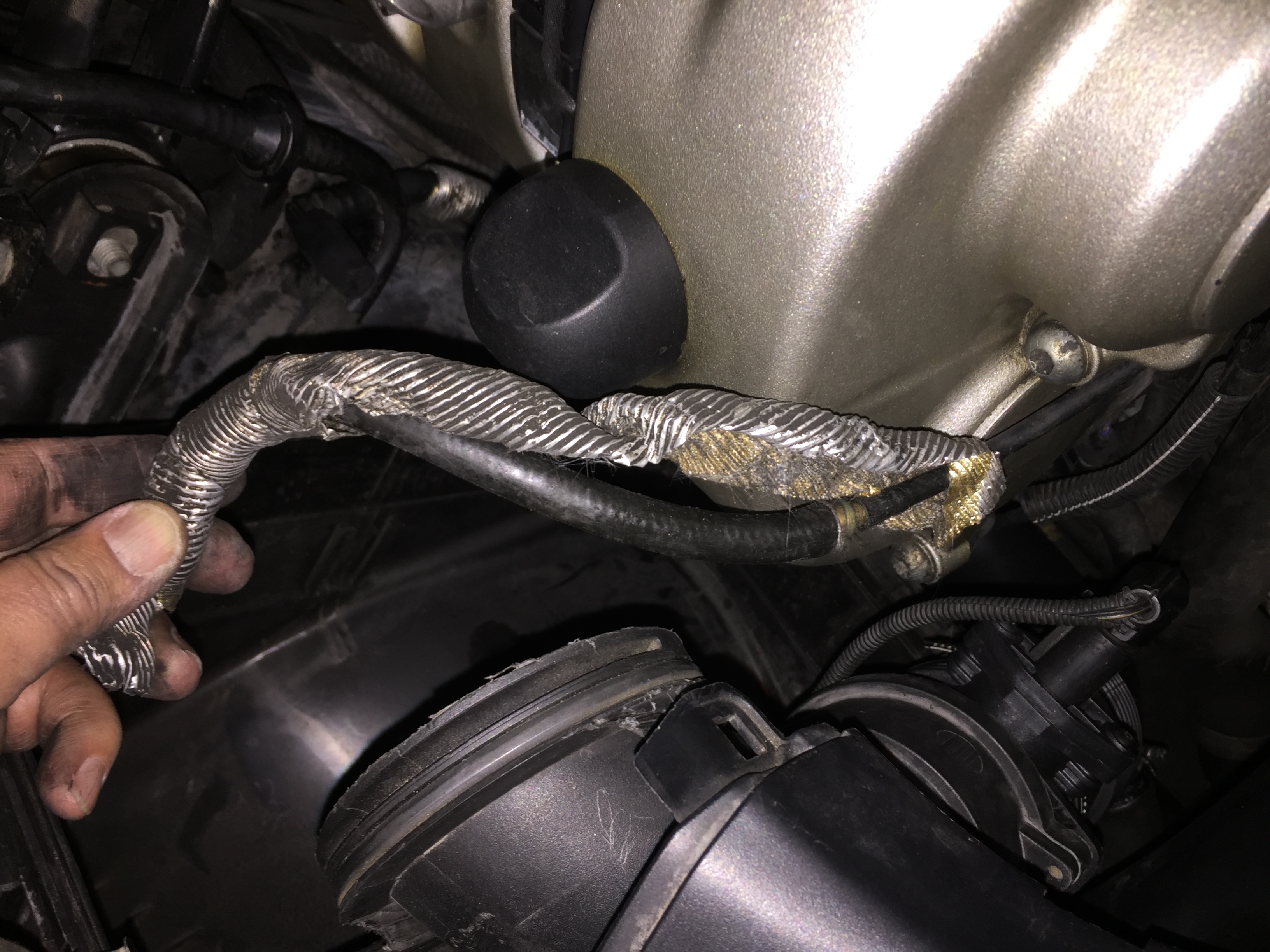

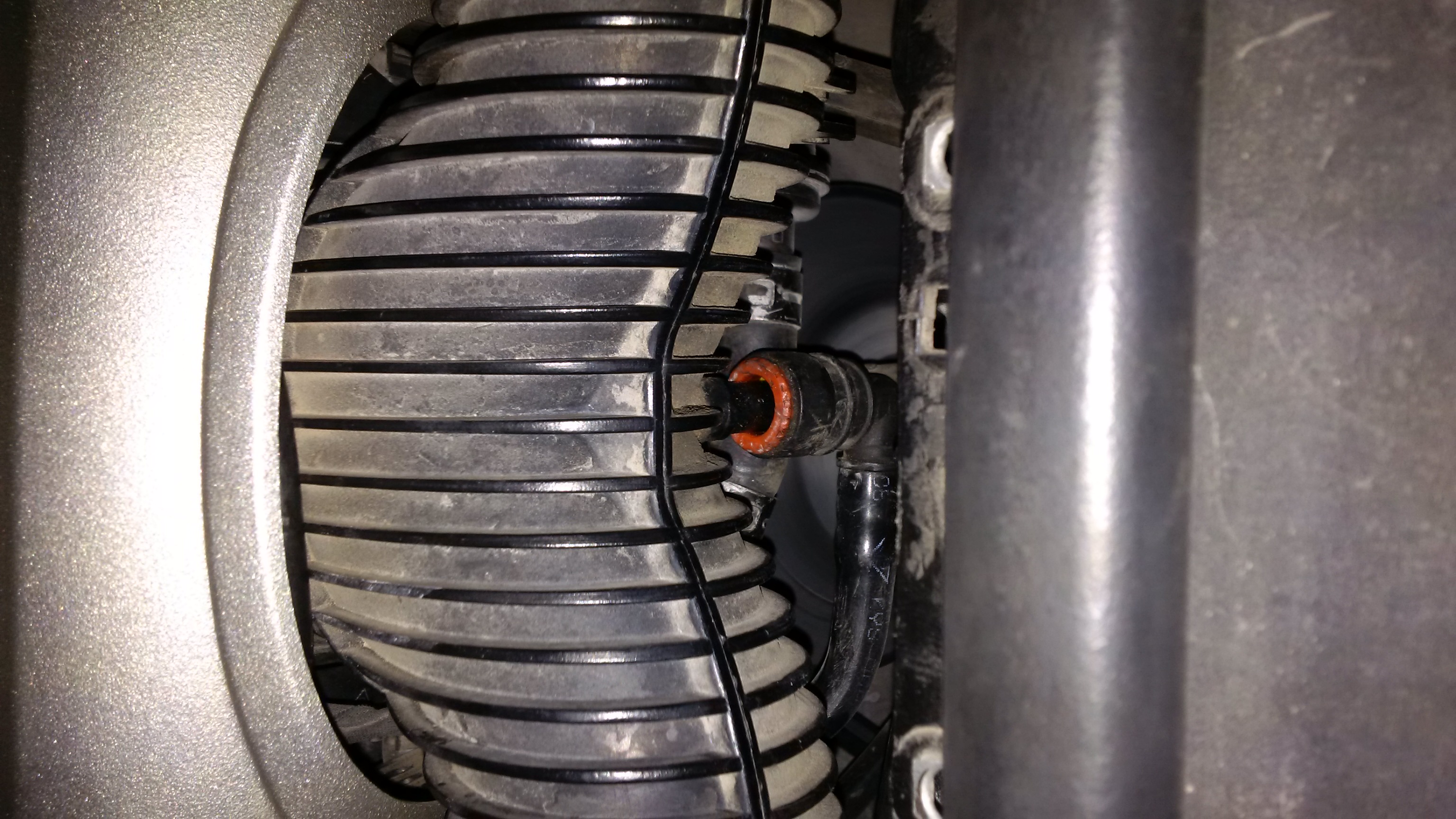

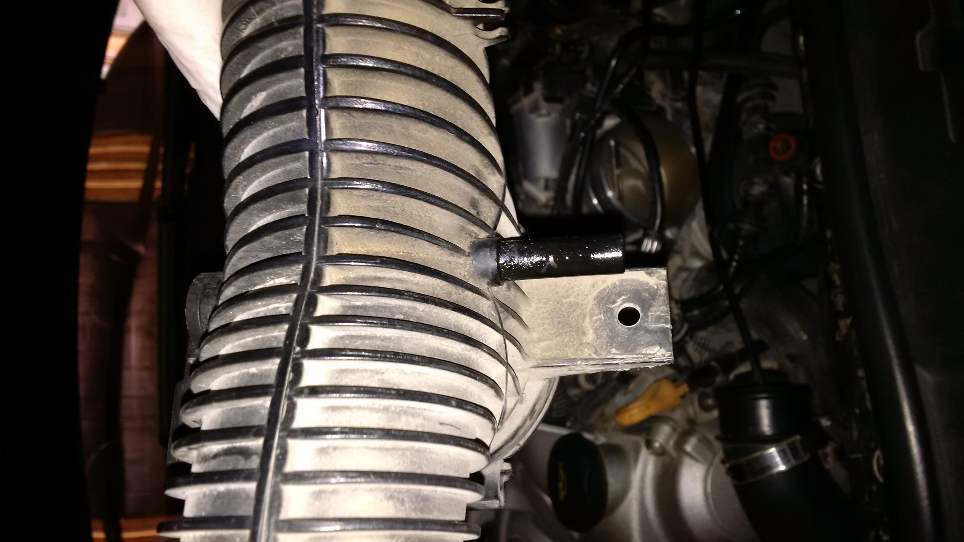

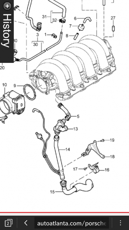

You guys have a lot of experience with the hoses up top, and I was hoping you could help – this is where my venture tube attaches to the Y pipe. Is it supposed to be on more? So is where the red arrow is supposed to be all the way up at the blue arrow? Or is there supposed to be some space? There is obviously some oil leaking there, and it looks a bit crooked.

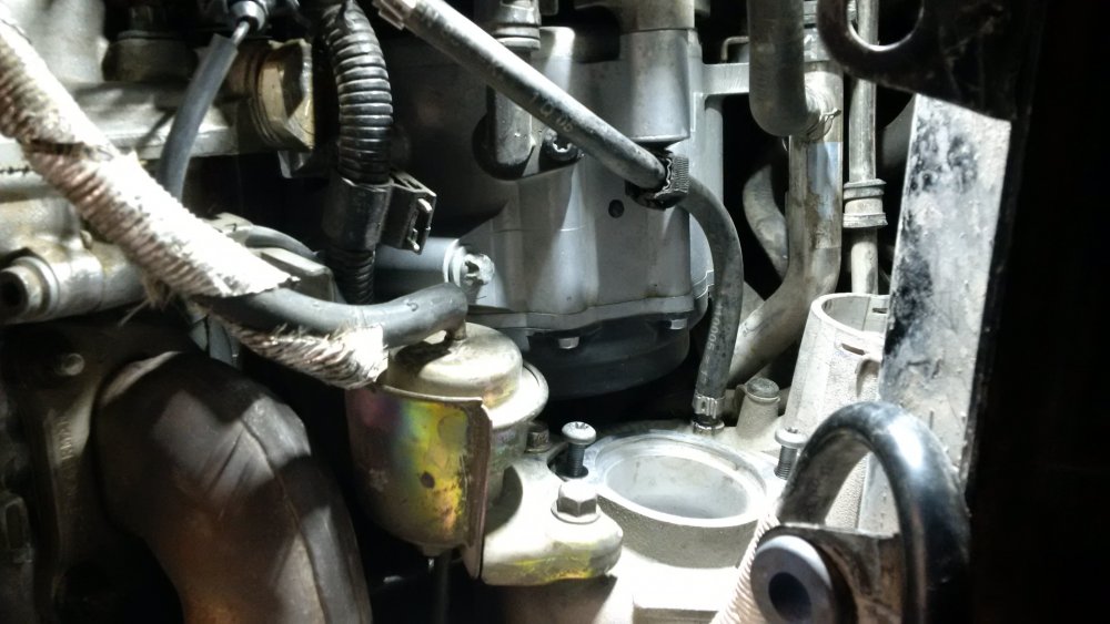

Also, if you follow that tube back where it runs near the fuel rail it is rubbing on a bracket (at the arrow), which doesn’t look right either. Is yours like this? I can’t push it on any more without taking things apart, and I don’t want to break anything because it is really jammed in there. Thanks.

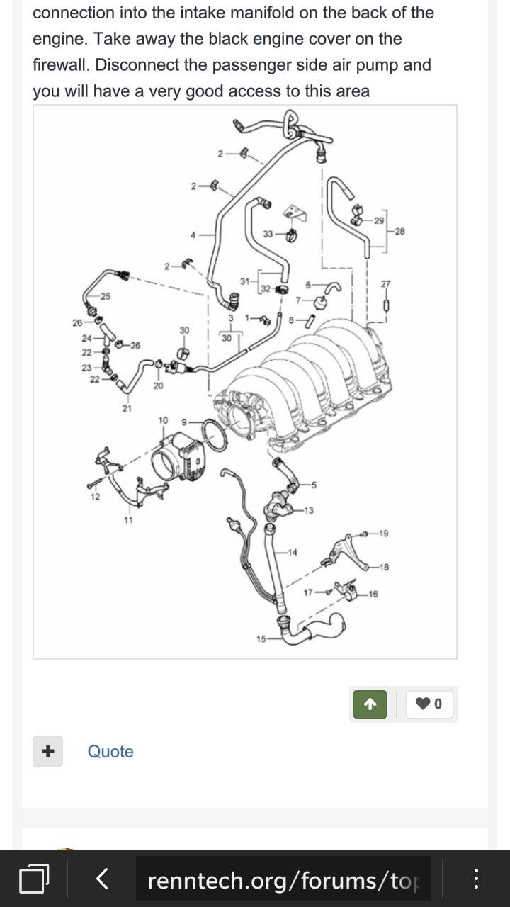

Here you see the tube.  Going along the fuel rail to a connection into the intake manifold on the back of the engine. Take away the black engine cover on the firewall. Disconnect the passenger side air pump and you will have a very good access to this area

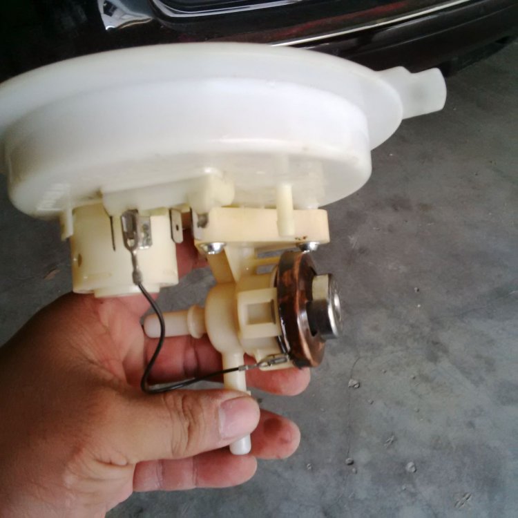

Well the New filter and regulator is installed. Job went smoothly enough I had very little fuel in the tank which was advised.
The old filter I cut open as you can see in the picture and guess what it looks very clean to me, I would say it's not that old. The regulator looked older and had more dirt around it and the connectors were tight as F*** .
The pipe elbow arrow red is a push fit type and mine does NOT go all the way up, the Y pipes spigot arrow blue is LONGER than the the pipe elbow push fitting so this looks correct to me. But it's leaking for sure.
The (part no 25 on diagram) pipe running horizontal in front of it is not supposed to be there, it supposed to be behind the elbow push fit pipe! There is a plastic tab moulded into the bottom of the Y pipe which the horizontal pipe sits against and stops it rubbing against the water pump pulley. I expect that the horizontal pipe is pushing on the push fit elbow and making it leak or has damaged the push fitting already.
Take the Y pipe off rearrange the pipes clean and refit. If after some km it's dirty and oily again bingo it's leaking 100%.
Also whilst running after re-assembly spray some carb cleaner on it and listen for the rpm rising.
Usually it will leak under boost and push out oily air then the oily air deposits collect dust and make the mess you see now.
