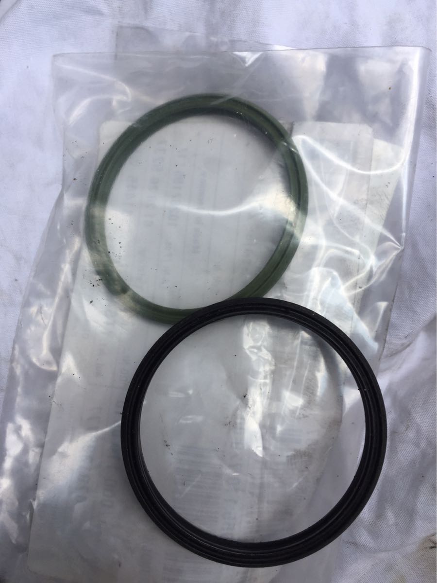

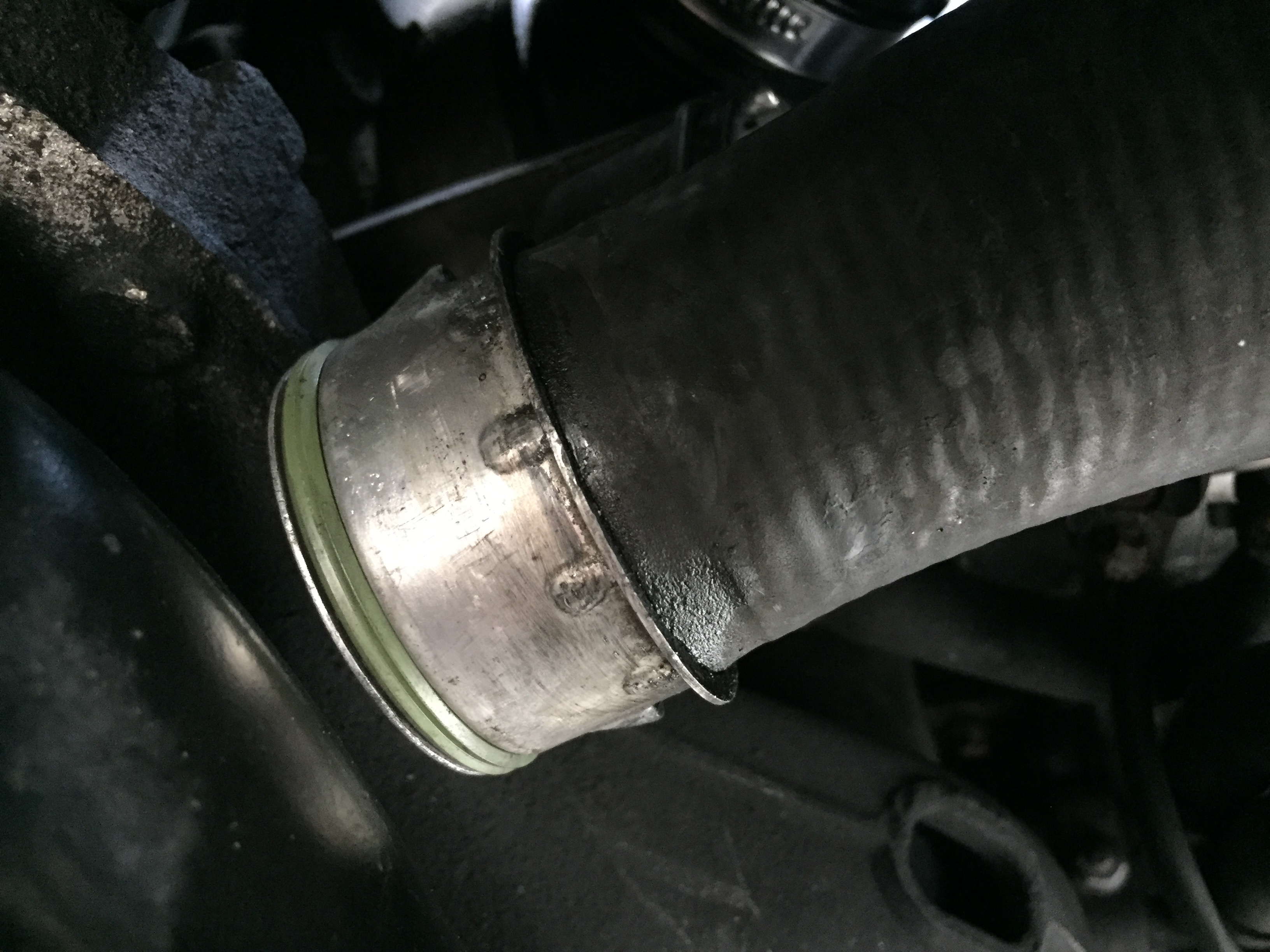

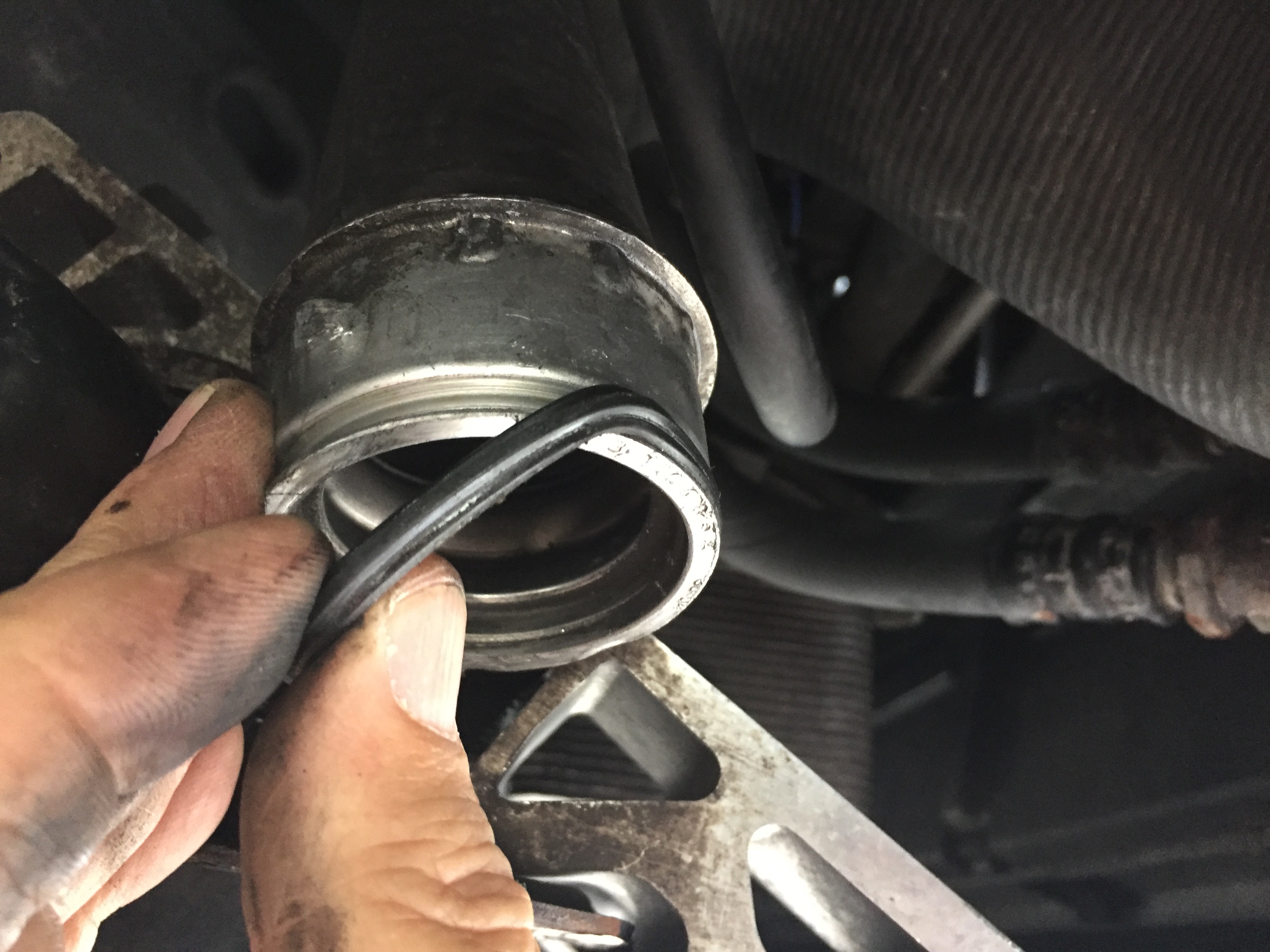

On the way to find the leak i change the Turbo Charger to Intercooler Hose Seal / passenger side / which is sitting next to the Charger outlet. Was easy. No oil inside.  Testdrive. The same.
Wastegates not possible to reach from underneath and not through wheel housing.
test drive. Noise still in place.

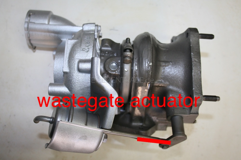

I am pretty sure the noise/ pressure relief is coming from the passenger side. Driving through a tunnel with open windows make me believe it's something on the right side.
Seal on lower tube is changed
Pressure hose to wastegate changed
Is it possible to get access to the wastegate linkage like on the picture (pics from member @danyol)
There is another pressure hose which is going from n75 to charger housing.
