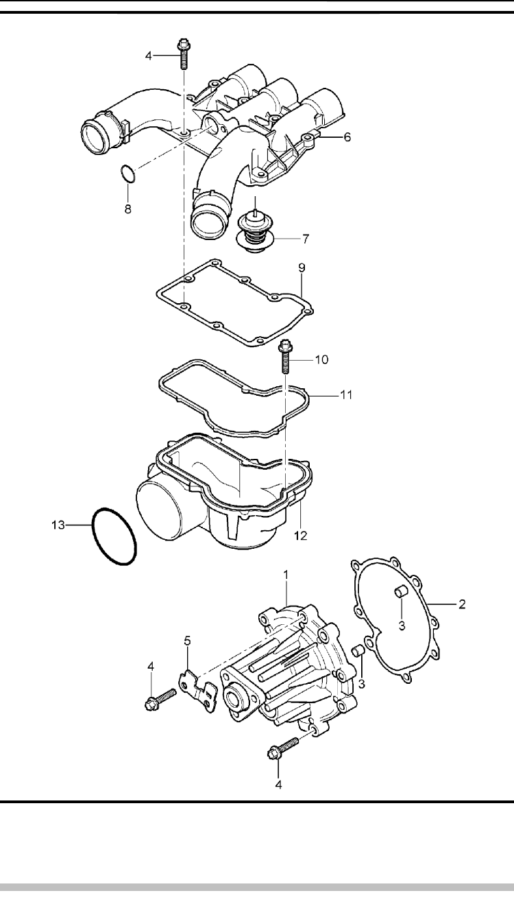

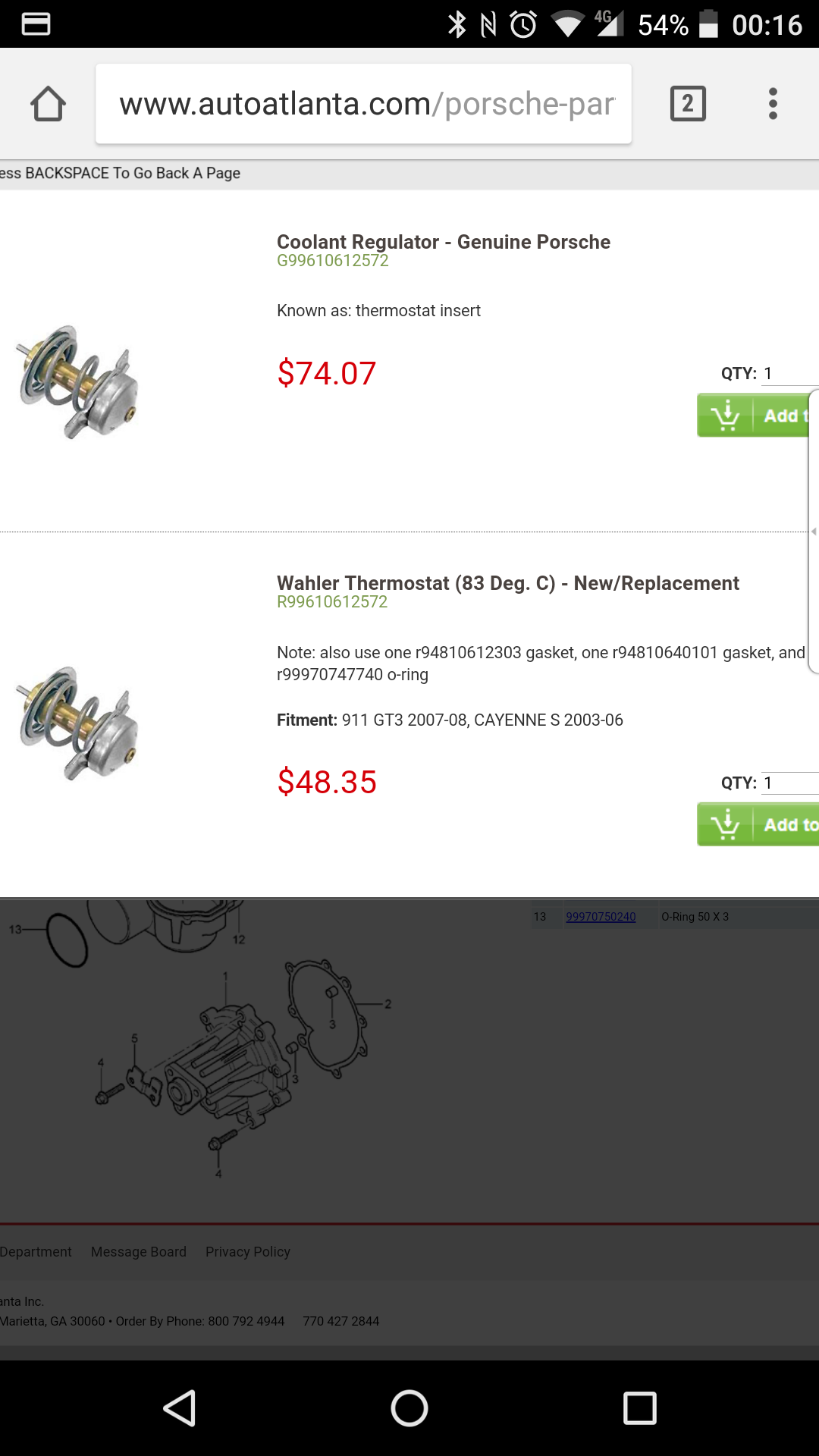

i always believed there must be an air pocket which is causing my high temp but many of you point me to the thermostat.
looking at the parts diagrams I can find two numbers.
What's the difference? Can somebody help please.
Is the part for the Cayenne s and the Cayenne turbo equal?

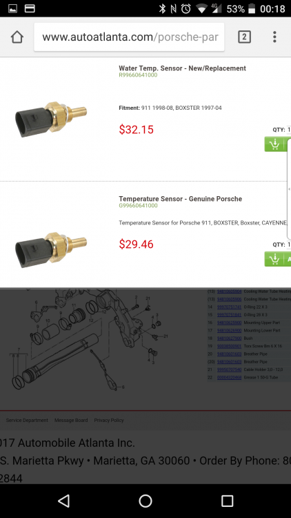

Second question, where is sitting the temperature sensor ? Can't find it.
Thank you.
Thank you.
Temperature sensor is at the back of the engine very hard to see and access, this is not your problem Thomas.
The thermostat is a superseded part and ends with 72 not 70 the old part.

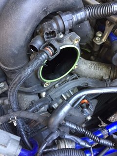

Take all my courage and try to fix this
by myself. Was actually easy but there are always some small things which dont work well and taking time and nervs.  Finally i changed the thermostat. I didnt take out the cooling tubes. Just lift it up on the front to change.
Unfortunately the temp problem is still there. Its just 25 degress outside but when the car stay in park for some time with engine running the gauge is showing very soon 100 degrees
