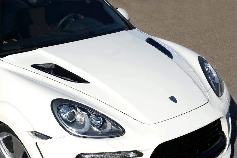

cutting some slices into the hood to get a air scoop for better fresh air Access (i was really thinking about it :-)
When you consider the max summer ambient temps in Germany are fairly average compared to other regions it doesn't make sense your cayenne isn't able to stay cool.
Are you still running hot Thomas?
You shouldn't need this to keep the engine cool, but if for a style upgrade then it looks pretty cool.

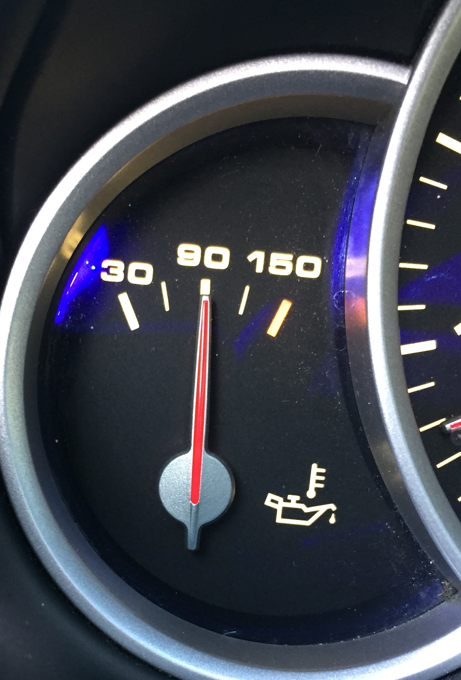

i did a test this evening. Outside temp 22 degress. ICarsoft OBD Tester
first of all some guys here are right. Our oil temp gauge is a toy tool.
mine stay always at 90. doesnt metter which temp outside and how i drive. Measuring with the tool = 107 degrees
gauge = 90 degrees
water is the same :
the OBD reading is always HIGHER than the gauge.
I let the car idle at 570 rpm for some minutes
water temp according OBD = 96
water temp according gauge = 90
Edited by ekstroemtj

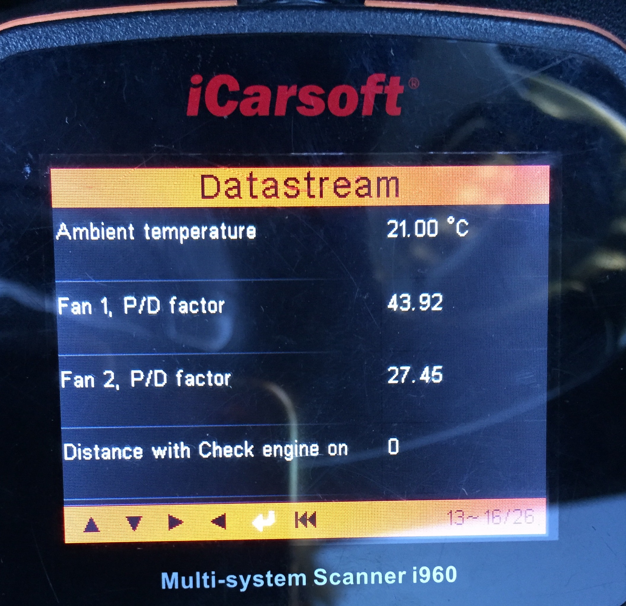

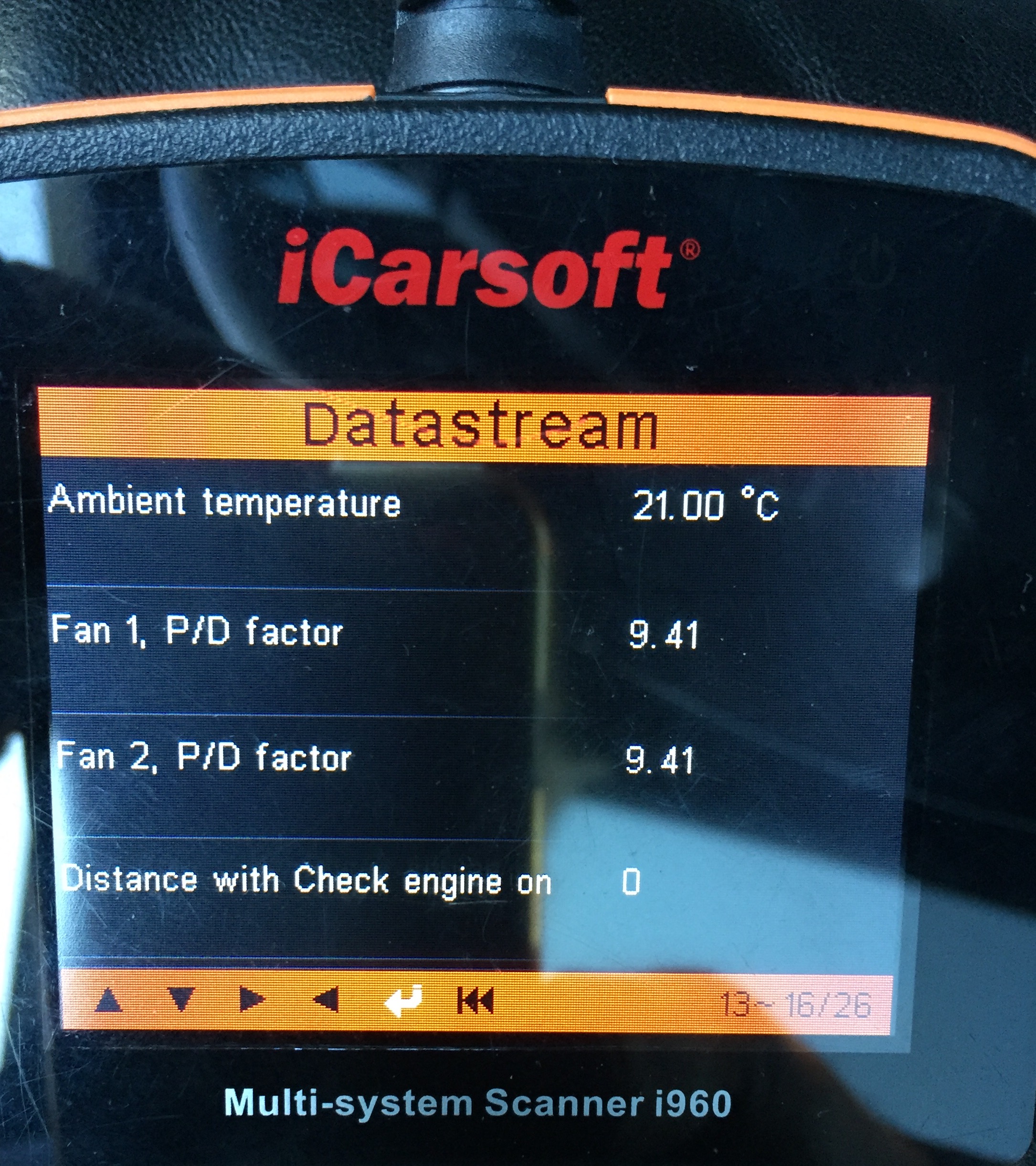

JFP...You are a pro. Maybe you have idea:
when i had a more close look to the OBD numbers while hunting for the high temp reason the tool showing some infos about the fans which i cant get on context. Google couldnt help too.
maybe you have a clue.
Fan P/D factor, what this number should tell me?
While I am not conversant with the iCarsoft  system, your radiator fans speeds are controlled by an electronic system (Pulse Width Modulation) that can infinitely vary the fan speeds by varying voltage on time instead of the old multiple resistor system, I am assuming that is what the tools is displaying, possible as a percentage of "on time", the more on time, the faster the fan speed.

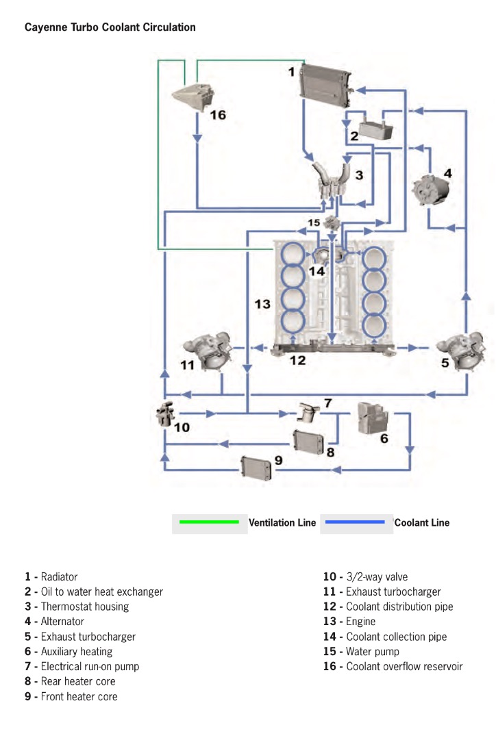

The electricel circulation water pump is running all the time?! This could be my problem too. Somebody know where this part is sitting? On the diagram cant see well. I read somewhere behind the weel housing?!
The pump is located behind the drivers side front wheel arc liner.
2 minutes ago, ekstroemtj said:
@Lewis thank you. Possible to hear if it's working?
Maybe, if the car is very hot and had hard drive then you quickly pull up and switch off the engine in a quiet area you may be able to hear the pump running. Put you ear against the front drivers wing any humming or noise is for sure the pump running.
If the DME doesn't think the car is hot and been pushed hard it won't run the pump. So you need to drive it hard when already at normal temp and then pull over quickly and switch off immediately.
