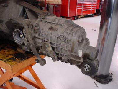

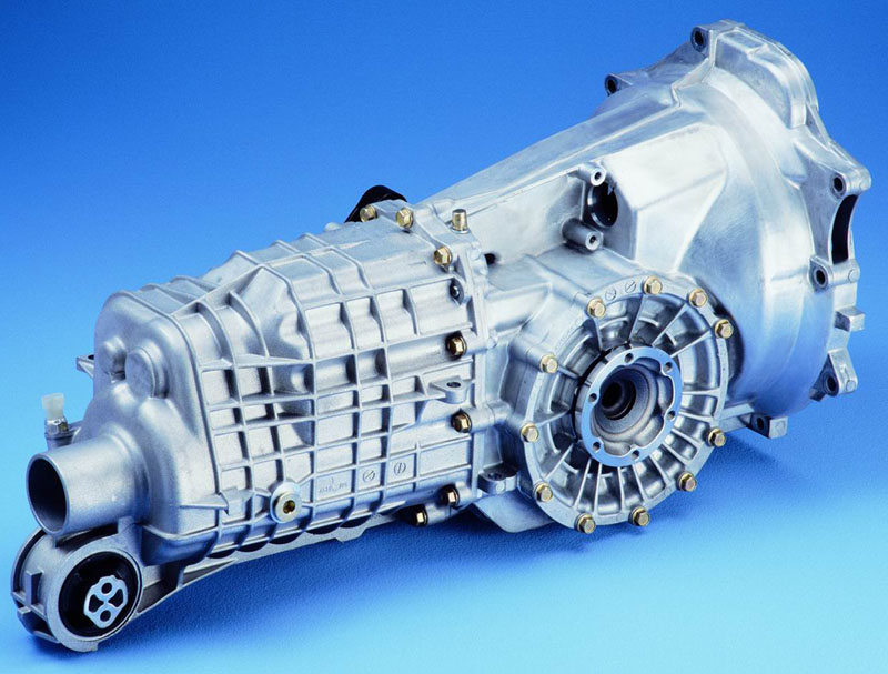

Loren, thank you for your nice picture.

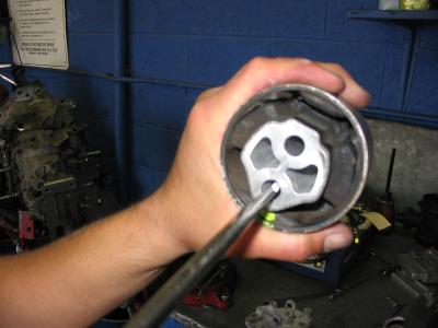

Please see these pictures for the detail.
1. The end transmission mount
2. Broken robber inside the bushing.

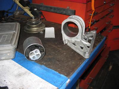

3. A Boxster parts, you have to buy the whole set (bracket + the mount) and
press out the mount unit to use it in my 996.
The robber in bushing is very easily broken which will cause the Engine and transmission vibrate and more damage can be happen if ignore this problem.
Porsche should do something improvement. And they should make this parts available.

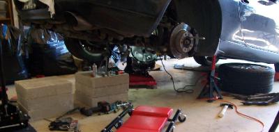

Here's my real problem. I didn't anticipate needing to replace this when I dropped the transmission.
So I didn't jack the car up high enough to get the gbox out from under the car. So I'm going to have to lift it
off the jack while under the car, slide it out, cart it to a shop, have them press in the mount, then lift it back on the
jack while under the car, and try to realign everything.
Did I mention I have noone around I feel comfortable asking to help me with this? I've disassembled myself into a corner.
My other option is to roam arount Home Depot and try to build some kind of tool to pull the mount in while under the car.
Or use my big metric hammer, and hope I don't destroy it.
Anyone ever replace one of these without using a press? :help:

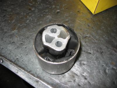

Yes and no.
If you jack the car up and get your face right up to it and fold back the
soft rubber gasket things you can see most of it. If it's completely broken
you'd be able to see it.
Notice the picture of the broken one with the screw driver. In order to say for
certain that it's not split you'd probably need to do that on both sides.
The drivers side of mine looks fine, but if you pry on the passenger side you can
see the front side is split nearly all the way through.
