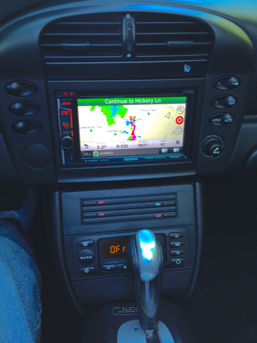

I did the opposite with my '04. My hvac controls were at the top, and I had them moved to the bottom when a double din radio was installed. Starting from the top just below vents the order on my car was:
1. hvac
2. radio
3. cd slots
4. open bin
If yours is currently in the upper bay of the lower console then I don't think you need any "parts" except if the very bottom bay of the lower console is involved. To move the hvac to the bottom a part had to be ordered from Porsche to surround the hvac control.
The photo you posted confuses me, is this your car or what you want yours to be?
This is how mine is now:

Thanks! The photo is where I want the HVAC to be.  My HVAC is currently exactly where yours is.  I am ultimately going to remove the entire lower console to make room for my leg.

It shows a tip for removing one of the ventilation system ducts that makes moving the control easier.  It also shows some photos that I took when I had my center console disassembled.  I moved my controls down to make room for a double DIN navigation unit. Since the wire harness was long enough to move the control from the top to the bottom, I'm assuming that there is enough harness to move it the other way.  Moving the cable up on the passenger side should be easier than on the drivers side.  You will need to disconnect the connectors from the back of the unit, but when you look at it  the technique should be obvious.
