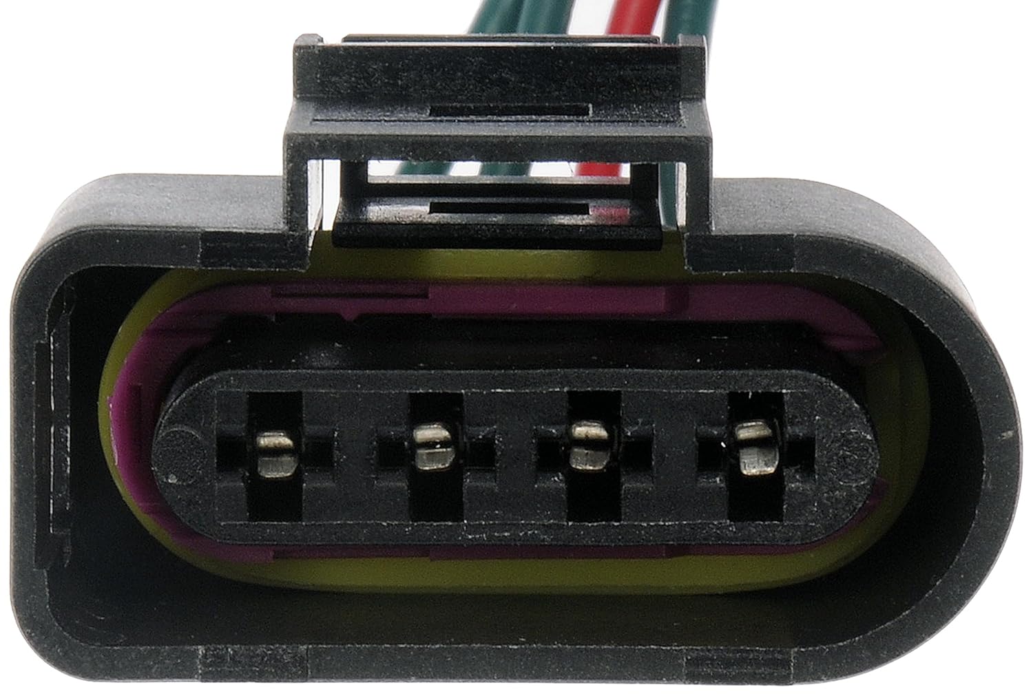

I did some research and it appears suncoast sells the connector, which requires one to reuse existing pins and wirings..in my case that will be impossible. http://www.suncoastparts.com/product/955V8PLUG.html
Does anyone know what style pins or where to order them and the right wire?
