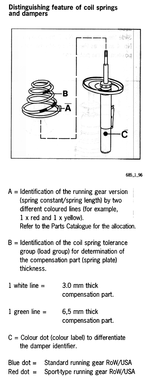

Hi,  I've a Boxster 986 Anniversary MY04. It has the M030 sports suspension. Unfortunately I have a broken front spring so I've ordered a new pair from Porsche.
The coloured dots on my springs is a Blue dot at the top & a red & yellow one at the bottom. The ones I've been supplied with just have a red & yellow dot at the bottom of the spring.  Could someone tell me if this correct? The part number I have got is P986.343.531.15 50.
