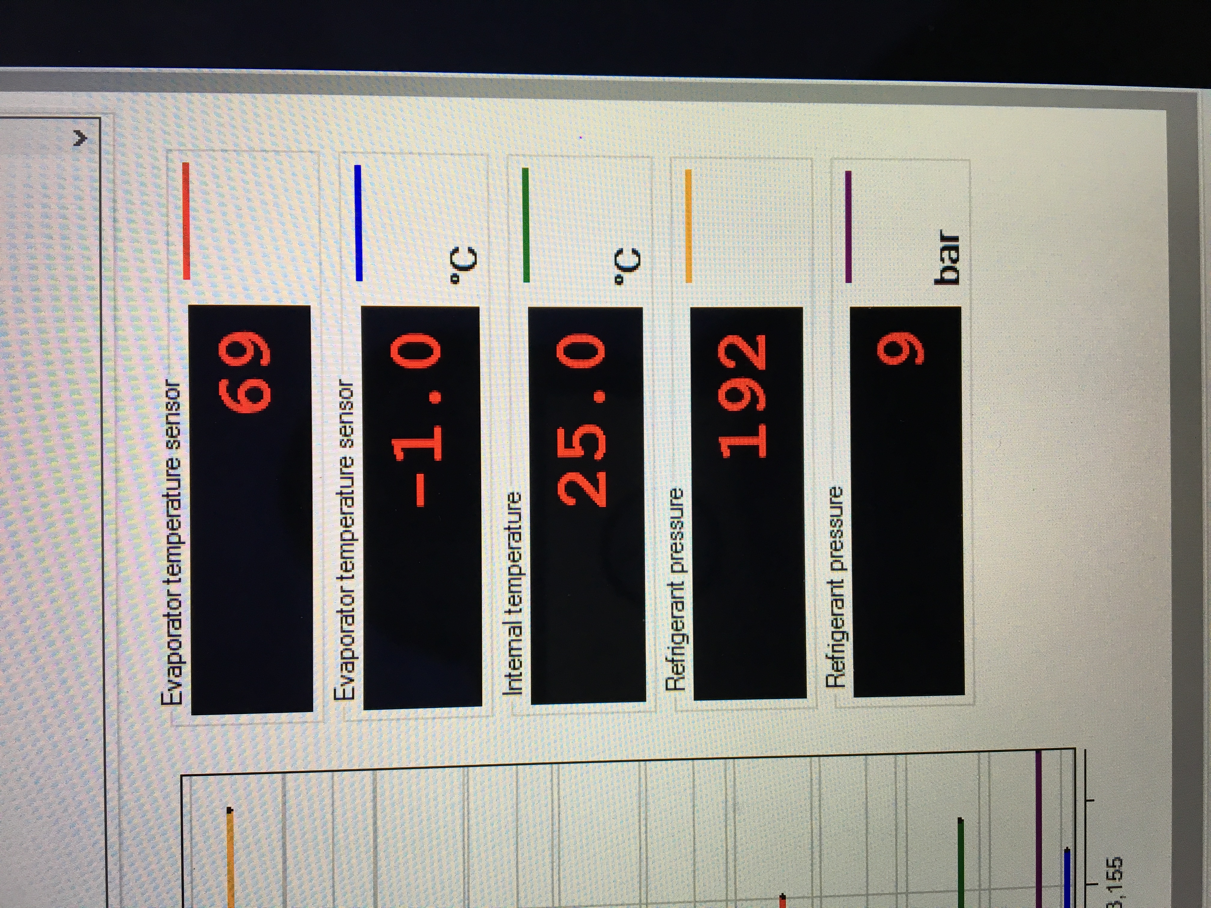

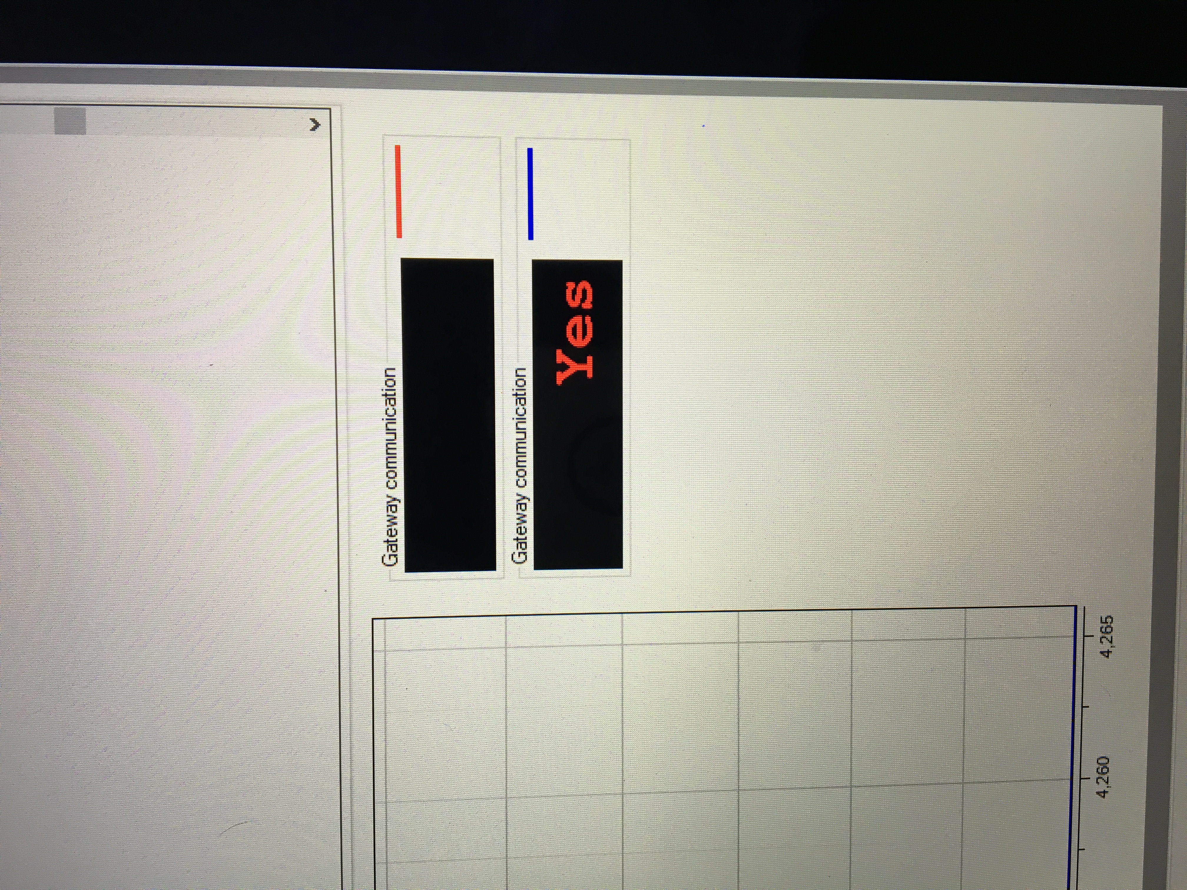

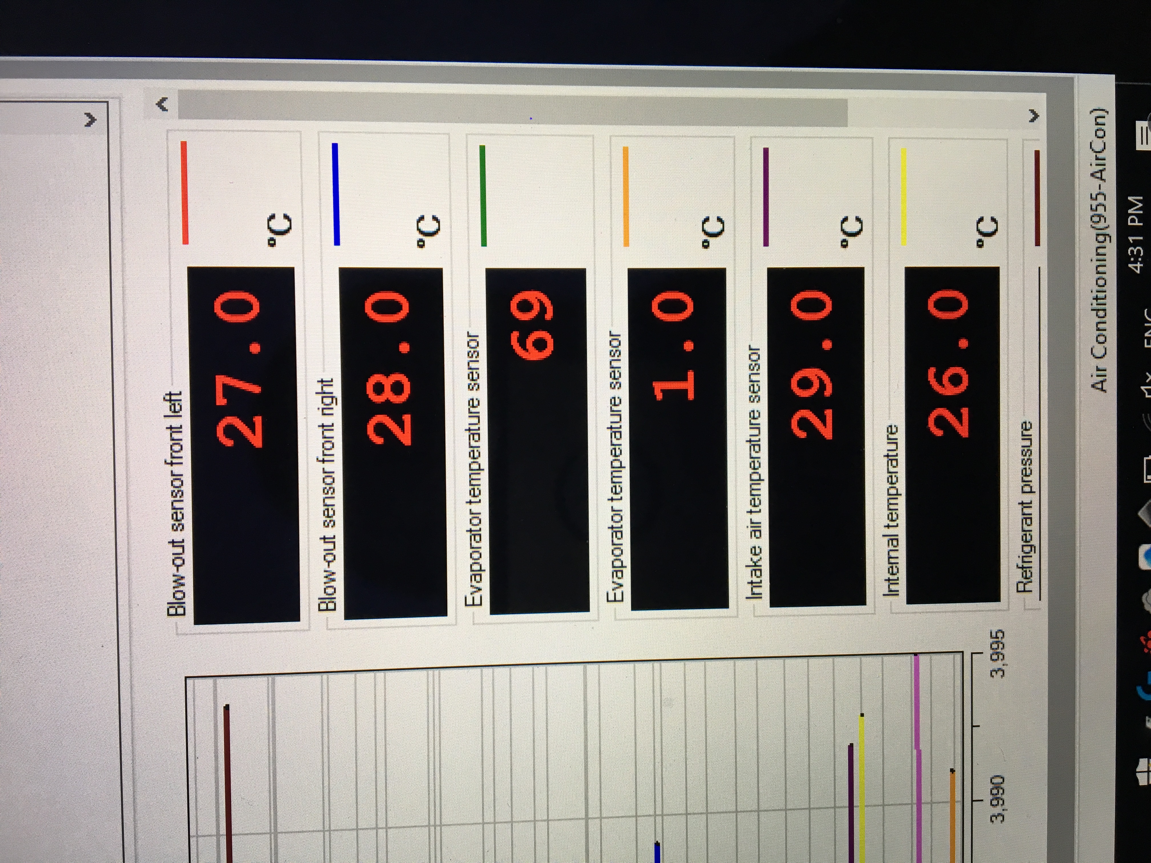

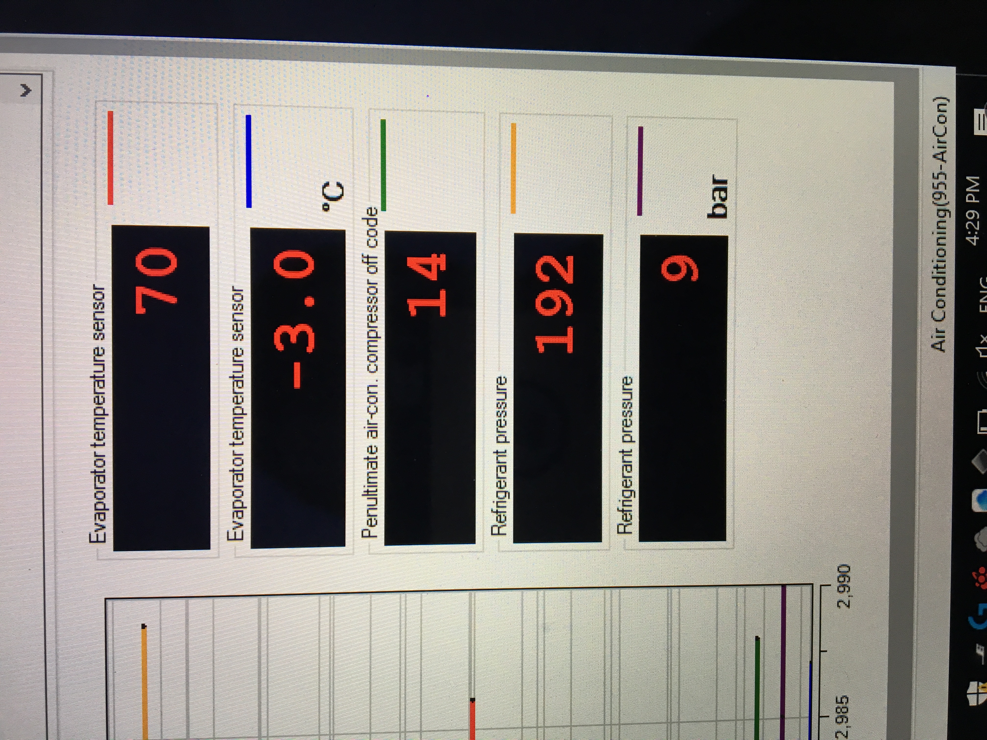

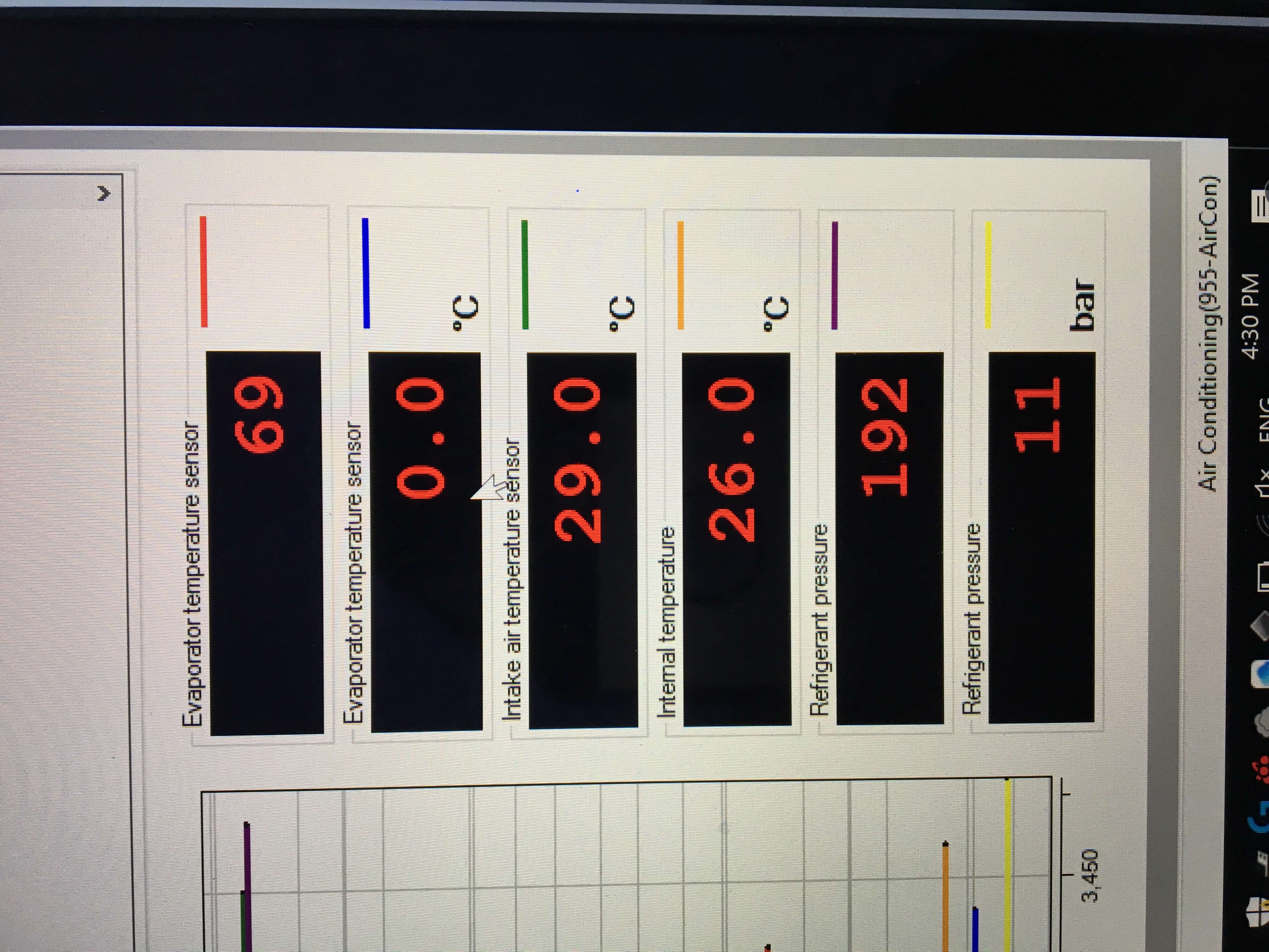

I have a 2006 Porsche Cayenne S, and my A/C is intermittently working. Everything works fine on the dash, just does not blows cold all the time.
I have scanned for codes with my Durametric, and the only code in the A/C is: 1299 Implausible Gateway signal. I have cleared the codes, but it immediately comes back.
Upon looking at actual values, engine shows A/C Compressor OFF & Refrigerant Pressure shows 192. I have replaced the A/C compressor with brand new, no change.
What else do I need to check to diagnose this issue properly? Any help would be greatly appreciated. Please advise.
Readings from Durametric tool. Upon looking at actual values, engine shows A/C Compressor OFF & Refrigerant Pressure shows 192 & 7-10 bar. At certain times, the A/C Compressor will show ON and A/C blows great. I have replaced the A/C compressor with brand new, no change. At times, the Air Quality sensor value says 0 and others it says 1. At one point, I was pretty sure once it said 1, the A/C started blowing cold, but cannot confirm that for sure, usually always says 0.
What else do I need to check to diagnose this issue properly? It appears something is causing the A/C compressor to command OFF instead of ON, just not sure why.
I'm not familiar with Cayenne at all but your evap sensor readings are all around -3~+5C, which can't be true if the a/c is not operating. I wonder if the sensor is reading low temp falsely and that prevents the a/c from turning on...because the evap temp is detected as very low (when in reality it's not).
