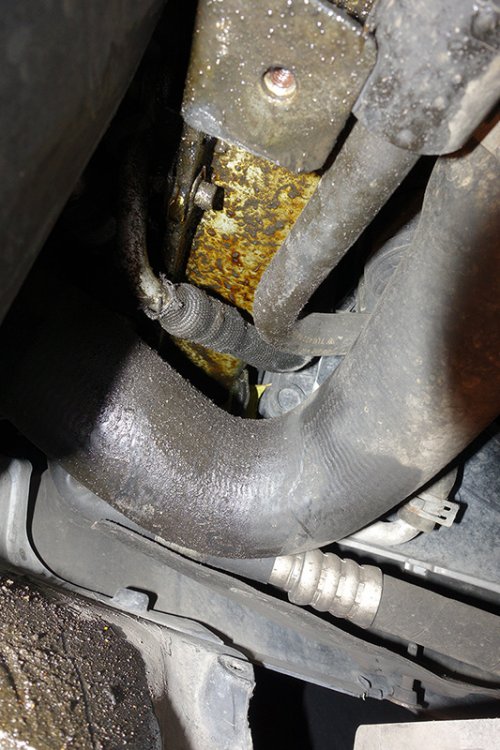

It would not be my first choice to get it apart but you could try with a screw driver   Go into the gap which is already there or use a coin. Try.
Or like you say you want to disconnect it from the turbo.  I had to do it because my air hose was broken.
little bit more work. Take away all the plastik protection under the car.  Or you take away the wheel well liner to get access to this place.
Lewis would say.... when you are there you can check the connections of your DV and the tubes and hoses arround for any visible leaks or damages.

The oil on the right side indicates pcv carry over. You need to test your three way check valve and AOS diaphragm. Also you need to remove the lower turbo to intercooler pipe drain the oil clean it and replace the o-rings they are a few dollars only. (this is likely where the oil is leaking from that hose and them o-rings).
Then sadly you need to clean the Maf sensor that side again and the MAP sensor and the throttle body them do adaption with software (first also clear dtc now to erase fuel trims and learnt values) or if no code reader disconnect battery for 30 mins and after reconnection set ignition to on position with engine not running and let the throttle adapt itself for 60 seconds. Switch the ignition off, then on again and start engine, let it idle for at least 5 minutes and it will be adapted, then go for a nice long drive with cruising and high speed wot bursts. If after all that you still have problems then need to look further into sensor malfunction ie maf or o2 plus more likely vac leak on a pipe somewhere.

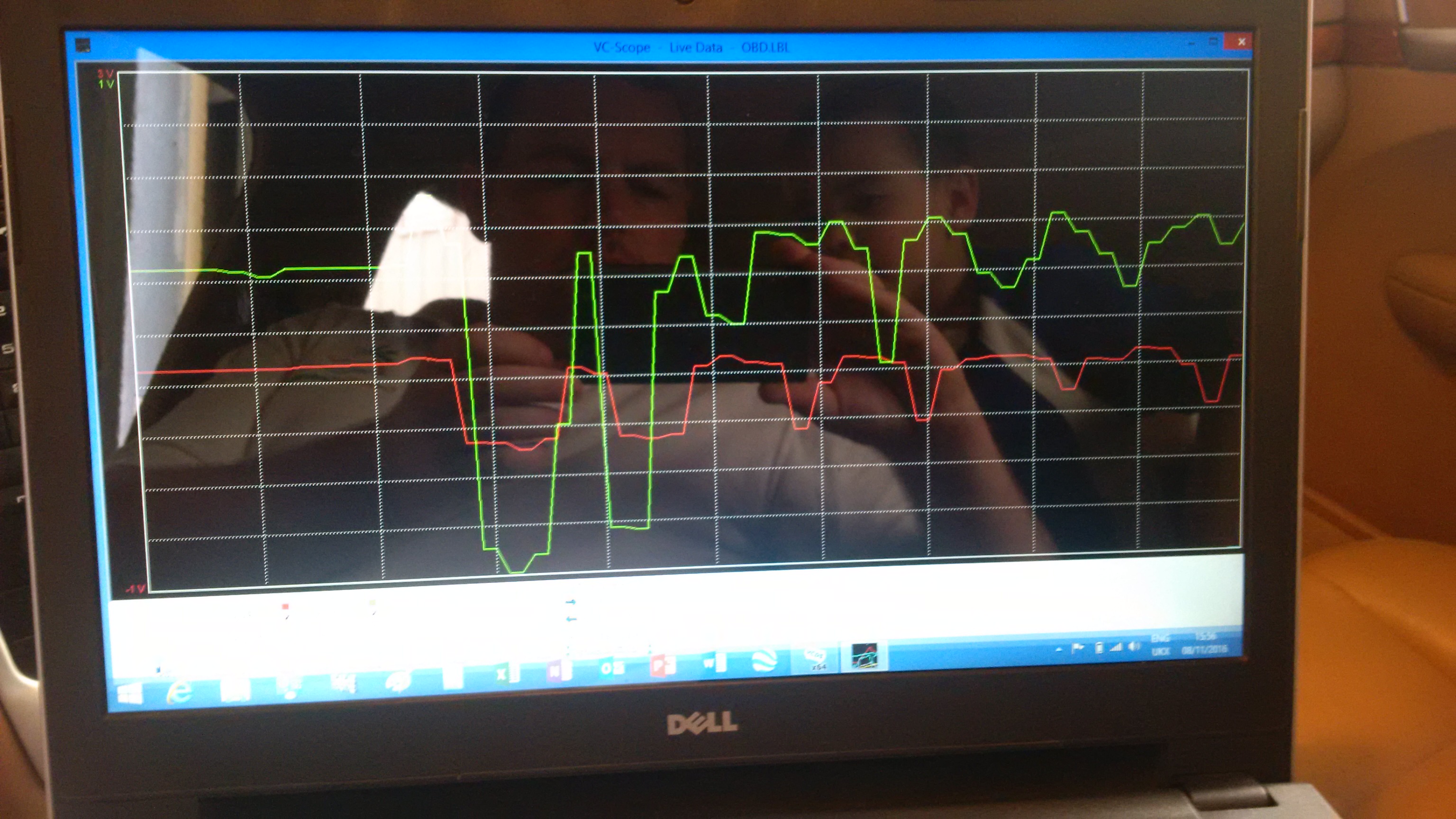

Here is the post cat o2 sensors graph bank 2 in green is not as Controlled or stable as bank 1, but when I looked at bank 1+2 precat o2 sensor they are perfect steady almost flat  line holding  lambda 1v and revving produces fluctuations consistent with  what would be expected. Even holding at 2100rpm the car shakes as it's obviously not happy but the data still says nope I'm perfectly fine with this carry on as you were. Ffs. Why why why
So as the condition of the cat and post cat o2 sensor output has no feedback loop it doesn't dictate the engines running I guess this just means one cat is worse than the other? Help
Long term Fuel trims are -0.8 and short -3.1. So I'm slightly rich no biggie?
