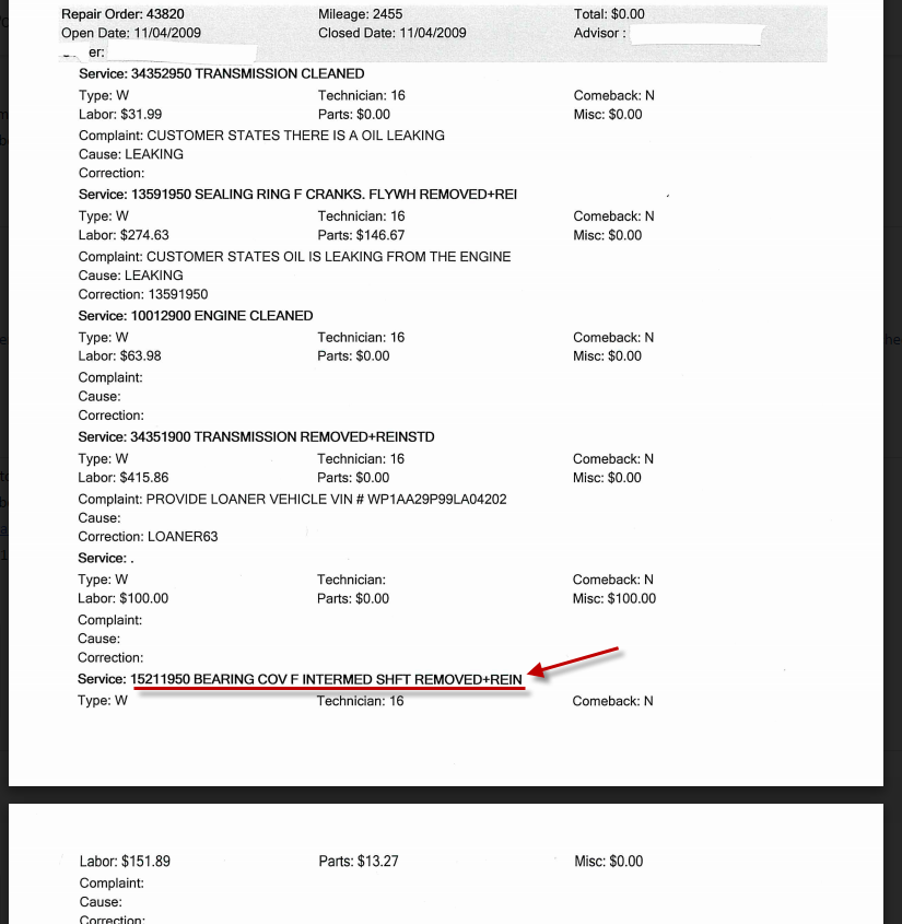

I'm in the process of vetting a '06 C2S for purchase and I'm hoping that someone here can help me decipher a Porsche service record that I think might be related to the infamous IMS bearing issue (hopefully not).

We have seen this before.  Some of the cars had leaking seals on the IMS flange cover, which Porsche replaced under warranty.  But they only replaced the cover, not the bearing.  In addition, as the car is an 06, it carries the oversized third design bearing, which cannot be removed without disassembling the engine.  And before you ask, yes, the third design still are subject to failures.
Thank you for the reply. During the PPI on this car, the inspector notes that there is light oil seepage, possibly from the crank seal. He states it's not a "leak", but I'm starting to get a bad feeling. The car has less than 16K mi and beyond this issue, the PPI checks out solid....but if that IMS bearing hasn't been getting proper lubrication....If you were in my shoes with this info, what you do?
You are at a "toss up" cross road.  The oil leak could be from either the RMS or the IMS cover flange (they are both known to leak); both are low cost parts items, but the big money is getting at them (the trans, clutch, and flywheel have to come out, which is about a $2K shop bill).  And if you had this done, you could have the rear seal of the IMS bearing removed so that it can be oil lubricated going forward (we have done many of these, it seems to help the bearing long term).  If the rest of the PPI is good, try knocking the price down to reflect the expense to fix these issues; if the seller bites, you are golden; if he balks, move on, there are other cars out there.
And an oil leak from the IMS flange does not mean that the bearing has not been getting lubrication, it is a sealed and grease packed unit that happens to be partially submerged in oil, which is why the flange can leak.

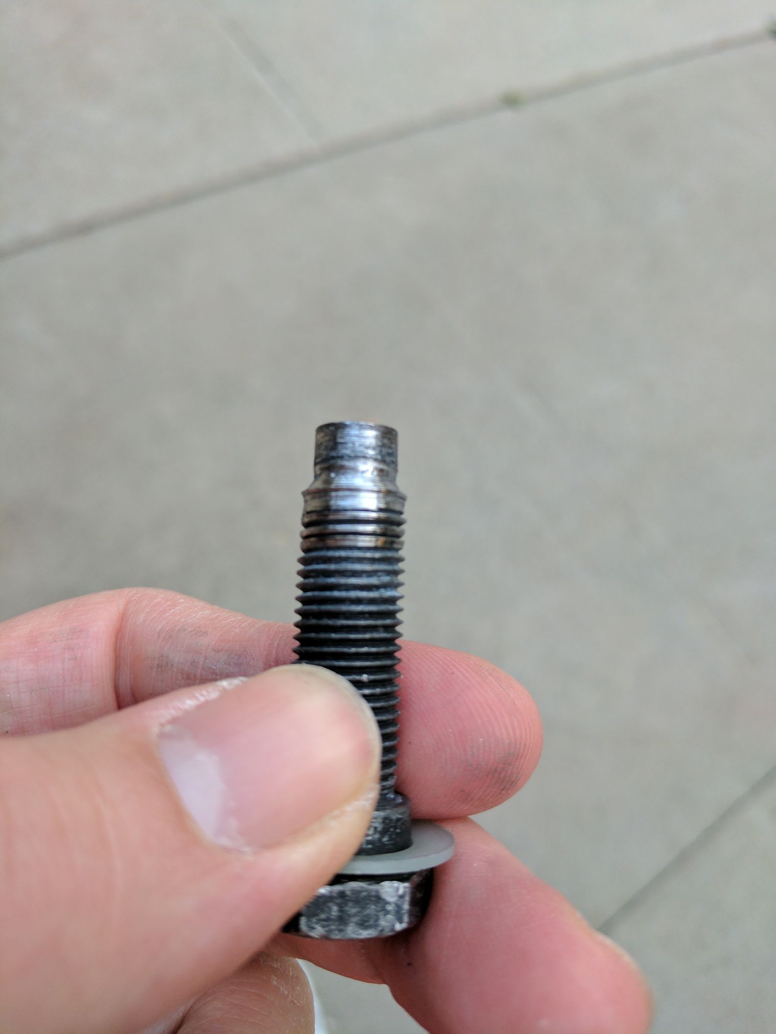

The second issue is more troublesome which is a stripped out lower seatbelt mount. After driving the car for awhile I noticed that the drivers side seatbelt was a little rattle-ly and upon inspecting it closely I found that the lower bolt was "slightly" backed out already; this also made me think about why the seatbelt webbing seemed to have an odd twist in it.
I took my 17mm socket and with a little finessing I was able to back the bolt out (had to apply light outward pressure against the washer with my finger as I reversed the bolt). And could immediately see the tip of the bolt was well cross-threaded. (see pics).
Here's the fun part, take a look at the state affairs with the female threads in the rocker area. (pic).
Feedback on another board suggests I *might* be able to restore the female threads with a tap, otherwise needs to be drilled out and retapped for a larger bolt OR use a threaded insert like a Keensert or Timesert. Going to the shop later in the week to see what they can do.
