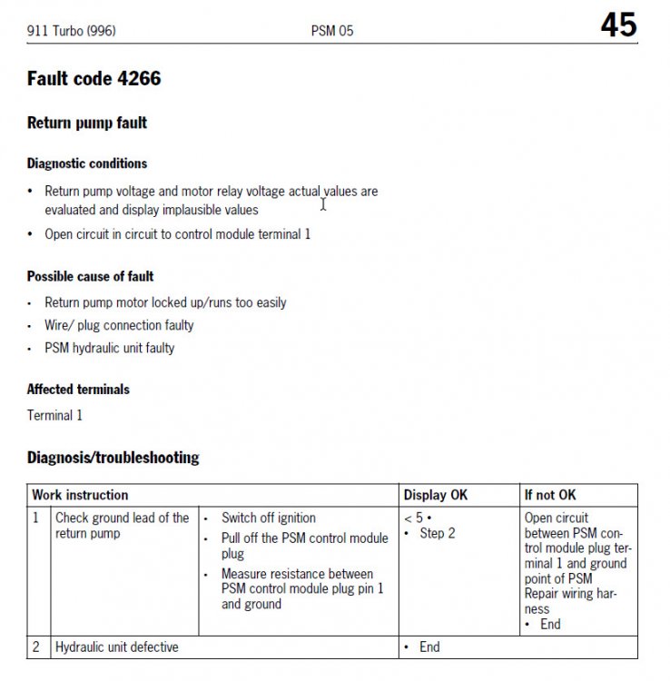

this is the message he gets from his diagnostic software:
Return pump fault
Diagnostic Conditions
- Return pump voltage and motor relay voltage actual values are evaluated and display implausible values.
- Open circuit in circuit to control module terminal 1.
Possible causes of fault
- return pump motor locked up/runs too easily
- Wire/plug connection faulty
- PSM hydraulic unit faulty
