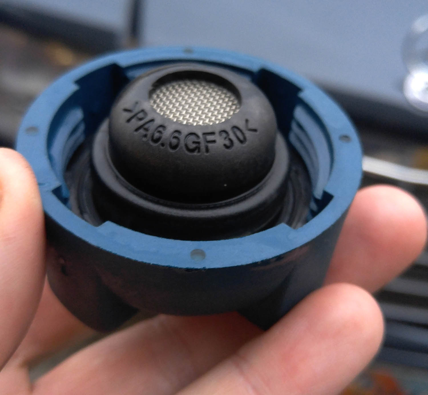

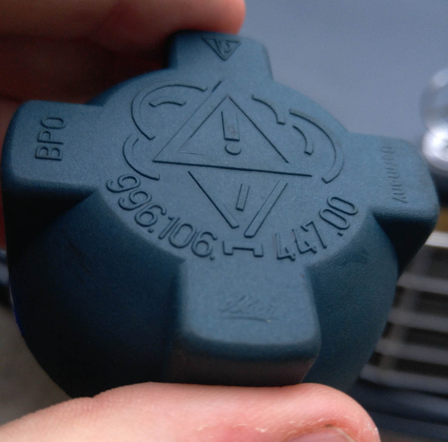

Do you have the latest version of the cap to the reservoir tank? '04' last two digits. If not, I'd start by replacing that.
Edited by wizard
6 hours ago, wizard said:
For peace of mind, my advice would be to get the genuine part from Porsche.
I agree. That said, Loren posted above, the msrp. My local shop is charging about 20% more. Not that it is a big difference in this case, but out of principle I don't generally support businesses that sell above the MSRP. Where can I find the MSRP to confirm.
