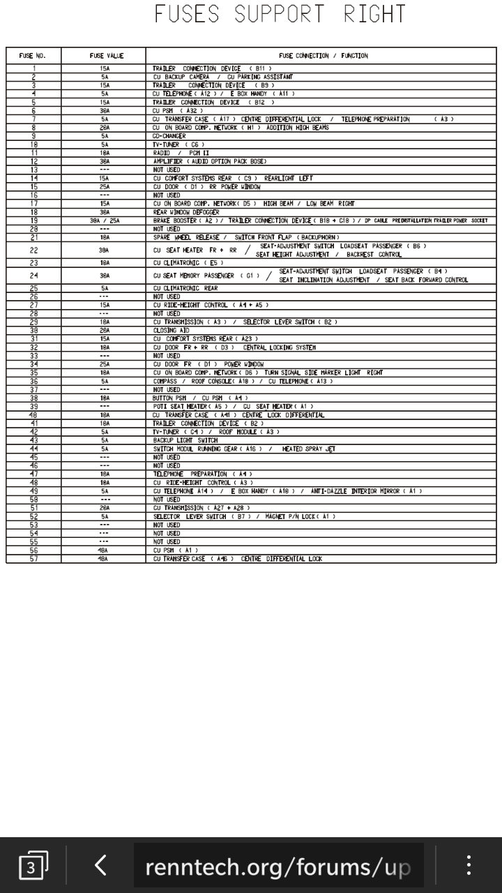

If battery and charging is in good shape it would seem like a module or wiring to module fault. Check the fuses as well 27+48 on the right side dash IMG_20160403_224258.thumb.png.3ecff57a1ca15a9d270ad3373c3c8edd.pngfuse box ! Could be a fuse popped due to another issue and it not the module fault at all!
