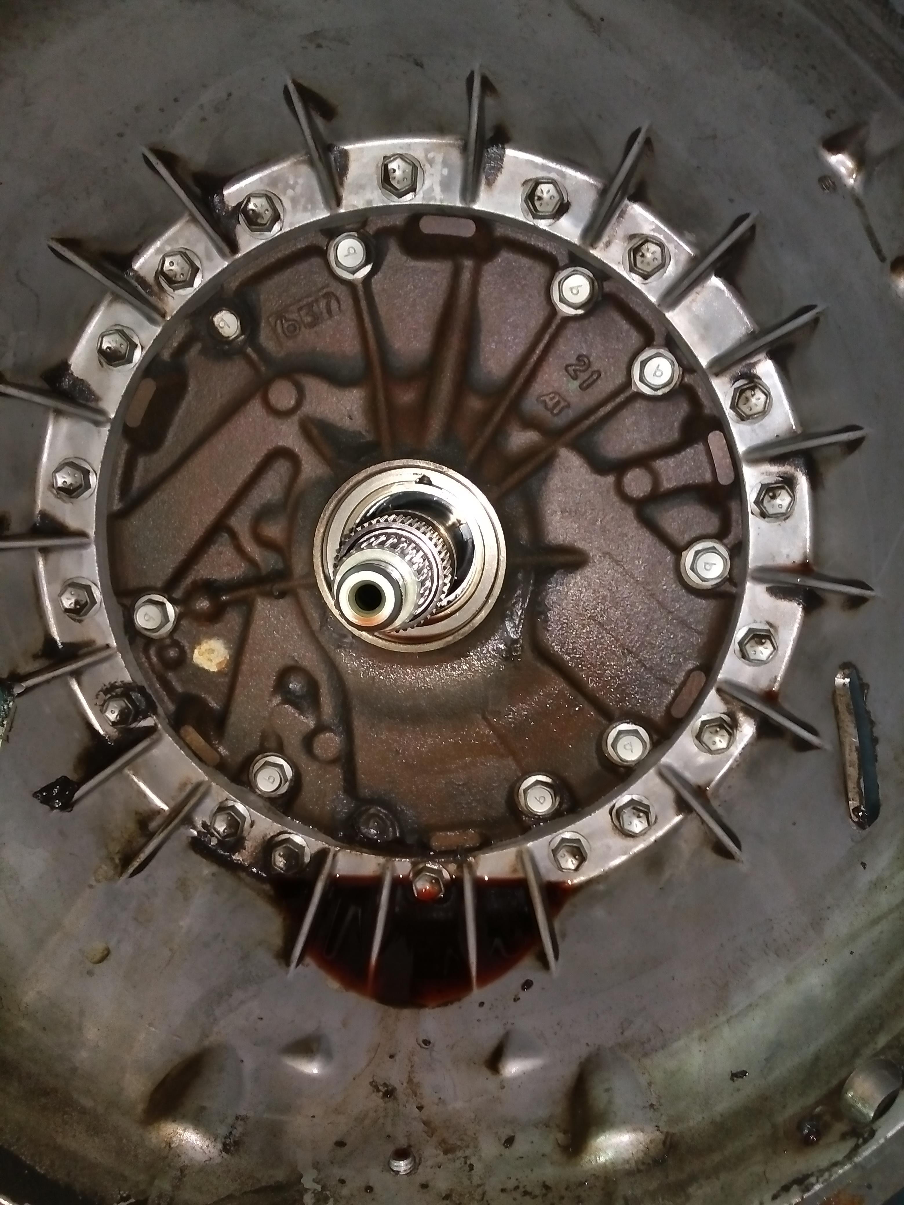

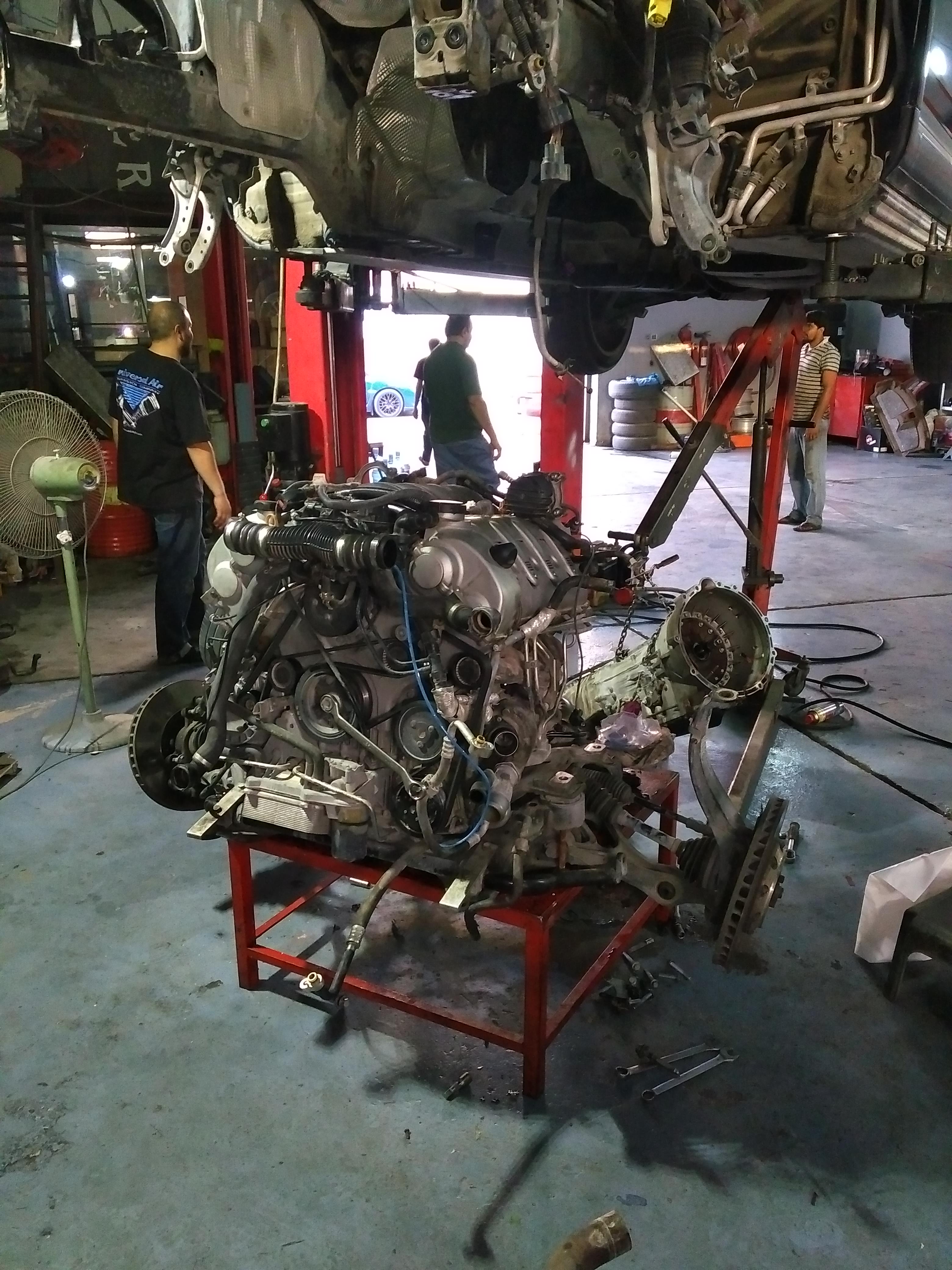

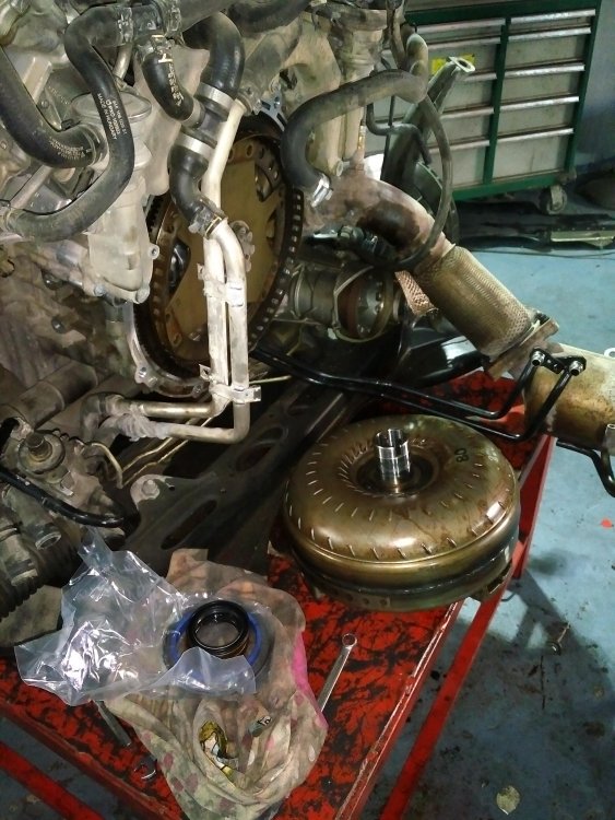

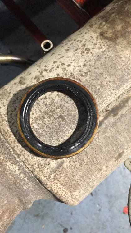

The engine with transmission is out and split. Here is the seal with a very obvious chunk out of it, hence the rather large leak.
They say there is a difference in the seal type dependant on the shaft, I have to say I don't know what to compare it to, so will take the old one to Porsche tomorrow and get the right one.
Edited by lewisweller
Share this post
The seal rides on the t/c hub and has nothing to do with the input shafts. All the 955 v8's use the same size t/c and front pump. So....both the id and od of the seal will be the same across all of the 955 v8's. Interesting that there is a chunk missing. That is probably from the shop prying it out. The correct way to remove is to screw something in the metal ring between the seal lip and the od and then pull. A slide hammer works best. When the pipes let go and the coolant gets past the outer seal lip then. the glycol dries and crystalizes. Then it just sits in there and grinds away at the seal.  Glad to see your fixing the Cayenne. You may just fall in love all over again!

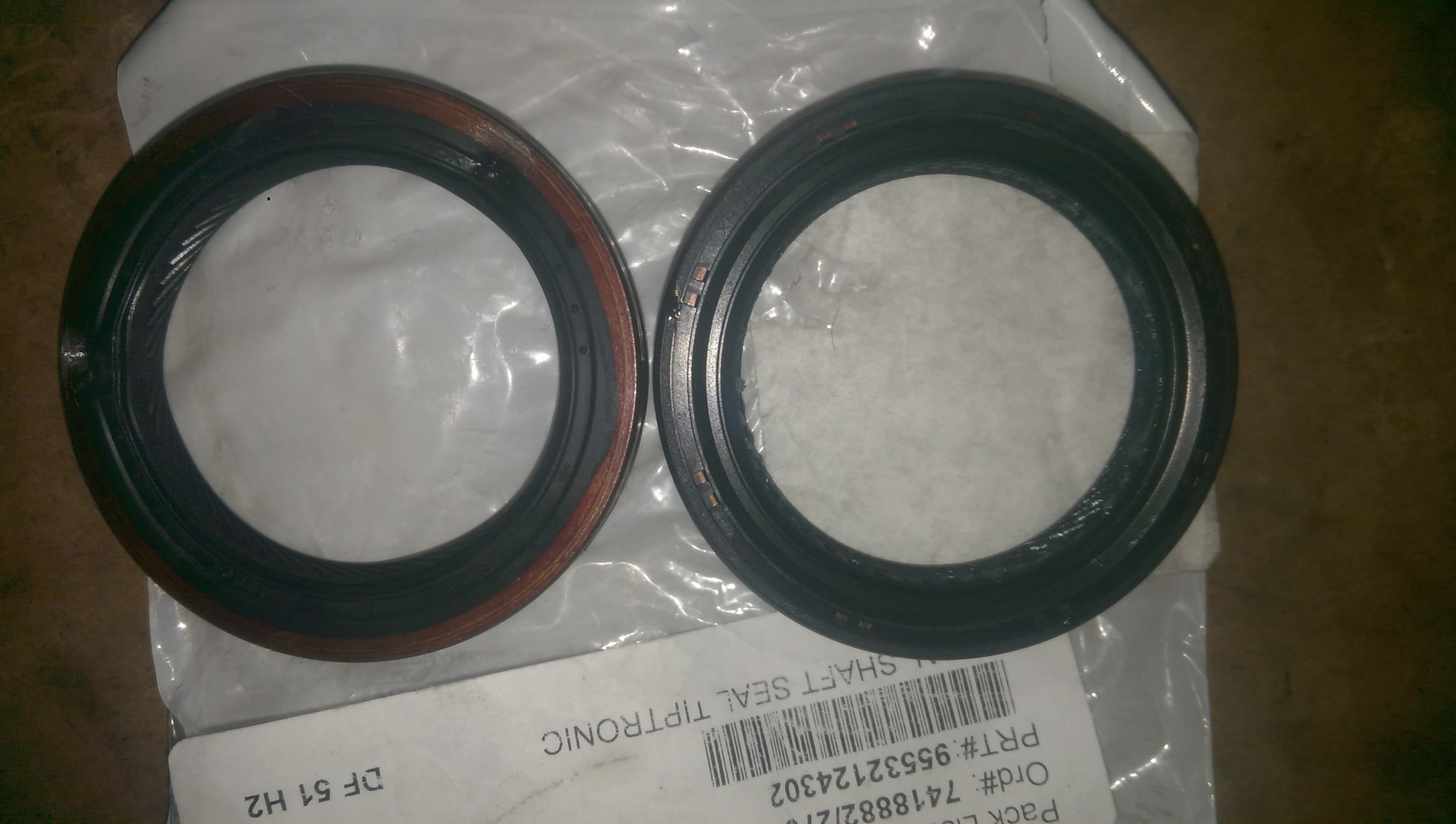

 95532124302 is the correct part for your turbo v8. The v6, v8, and v8 turbo all use the same torque converter with a different stall speed for each.  All three use the same tiptronic transmission with different number of clutch pack plates and frictions based on model with the turbo having the most. The v6 tipronic uses a bushed front pump where the the converter slides in while the s and turbo use a needle bearing.

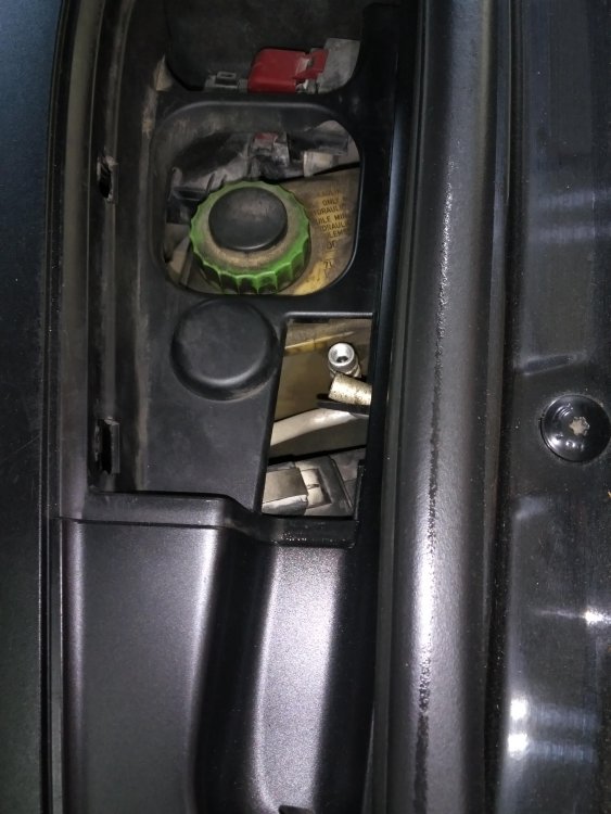

Oh and I still can't fix this pesky check tail light warning. I looked at the third break light and the grounds under that rear hatch spoiler. Nothing found, Cleaned earth's and check plugs were all clicked tight. Where else can be the problem other than the rear comfort control unit? It's really annoying. When the lights are on, Press the break pedal and boom "check tail lights" pops up. It's voltage related I'm sure, when everything is off loads wise, and I've been on a drive (battery is fully topped up) it won't do it. Drop to idle and switch on a few things it will pop everytime. I can even make it do it between fan speed 3 or 4 make the difference to pop the warning or not pop.

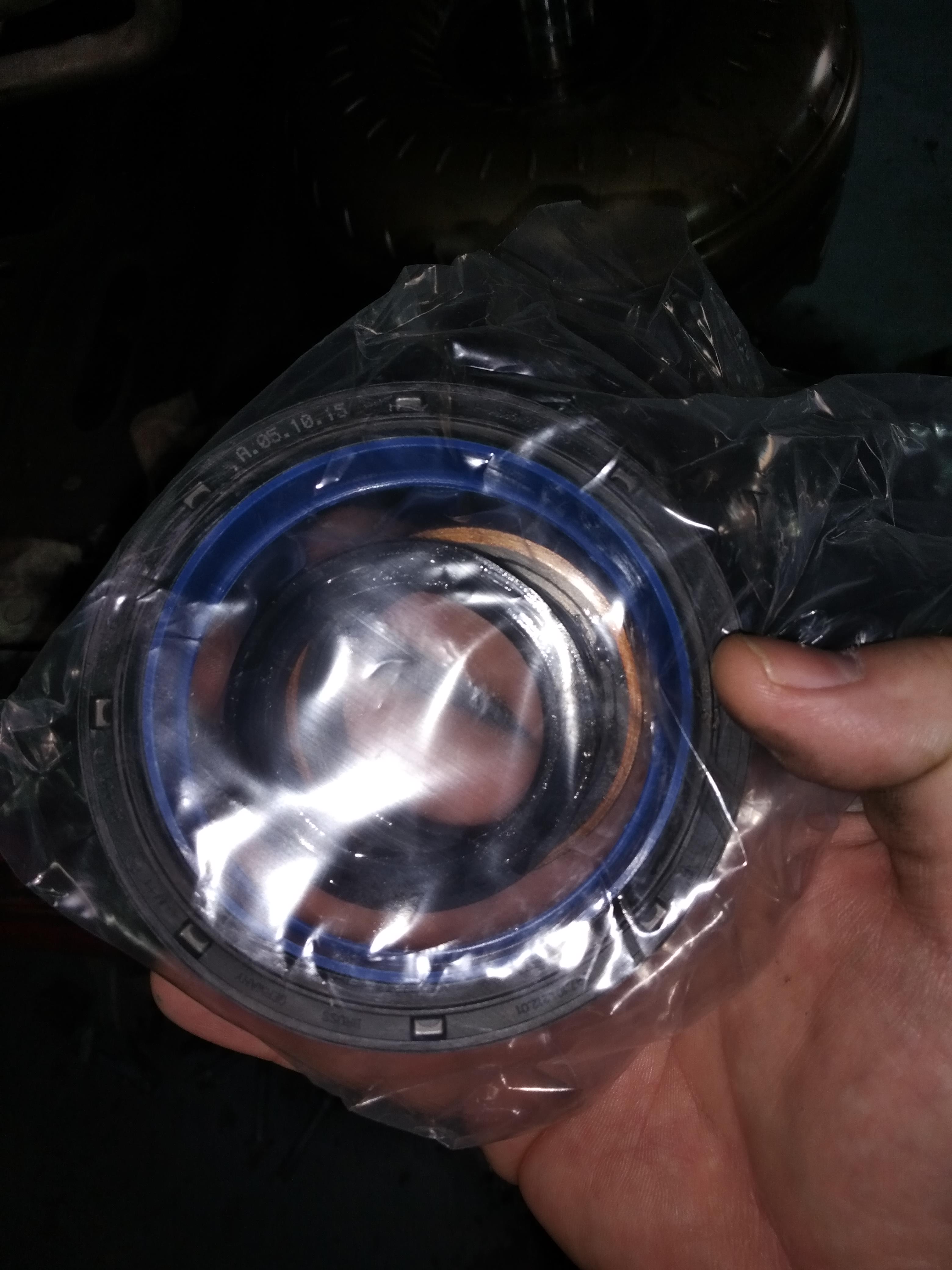

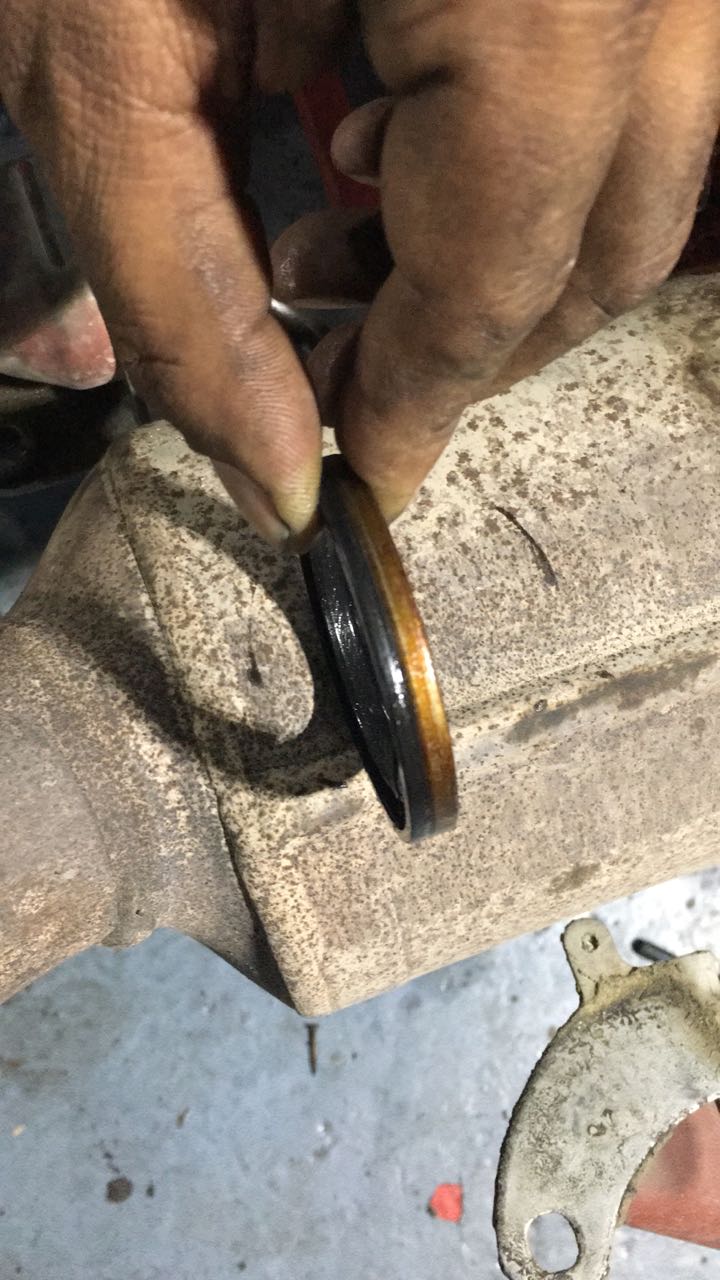

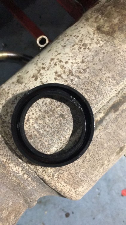

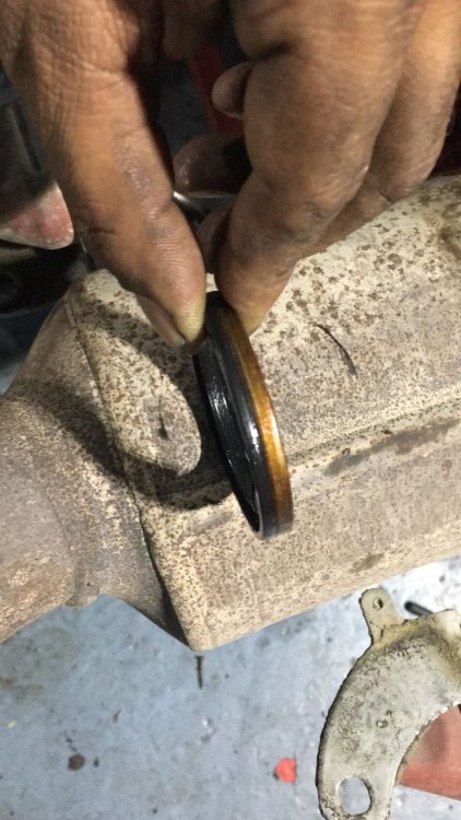

So it turns out Porsche are correct (why doubt them I hear some say) of the the two types one is a usual looking NBR seal and one has a brass band integrated around the seal which sits on the transmission case input shaft aperture I think I'm right in saying. Ending part number 302 "needle bearing version" was in fact the other type Mr. Haney, the one that fits my car is as attached and ends in 300 and is the "bush version"
The garage confirmed the damage to the seal wasnt due to them prying it out! So something happened in there to rip a chunk out and mess up the seal proper style.

I just bought one for my cayenne, im gonna go look at what they sent. Im gonna look at my trans and tc to see what style I have on my 04 turbo. Maybe I got the wrong one! Apologies for the misinformation!
Share this post

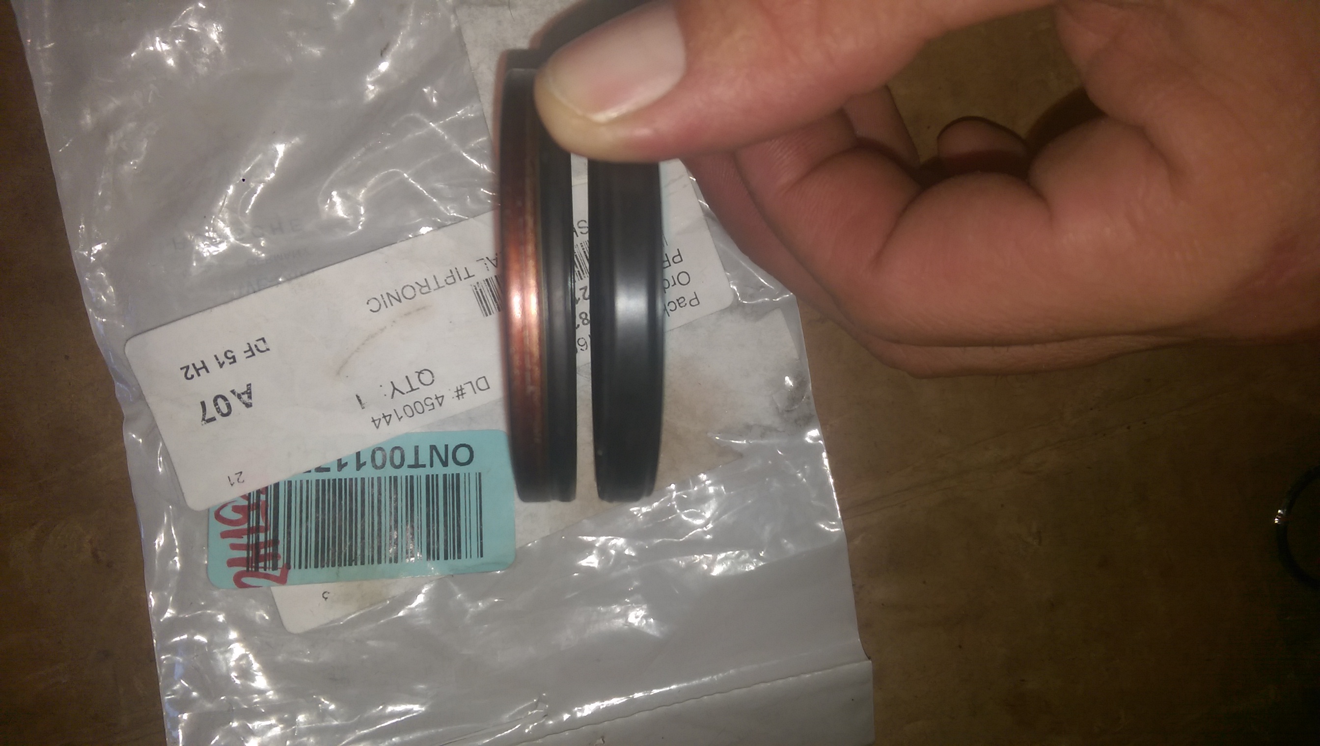

Well, My 04 turbo was manufactured in 3/04. I do have the needle bearing front pump. I picked up my Cayenne 1 owner with 65k. As far as I know from the service history and working on it the trans has never been replaced. It was always serviced where it was purchased by the original owner. I include a couple of pics here of the new seal sent to me ending in 4302. It has the same id, od, and direction of rotation as the original one I took out. For all purposes it is the same seal with the adittion of a full rubber casing compared to the originals brassy colored outer metal shell. Though, on the new one ending in 4302 you can see the brassy colored casing through the holes in the rubber. Maybe 4302 is just vthe latest revision to the part ending in 4300. But I do see the mention of a bushing and needle bearing versiion in the parts listing.

Yep brass outer seal ring is for BUSH version like I have and you have. Ending 300.
The other needle shaft version type seal ending 302 is NOT a revision old or new I did ask the Porsche part guy to clarify, they are simply different parts for different types fitted component. I reckon the 302 was fitted in the later module production line when they realised the 300 was going to leak in the future maybe?

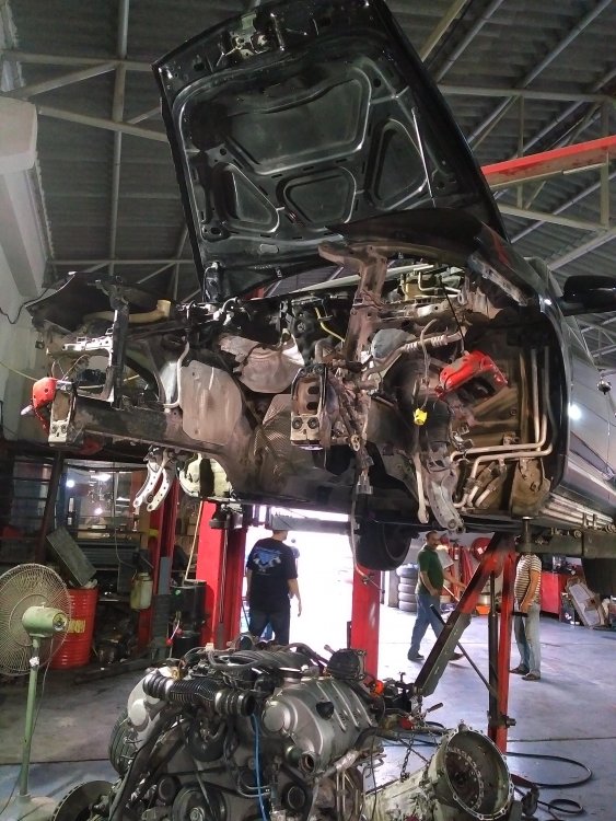

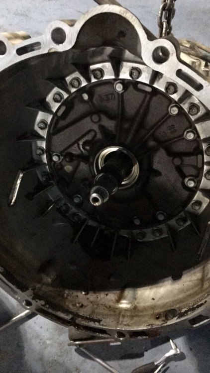

Some more pictures attached, this is the 302 seal and also some rather depressing images of my cars guts laying on the floor again.
