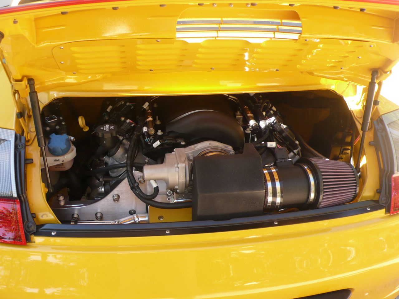

First of all the 996 weight depends on it's accessories so its total weight is a moving target.  However I don't know what all this leads up to if you want the extra horse power and a simple engine that produces a lot of grunt.  I installed a LS3 480 HP, some GM specs says it's 495 HP, I won't argue that point...

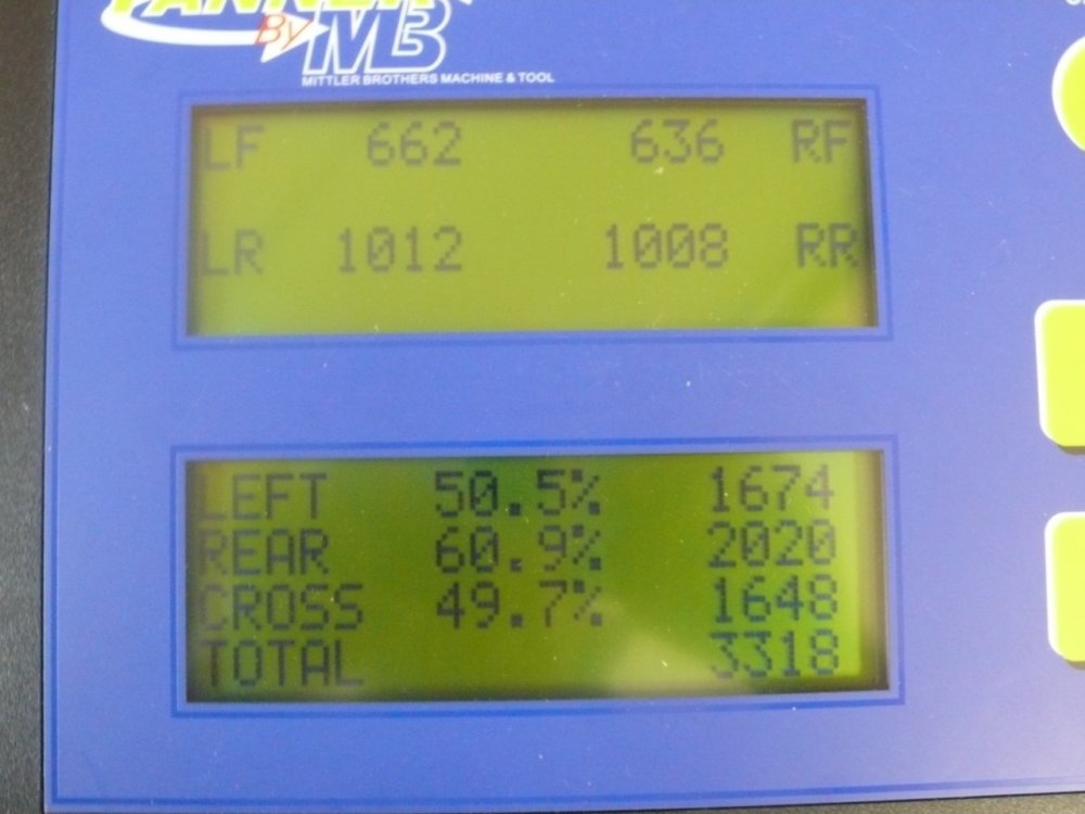

I put the car on aircraft scales and I'm 160 lb. lighter, however that is with the removal of the front diff.  Also all the accessories are attached on the bottom of the engine, not on top, lower CG.  The installation uses an electric water pump so no mechanical water pump.  I can tell you it's no quick substitute for replacing the IMS bearing, clutch, etc.  Making the Porsche and GM computers talk to one another was the biggest challenge.  It's not for the shade tree mechanic...  Now there's a lot of these conversions that throw used parts at the project, never deal with the blinking lights on the dash and only want to go 0-60 with their hair on fire, but to do it factory takes a lot of time and money.
I don't think debating about a few pounds either way is really the question, it's time, money, performance, engine longevity, something different that is breath taking to drive.  I took my car into the local Porsche dealership to put it on their OBD machine.  When the guy drove the car into the mechanics stall the entire shop stopped working, took pictures, got under the car and were all in awe of the installation.  Fortunately I didn't have to pay for the down time...

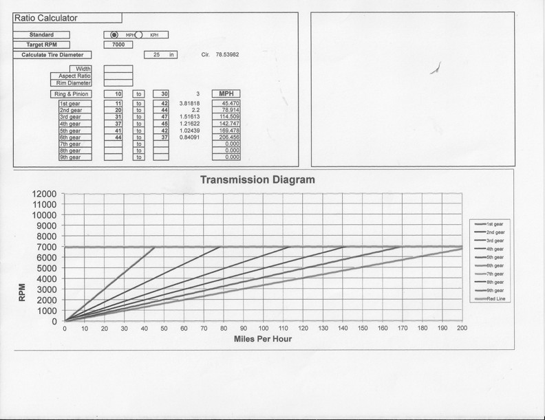

I removed the front differential in favor of putting a taller ring and pinion in the car.  At redline in 6th gear it pencils out at 206 MPH, not with me in it...  At 80 MPH it's turning 2750 RPM, it's a lot quieter that the Porsche engine that is turning more RPM's.  Bottom line, it's simple horse power and when you lift the deck lid you can see a real engine, not an air cleaner.  Sorry in advance if I offended anyone...

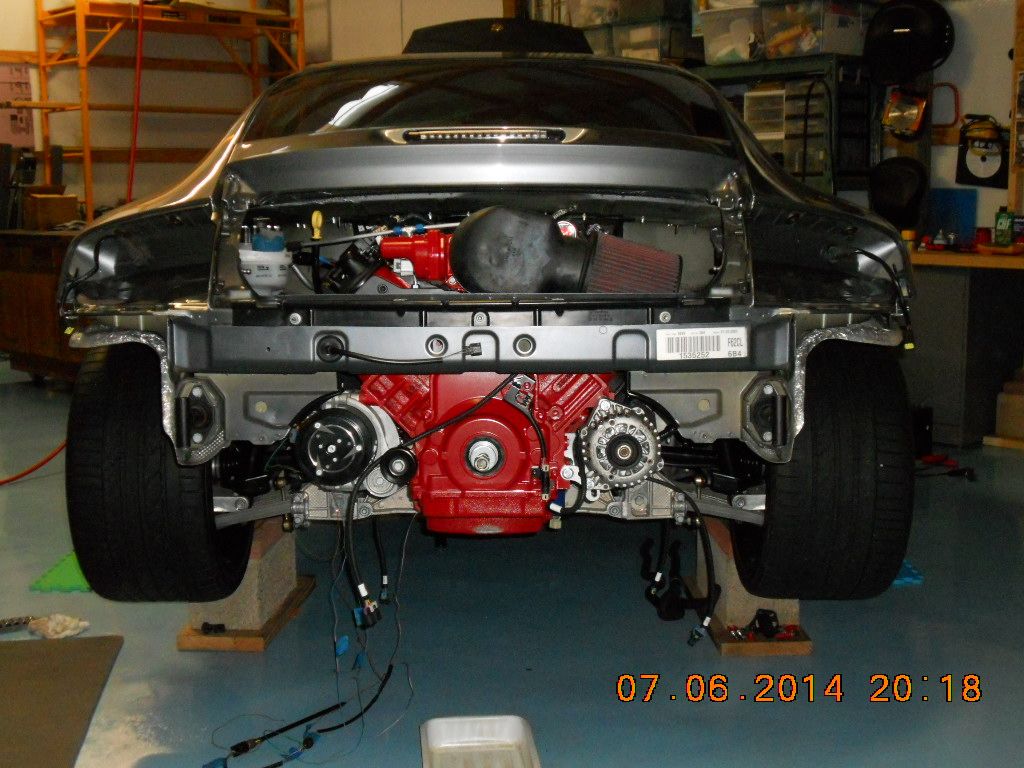

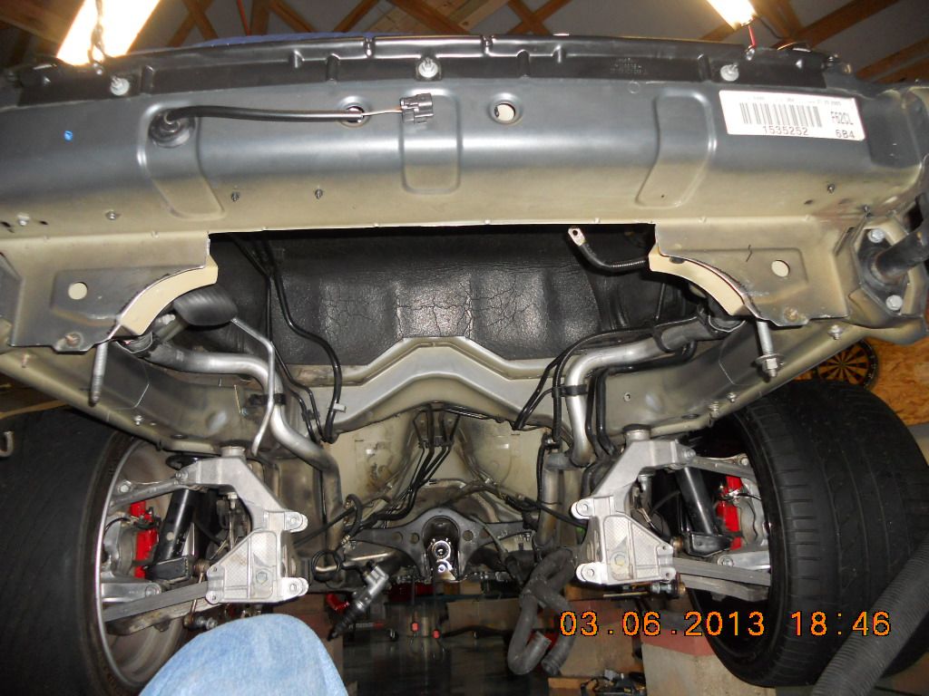

Also A large part of the rear chassis has been removed, along with the rear crash substructure. That's a fairly decent weight savings right there. It is difficult to find what else has been discarded.
It seems that the Renegade build (and all others, from what i can see), requires substantial removal of metal from the rear of the chassis, and the rear crash structure. Couple that with removing the front diff, front halfshafts, front CV joints, and the front driveshaft (and all mounting hardware), and it seems logical that one could find a net weight loss of 160 pounds when transitioning from a C4 to a C2.

Std 996 rear structure:
LS mod'd rear structure:

Buford, after your reply I needed to go to the garage and make sure the back end of the car hadn't fallen off.  You're a purist and that's ok, you've exaggerated some of the install alterations.  I installed 4130 tubing mostly just to finish off the sheet metal.  I believe Porsche has pushed the flat 6 about as far as it can go.  It's a very complicated engine to get the HP.  The clutch, spark plugs, water pump are only good for 60,000 miles, and the list goes on. The V8 makes it breath taking to drive and It's a great road car, but still a grocery getter if that's your choice.
