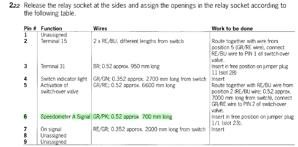

Yes but I doubt that will do you any good it is just one (of many) that go into the instrument cluster. And as I said the trigger speed is programmed into the cluster.
The wire connects at B13 connector pin and is labeled "Speedometer A". The wire is Gray/Pink.

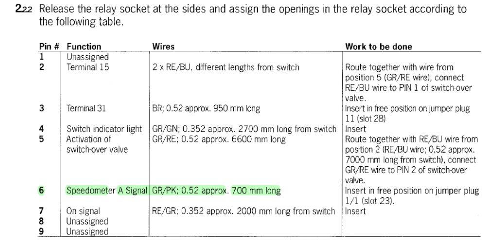

The genuine PSE uses a relay connected to the grey/pink speed wire on the jumper plug on Loren's image. I don't see why you couldn't fit the PSE relay, and wire it up to your system. I don't think you would be able to adjust the cutout speed range though.
