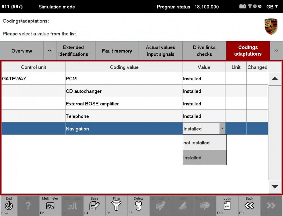

Coding is where settings are made in the control units to tell the car which options are installed. Very occasionally, perhaps after a battery disconnect/change, a unit can lose its settings.  The screenshot below is from the Gateway coding page for a car with PCM3, but the principle is the same for PCM2.1.
