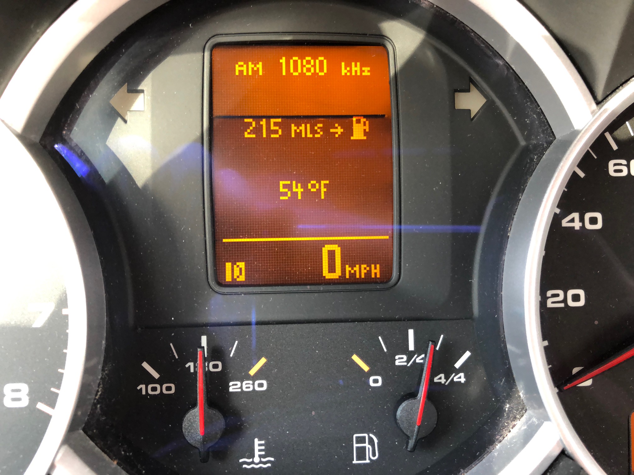

I hadn't noticed the tach issue at all but I did notice a display oddity in that the gear indicator was all mucked up.  See the attached picture, lower left of the LED display.  It stayed there no matter if it was in park, reverse or any forward gear no matter speed either.  Nothing changed it, sport mode, not, etc.  On a cold restart the problem was gone.
