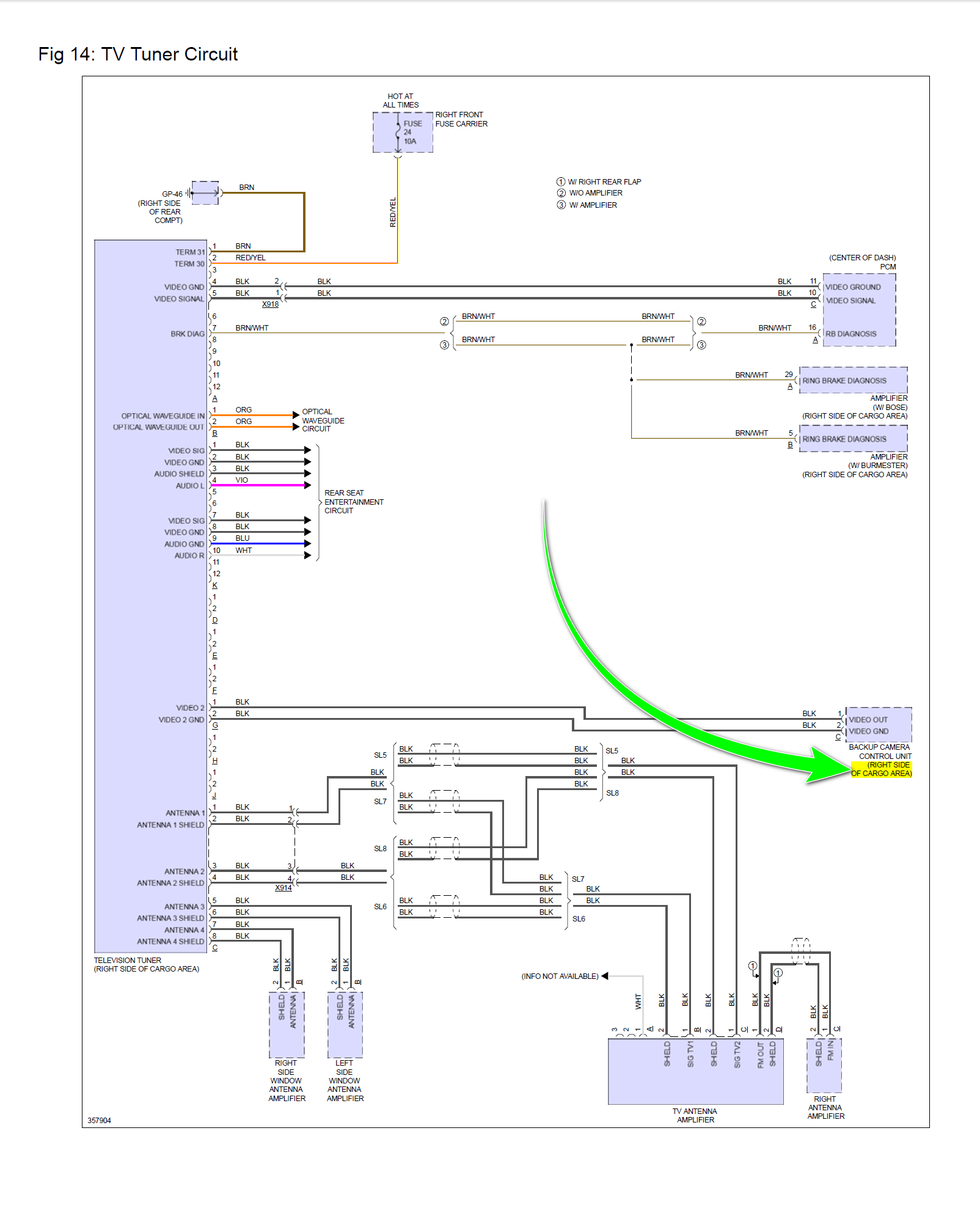

Having trouble with my reversing camera, it keeps flickering, seems like a signal fault. Removed the inner lining of the tailgate and removed the camera. All the connectors and camera seem fine. There is supposed to be reversing camera control module somewhere, anyone know where it is? I would like to check the connectors there aswell. If anyone has experienced similar problem please let me know what to check.
