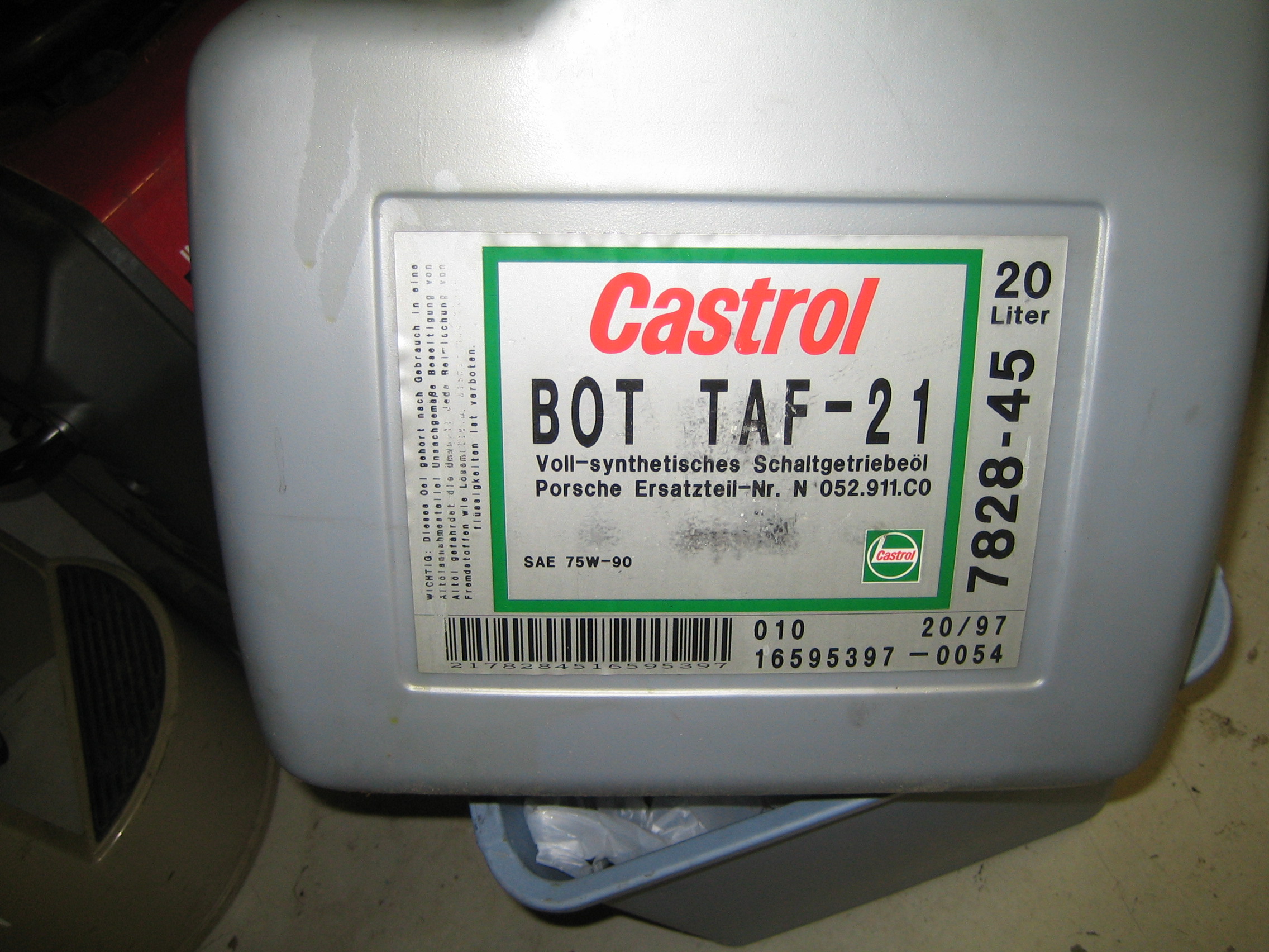

FWIW I have done the change before with the regular mobile 1 off the shelf from the local auto store. It is extremely hard to shift while cold.
I then went to the auto gallery and they are the ones who sold me the castrol which makes it shift like butter all the way around. However recently after about 15k it seems like the fluid has broken down or something, and the syncros are not being engaged as easily- i.e. maybe too slippery, but dunno.
I think I am therefore going to go back and get the oem part numbered fluid and go from there. BTW the castrol pictured that they sold me was what they gave me when I asked for gt3 tranny fluid. I asked for this because I have a limited slip. After talking with Jeff at sunset the gt3 and 996's run the same part number fluid FWIW. Loren also my tranny for whatever reason maybe becasue of the limited slip seems to use more fluid than a normal 996 and about the same as a gt3 maybe? I thought the increase in gt3 fluid was due to the tranny cooler though. In any event, back to stock stuff for me. Hopefully nothing bad has occured from the castrol. :)
