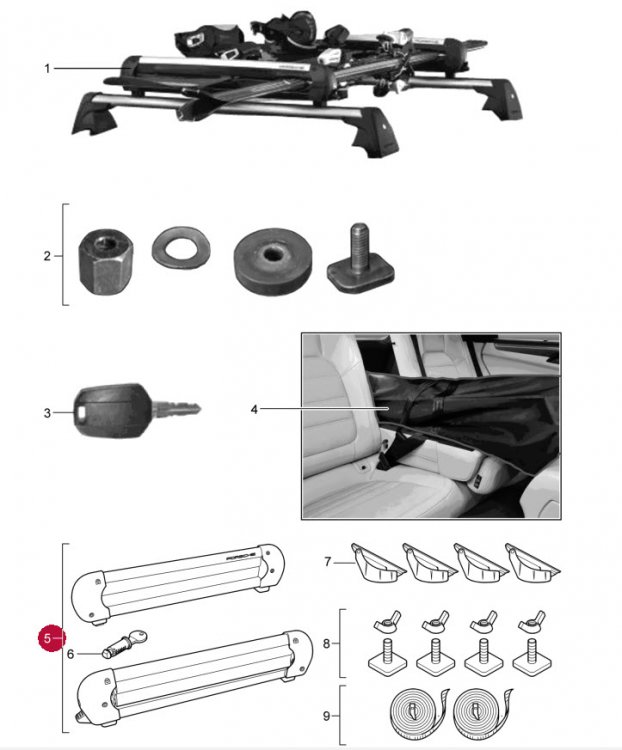

do me a huge favor after you get this fastened, make sure the ski tips are at the back, might save you...
Thanks, Loren. That’s correct, I have item number 5. The plates look the same however mine only have one bolt, as the other is in the ski carrier itself.
I managed to get hold of the manual, it is for the Cayenne but it’s the same part. There are only a few pictures and no mention on how to tighten the internal plate, in fact it only says to tighten the external one. I have taken a couple pictures of the bolts:
