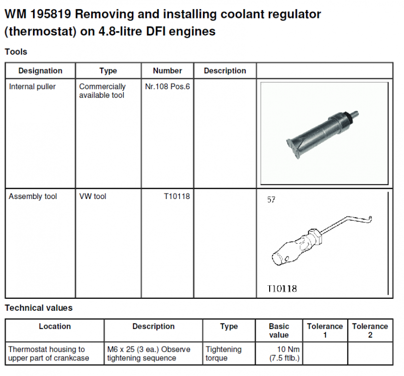

Ho Loren.
I'm talking about this step...
Quote
2.2. Tie a knot in the wire or electric cable to prevent it from being pulled out.
2.3. Insert an assembly lever or a large screwdriver through the cable. -- Secured electric cable
2.4. Pull the thermostat insert out of the crankcase completely using an inserted assembly lever or a large screwdriver. Support the assembly lever under the vibration balancer if necessary. -- Secured electric cable Figure shows removed thermostat insert -- Removed coolant regulator.
There's no indication as to how much force is required to extricate the thermostat from the housing. It should just be held in by the gaskets at this point so I would think it would come out w/o too much effort - maybe 10-20 lbs of pull. Guess I'll pull harder.
ETA: The answer is to indeed pull harder. Takes quite a bit to get it removed.
