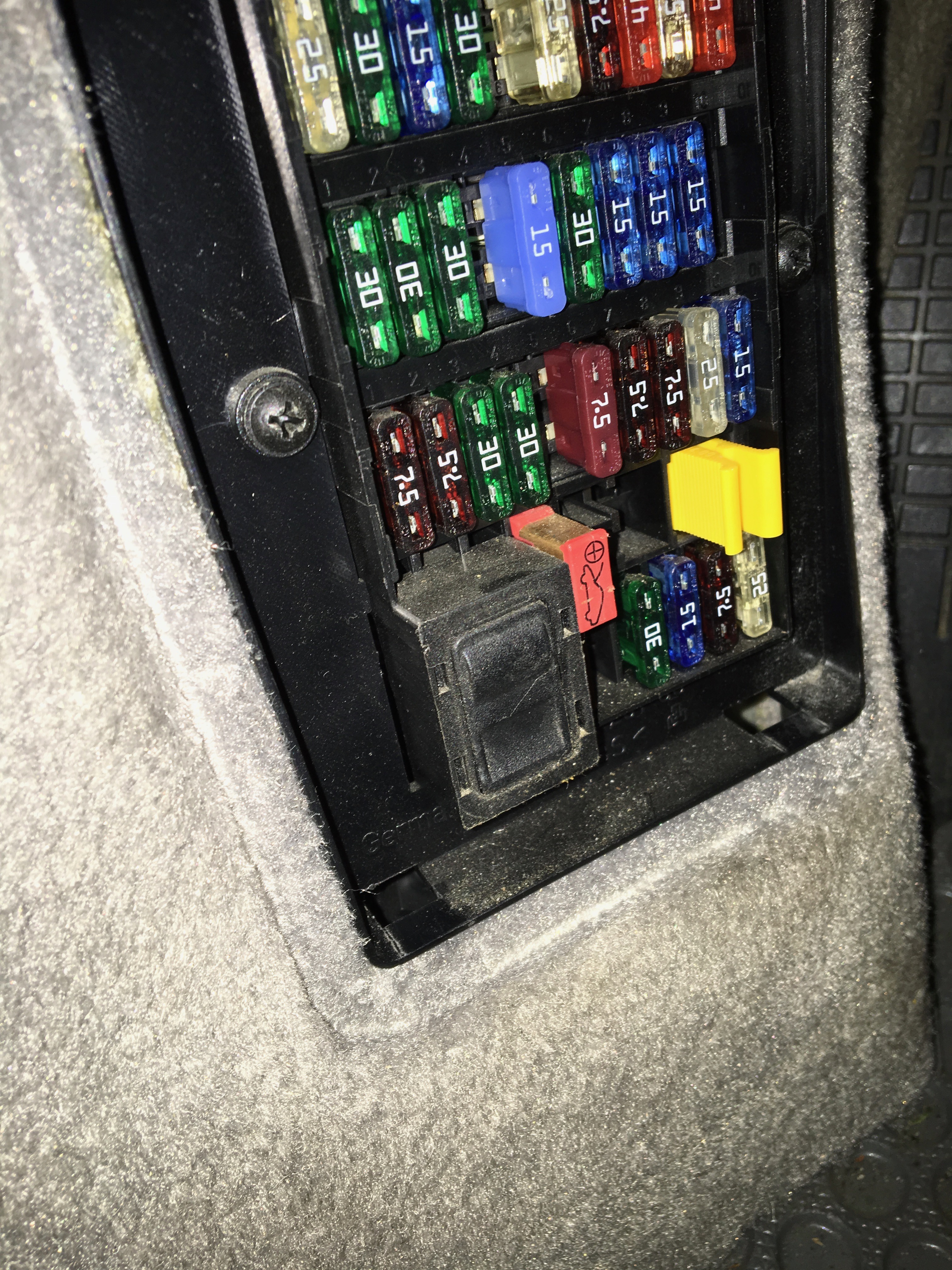

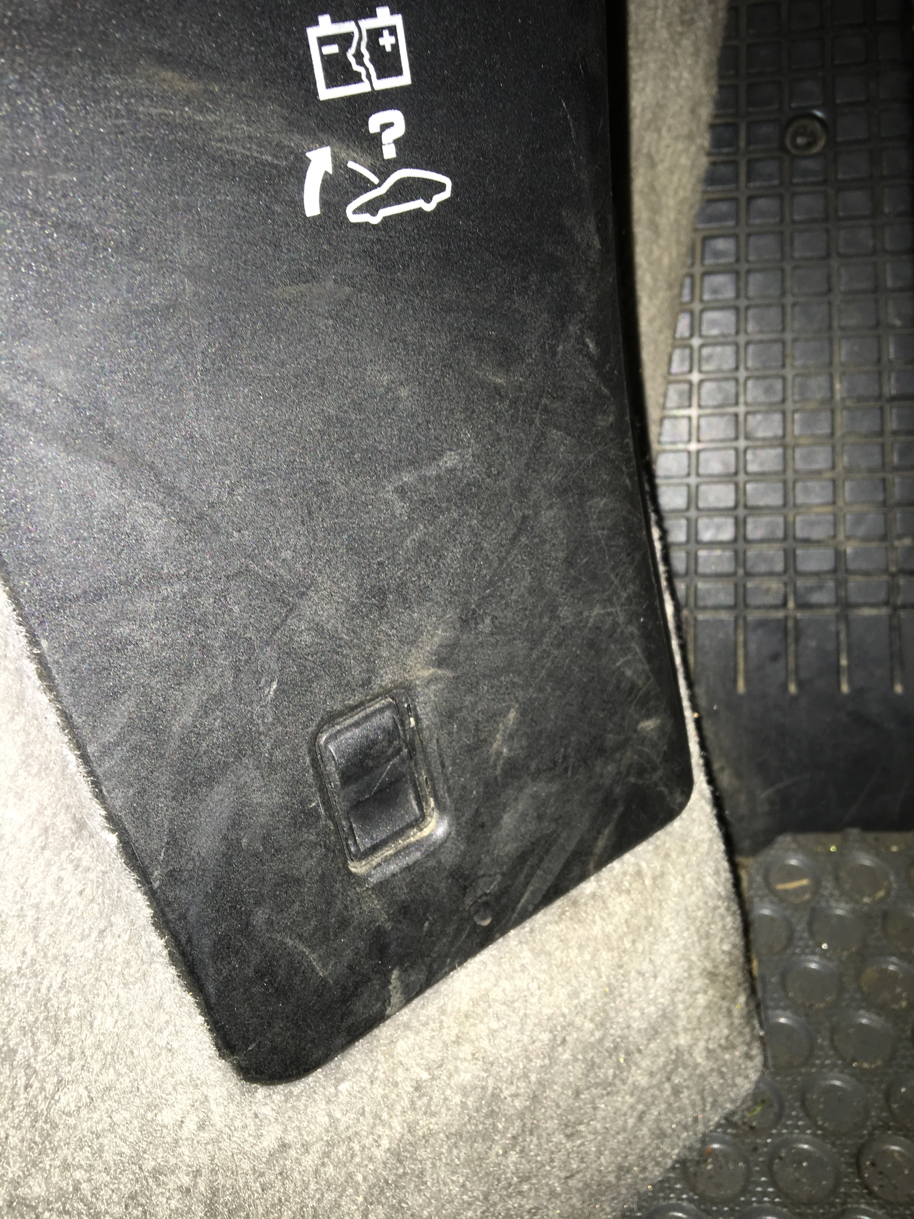

hi,   new to me 1999  euro spec 996 .  runs and drives fine.   yesterday friend of mine drove it.   came back with spoiler in the up position and locked there .  nothing in the owners manual that talks about this.   I have driven it very fast quite often and never noticed it either up or down and have no new warning lights on dash.   some sources say there is a manual switch somewhere  in the foot well but I can't find it...  anyone know what I'm  talking about or where it is so I can put this thing down ?  ... or is it suddenly broken ?     I thought I read somewhere that it was airconditioner related  but I can now find no such reference.  any suggestions ?
will do and report back.   thx.
turns out the answer was right there in your drawing...  the switch is right there where you clearly marked it.... I had the fuse cover off because the hore went off full time the other day and I had to pull the fuse  ( orings near air bag im told )   and I never put the cover back so he must have hit it w/ his foot when he got in.  I   activated it  to go down and down it went like magic.    another satisfied customer and thank you.

ps:  the switch actually comes through the fuse box cover, unless it was optioned to one of the blanks up on the horseshoe around the radio/ac.
