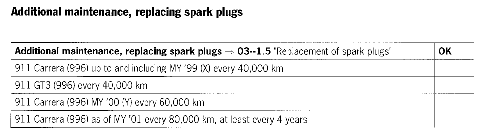

If I understand you correctly:
a) I should change my plugs every 60,000 km:
b) I should use Beru plugs FRG-6-KQU  (FGR-6-KQE are Bosch)
c) Am I correct to assume Porsche updated the MK1 maintenance schedule since 1998?
Thanks

Interesting. I'm glad I saw this. I was under the impression that they should be chanced every 60k miles on my MY2000 C2.  Just curious, why would there be different schedules for different years?
Be aware the unit is km not miles. 60,000 km = 40k miles.
