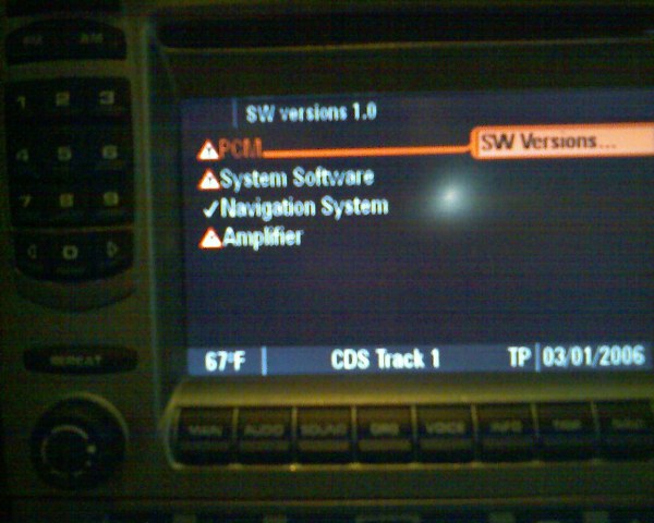

Part eleventeen of this epic saga:
I casually mentioned the TSBs related to upgrading software on the PCM2.1 units (1/04 9110 and 12/05 9110) and I believe I have officially received the "whachutalkin'bout Willis?" look from the service guys.
My unit is currently on SWVer 1.0 (04035AD1) and needs to be brought to Mod A so it can be brought to Mod B so I can get this new DVD to work, so the TSB story goes.
When you're getting the blank looks back from the dealer (aforementioned whachutalkin'bout Willis), what does one do? These update CDs appear to be provided to Porsche "free" per the TSB. Is it possible I could "locate" one and simply follow the directions myself for the update?
Any help is appreciated.
ps thanks for your infinite patience Loren!
I'm thinking the big red exclamation points are not a good thing...
I just updated my PCM/NAV to 2.1B tonight and got the exclamation points as well.
So far, I have not been able to play an MP3 CD, nor have I found the new NAV functions (browse by ZIP code, etc.)
